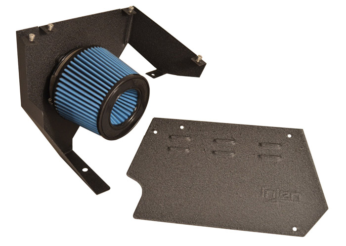

1/25/17: modified E90 roof rack to fit E46 and installed. Installed Injen Intake.
1/28/17: Dinan stage 2 software calibrated for intake installed. (204HP 197Tq)
