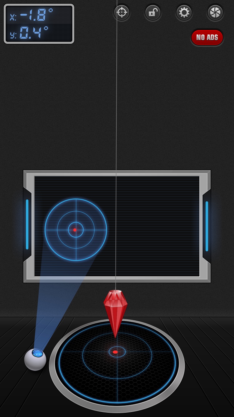

Gave my front extra negative camber today while changing a less aggressive OEM toe in.
Attachment 25028
Attachment 25029
Attachment 25030
