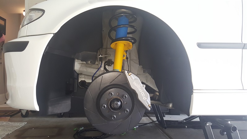

Got the Bilstein B8's installed in the front today. Amazing that the factory struts that came off were still in good shape at 205,000 miles. They still had decent damping by hand but it was definitely time, the bump rubbers were destroyed.
Attachment 36142
