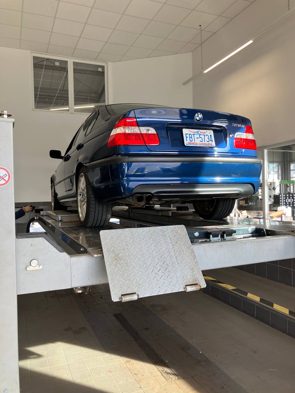

She passed TÜV today. Noticed the diff is starting to leak only 3 years after sealing it, maybe it's time for a LSD?
