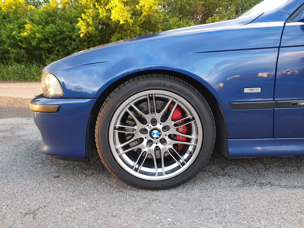

Update. Starting with feedback on the new brake pads. When doing highspeed driving on the Autobahn having good brakes along with good tires is undoubtedly number 1 priority.
These pads are just what the doctor ordered, they are not noisy and the stopping power is phenomenal. It really gives confidence to push the car knowing the brakes grab so good. Big, big thumbs up for this BBK.
The only downside is that they dust like there's no tomorrow but I'd rather take that and have good brakes over noisy and fast wearing pads that dust less.

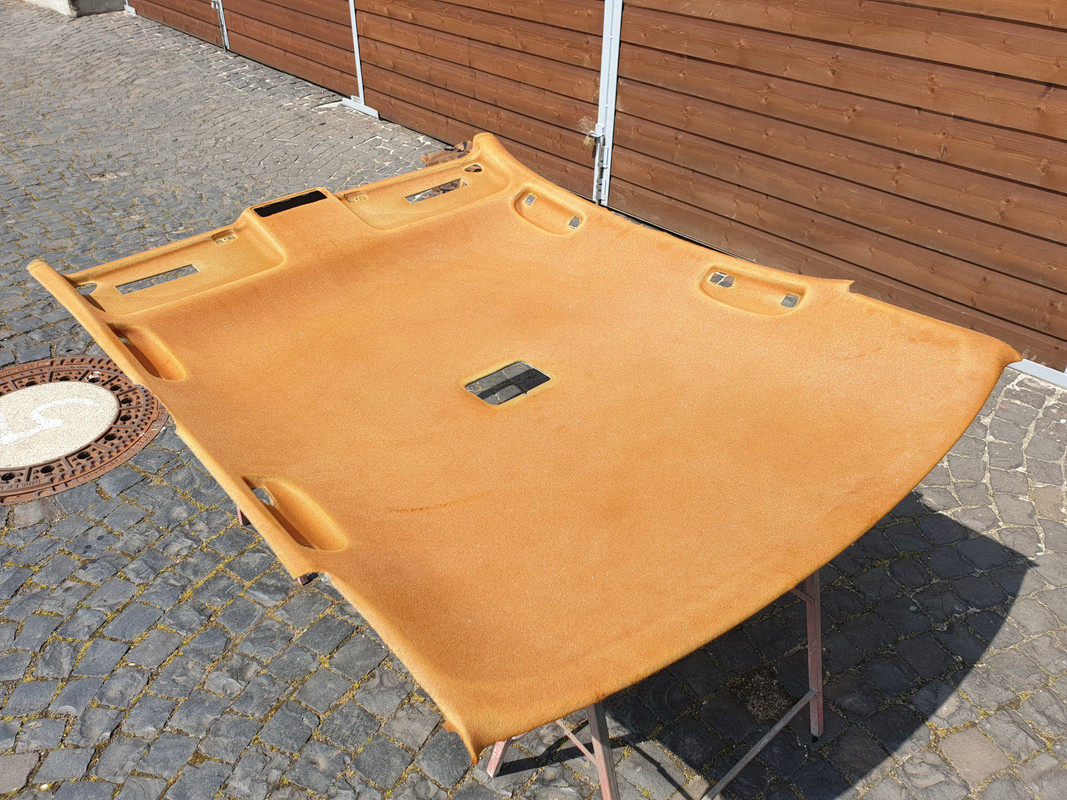

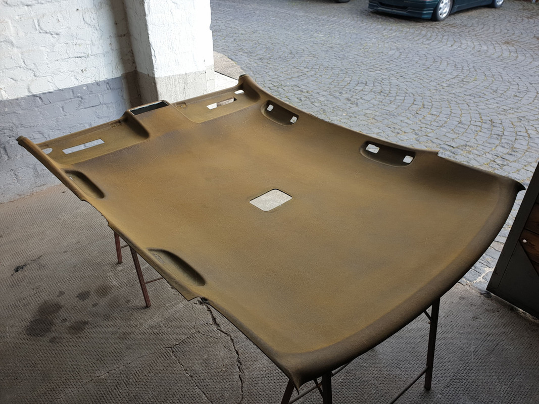

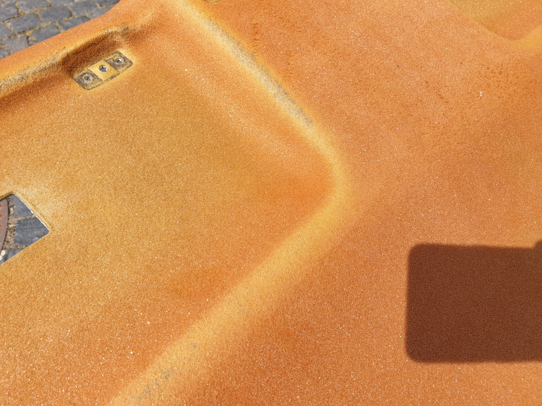

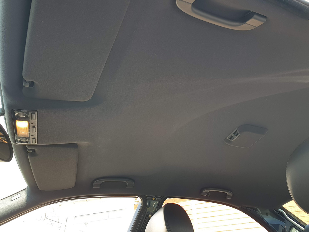

I wrapped up a project that I knew was coming sooner or later - my slicktop headliner was starting to sag.
Picture taken in June of last year.
https://i.postimg.cc/qRw8XLKk/20180726-081802.jpg

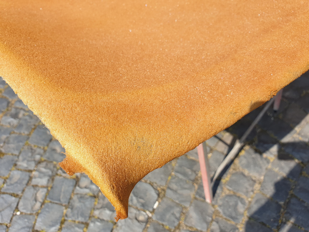

It just kept getting worse.
https://i.postimg.cc/8cFjJBBX/20190501-132831.jpg

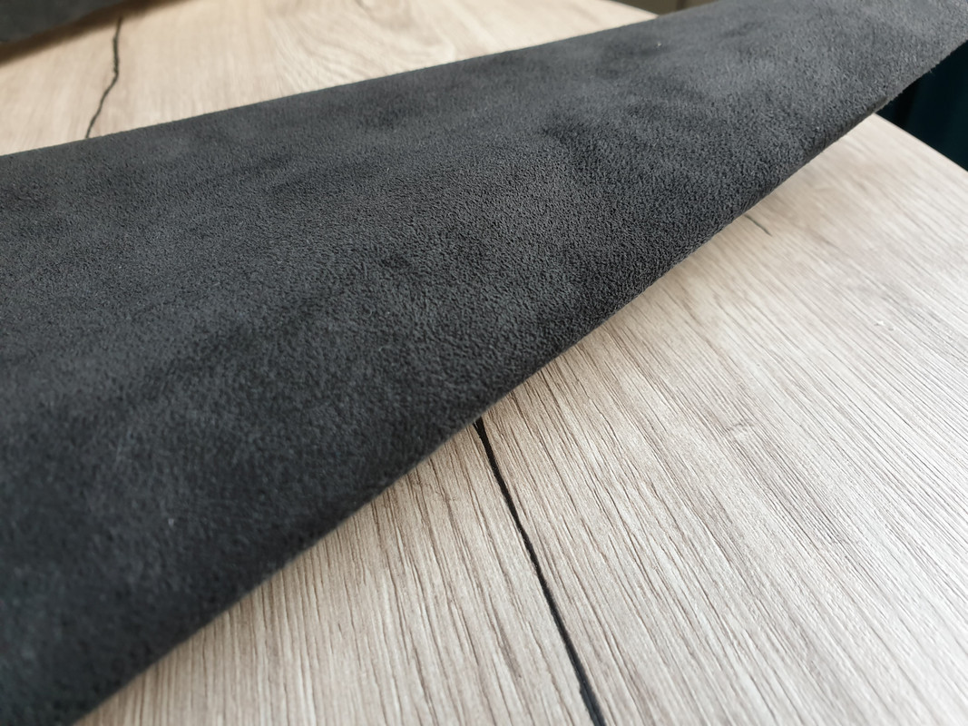

So perfect time to step up to Alcantara and make the interior even more pleasant to be in.

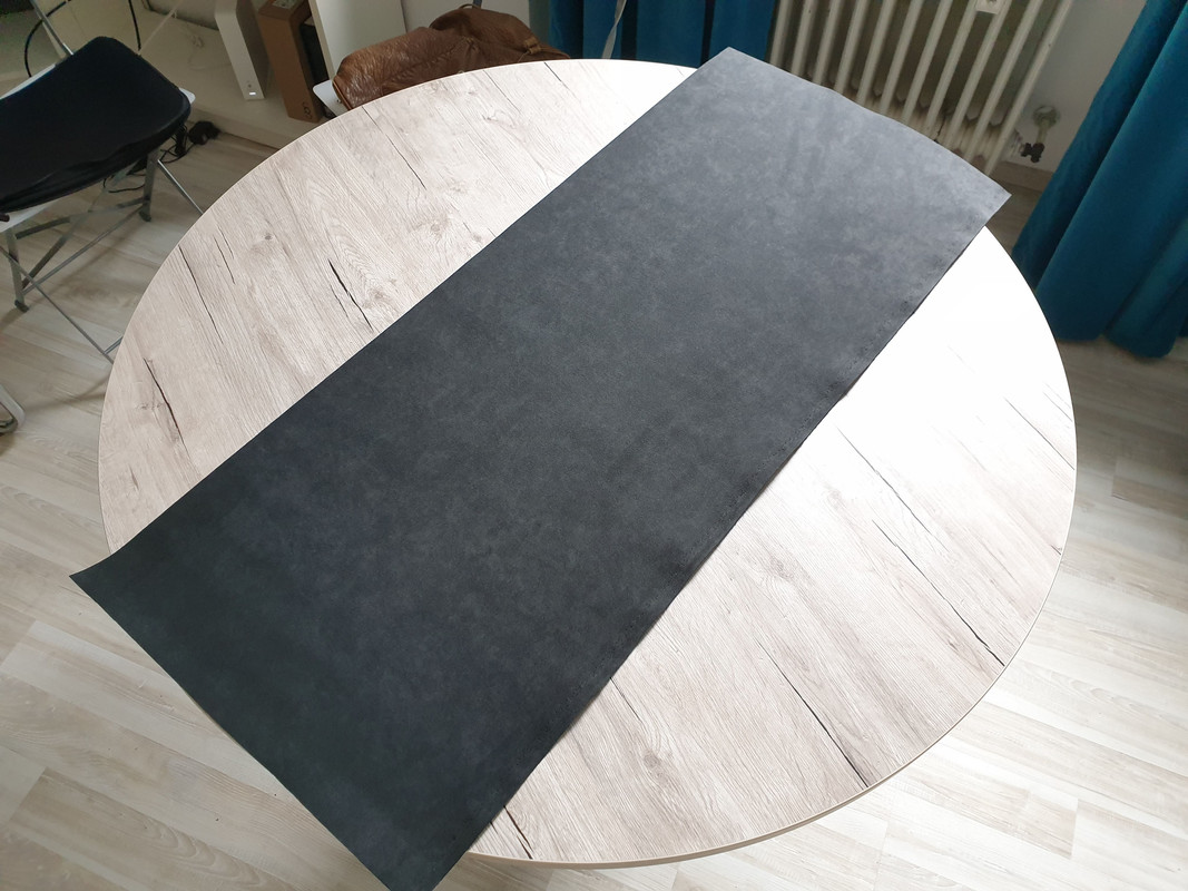

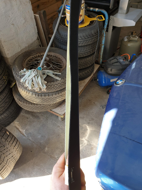

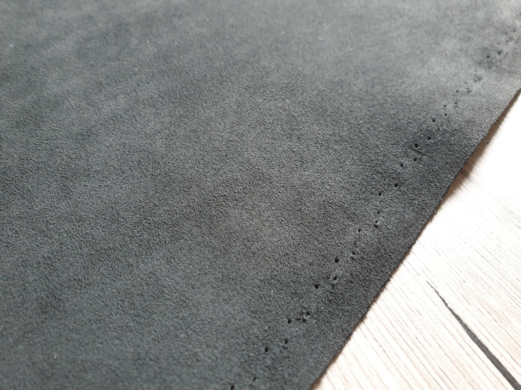

I bought a big roll of original black Alcantara with 1 mm foam backing. Superb quality stuff.

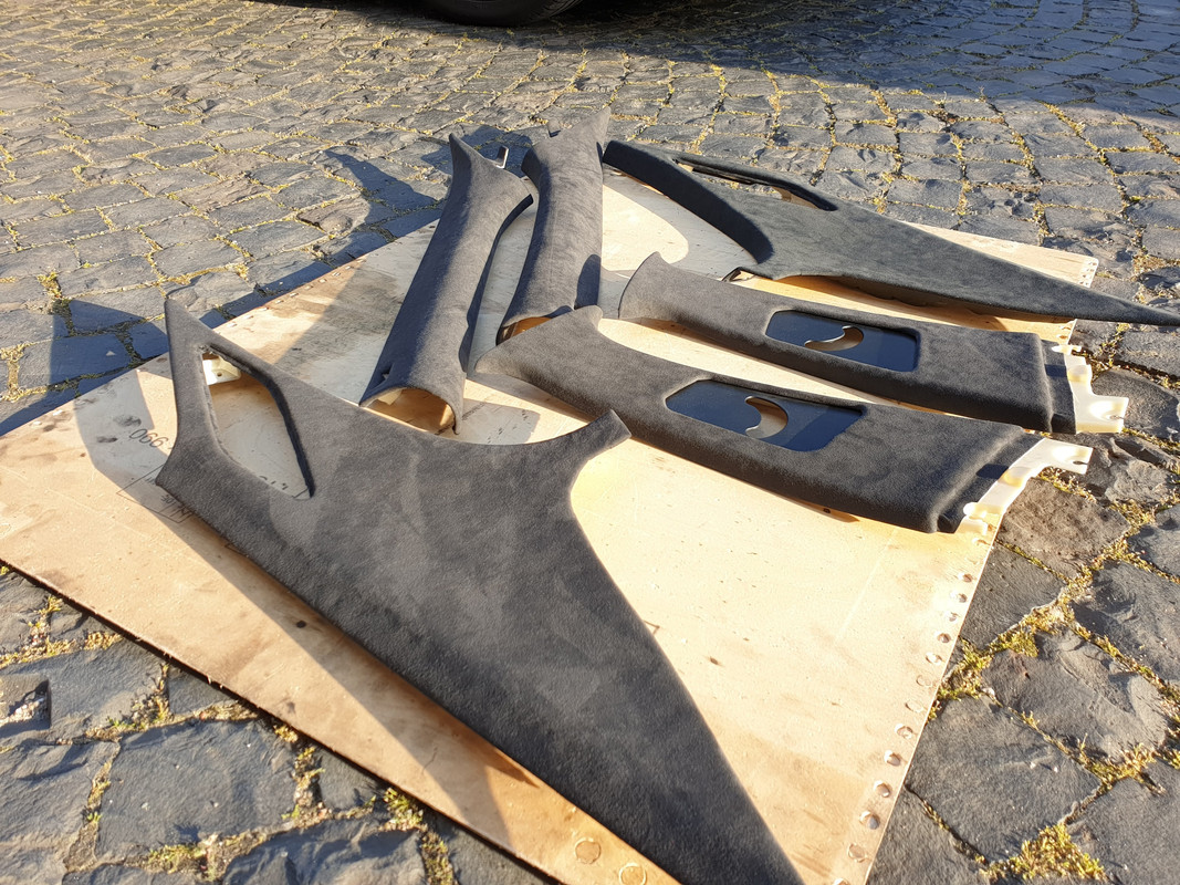

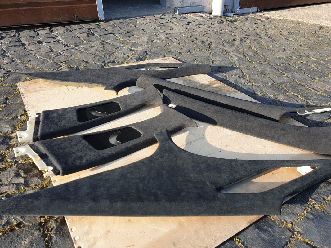

Redoing pillars was very therapeutic and going along nicely.

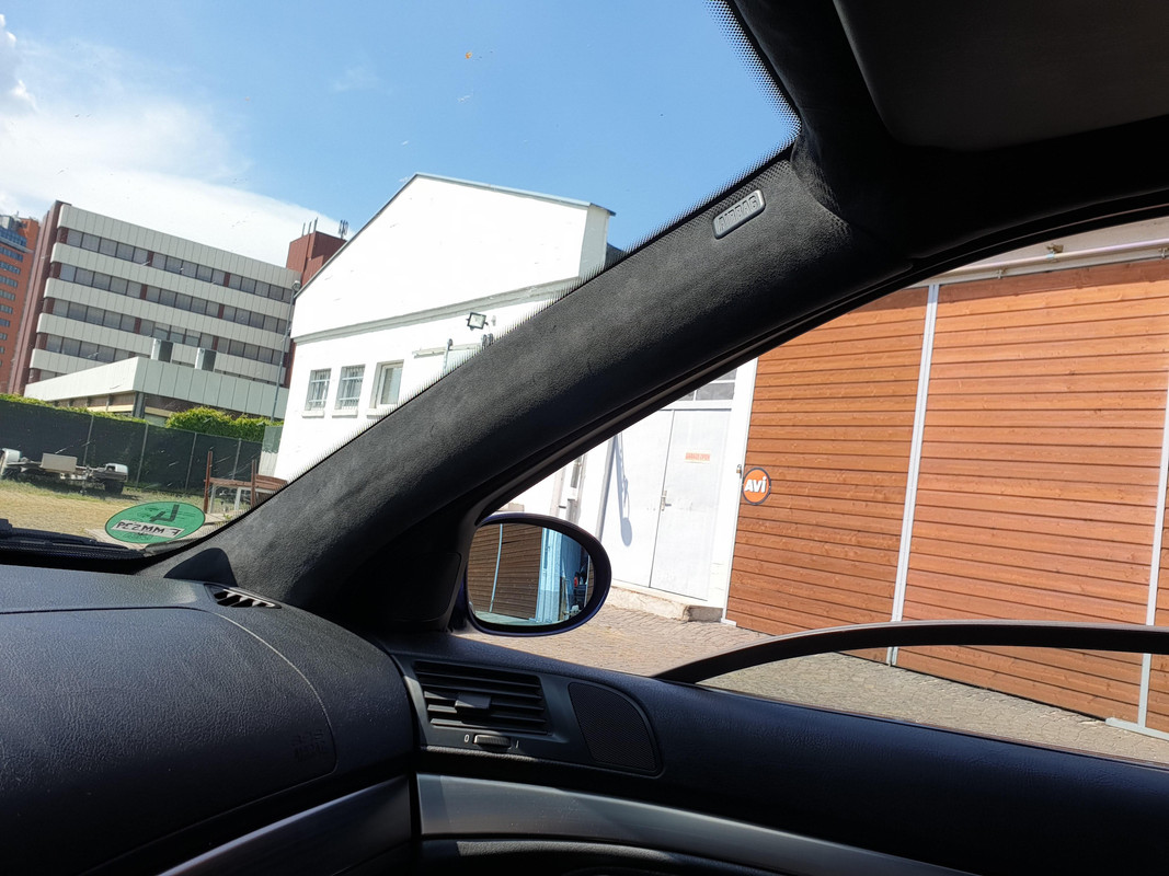

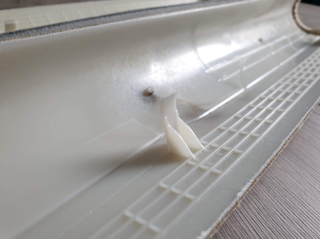

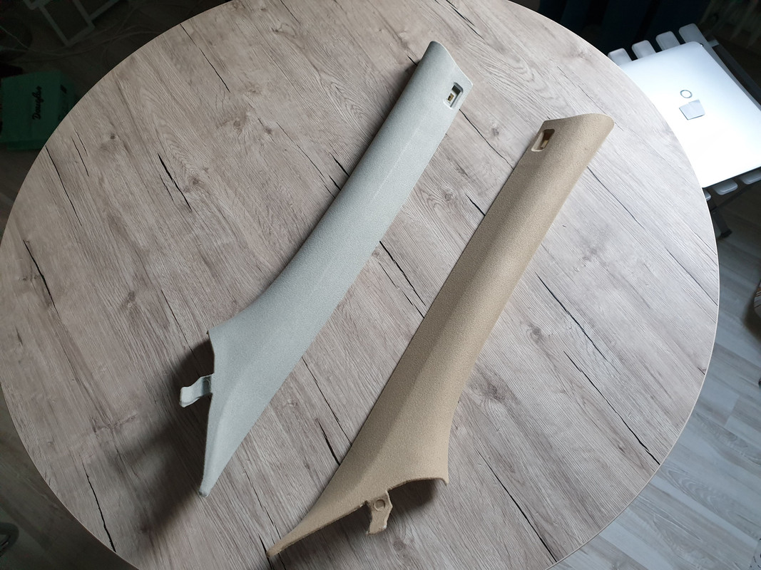

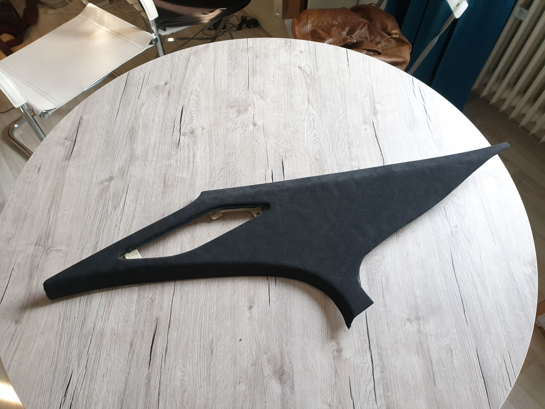

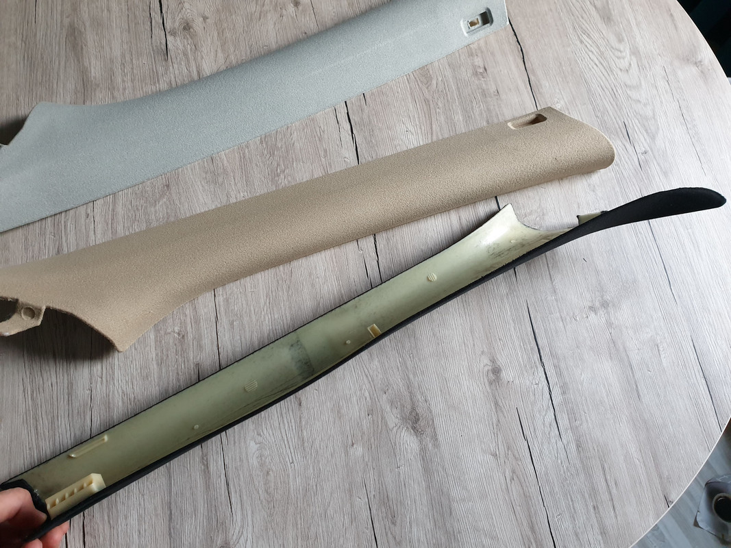

My A-pillars were actually looking very poor, the plastic was twisting and the middle tab was broken. I've seen this on many e39's.
https://i.postimg.cc/cJYsjRQw/20190407-115842.jpg
https://i.postimg.cc/BbZ4XRRB/20190415-191457.jpg
https://i.postimg.cc/bJhzjZTM/20190415-191433.jpg

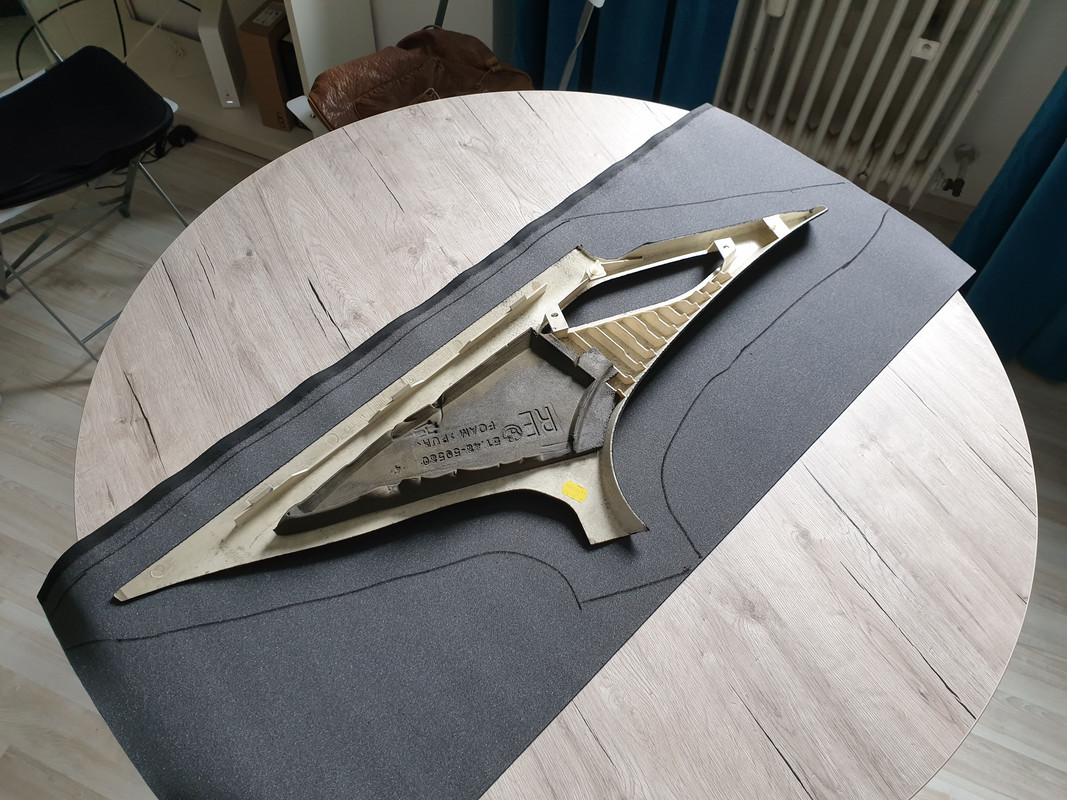

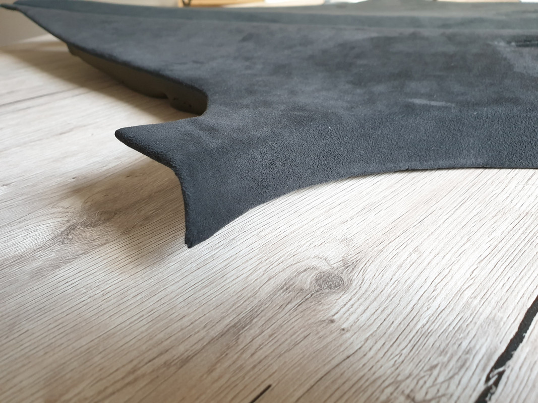

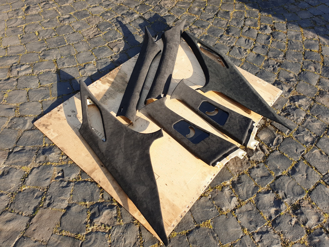

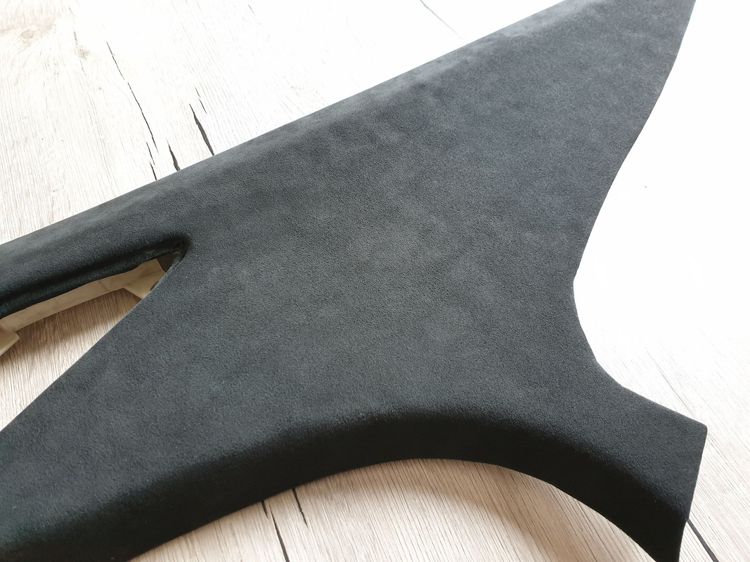

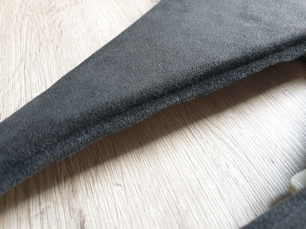

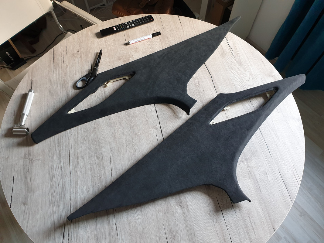

I decided not to use them and bought the cheapest new A-pillars I could find, removed the fabric and wrapped them in Alcantara.
https://i.postimg.cc/13h7BD5L/20190415-191359.jpg
https://i.postimg.cc/fbM2nZdC/20190415-191410.jpg
https://i.postimg.cc/RZ7sDqWq/20190415-191416.jpg
This is the final result. The pillars turned out perfect, not a single wrinkle or imperfection. Very pleased.
https://i.postimg.cc/3xNjgR2P/20190514-191957.jpg
https://i.postimg.cc/DyBdJs4r/20190514-192006.jpg
https://i.postimg.cc/nhW4TJkM/20190514-192011.jpg
https://i.postimg.cc/kGw8S3GJ/20190514-192018.jpg
In case you are wondering why is one of the C-pillars a bit different shade than the rest of the gang, I initially bought just a small piece of Alcantara to give it a try and see if I can actually do this.
Despite buying the full roll and the small piece from the same seller, the shade was a bit off which I realized later but in reality, this cannot be noticed inside the car.

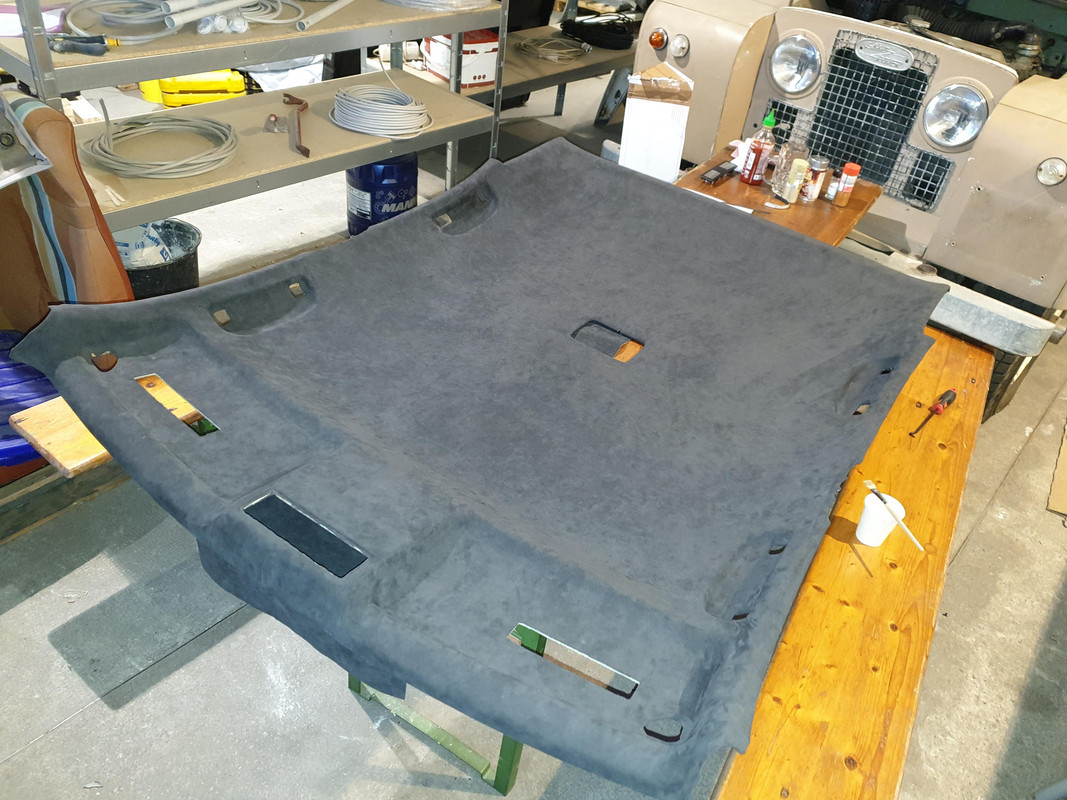

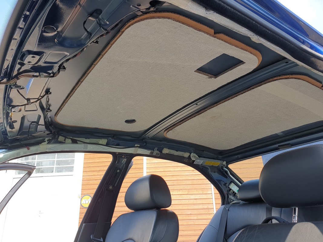

Next up was the headliner. No sunroof meant the removal was a breeze. I love the fact that it's a slicktop, so many benefits.
https://i.postimg.cc/FH276sJd/20190501-140026.jpg
https://i.postimg.cc/Zq8KDPS2/20190501-140504.jpg
https://i.postimg.cc/gcSc5kCz/20190501-140508.jpg
https://i.postimg.cc/qvnkzczq/20190501-141024.jpg

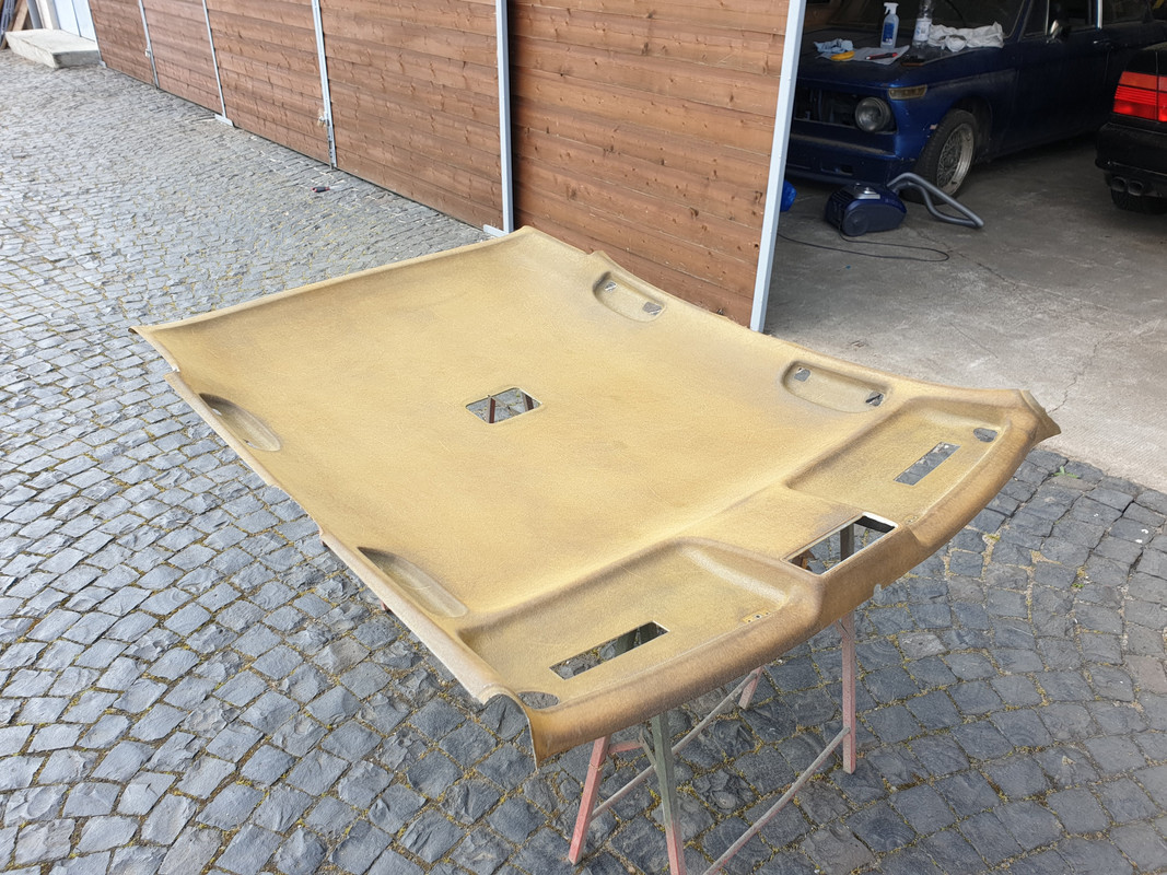

The old fabric comes off very easily.
https://i.postimg.cc/0r19fr4P/20190501-141515.jpg
https://i.postimg.cc/xd1NHFHg/20190501-141526.jpg
https://i.postimg.cc/wvtt4ywm/20190501-141532.jpg

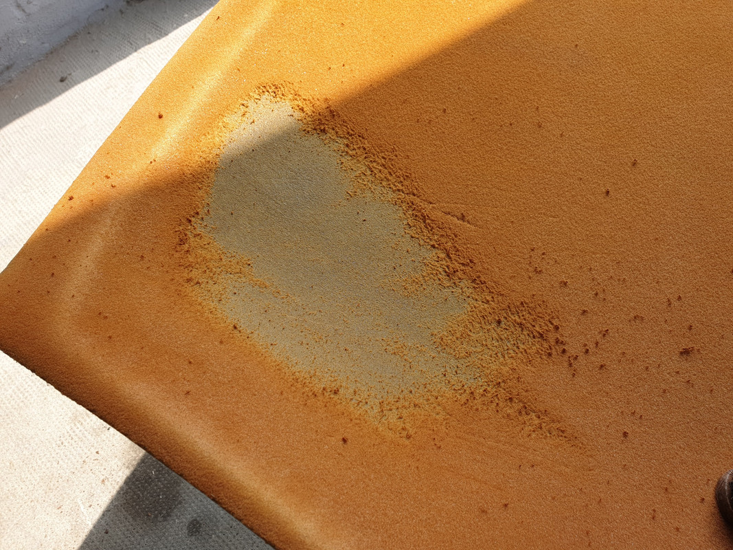

The leftover foam and glue are nasty stuff.
https://i.postimg.cc/L6FqvsLJ/20190501-142213.jpg
I used a brush to remove the gunk and I was vacuuming along the way to minimize the mess. Then went over the board with sandpaper and finally used a compressor to blow out any debris. This process was very time-consuming.
https://i.postimg.cc/13xkYfKN/20190501-164530.jpg
https://i.postimg.cc/0jbThS37/20190501-164519.jpg
https://i.postimg.cc/0NPLPFFk/20190501-164628.jpg
https://i.postimg.cc/4d3qhtXj/20190501-164633.jpg

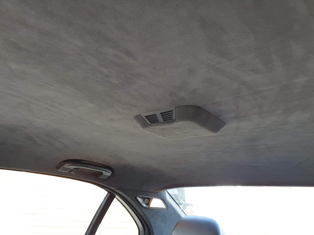

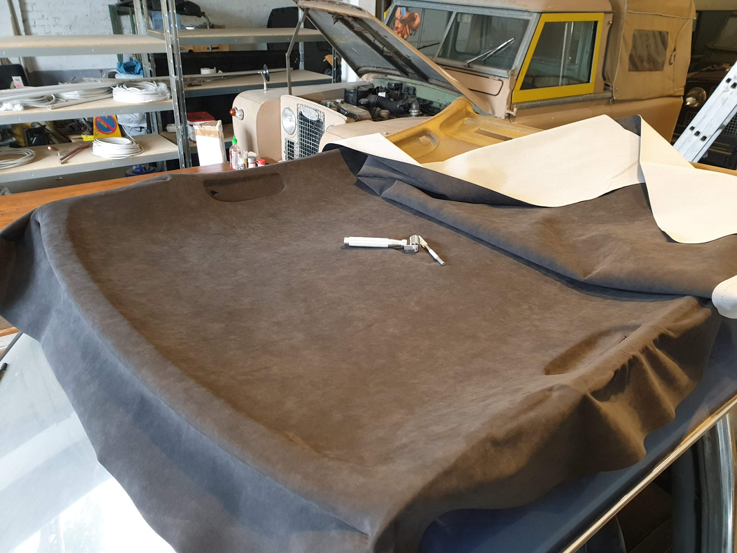

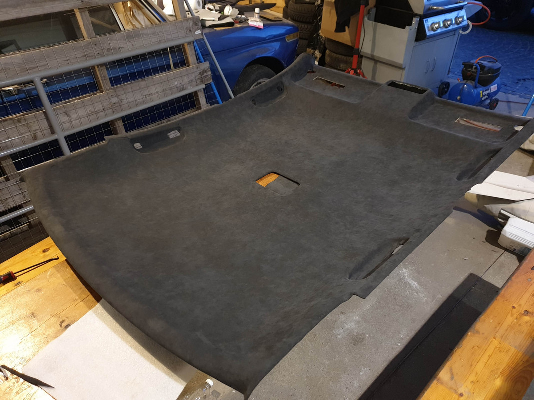

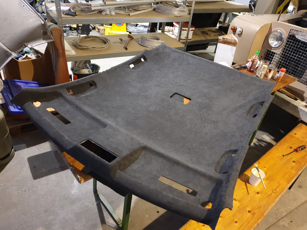

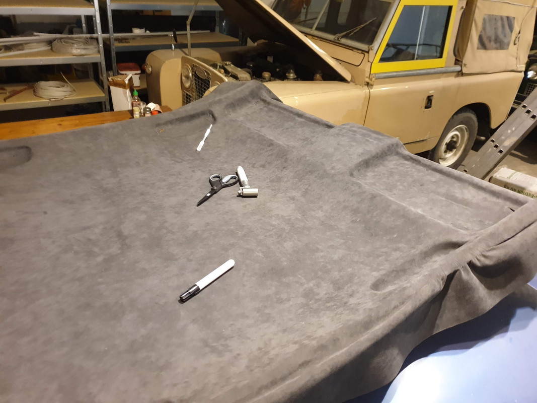

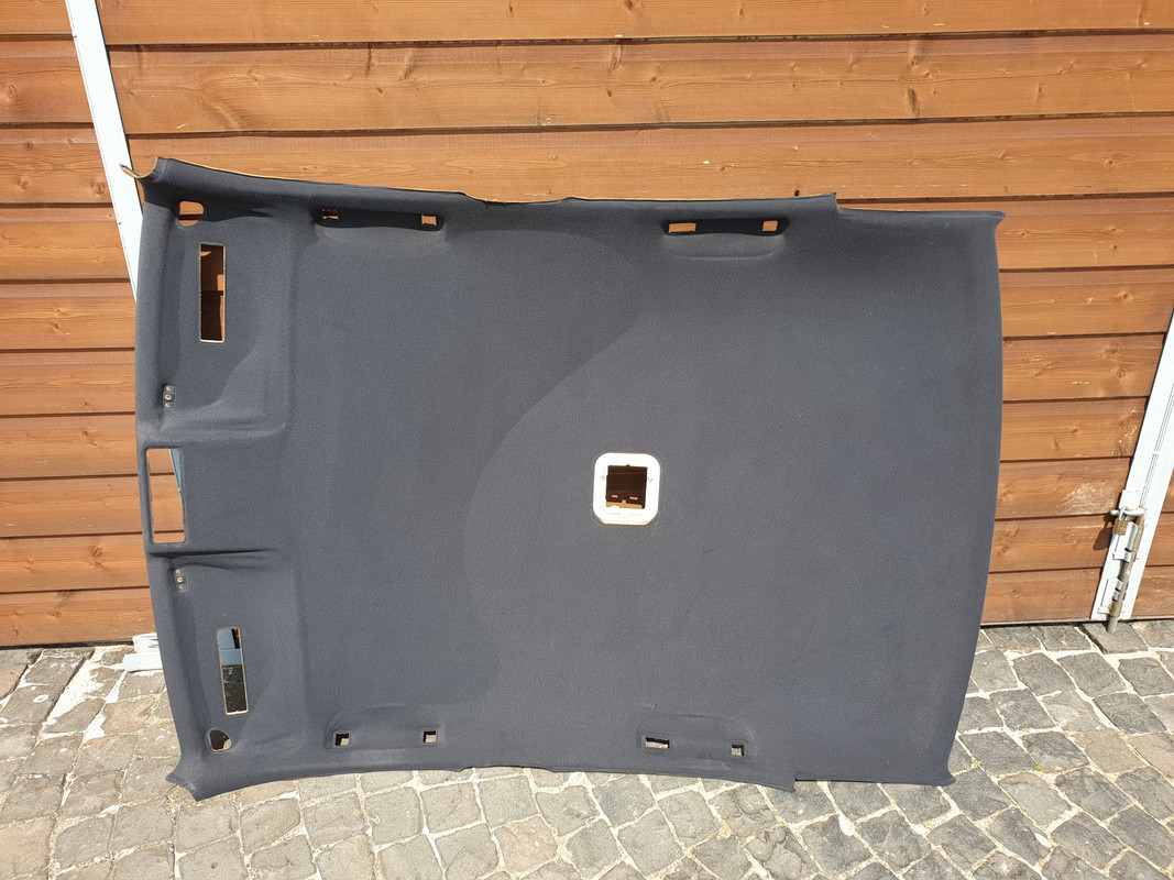

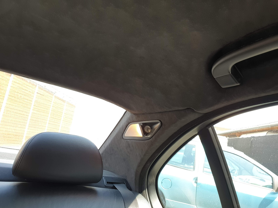

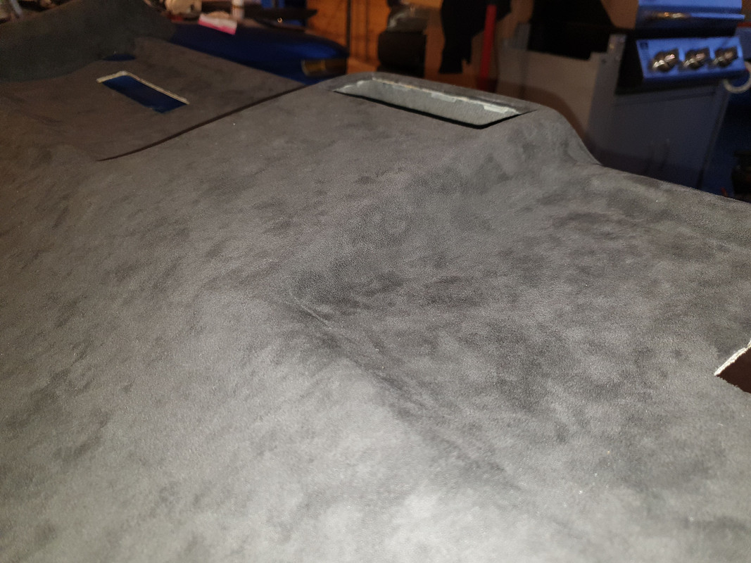

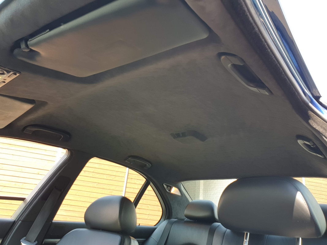

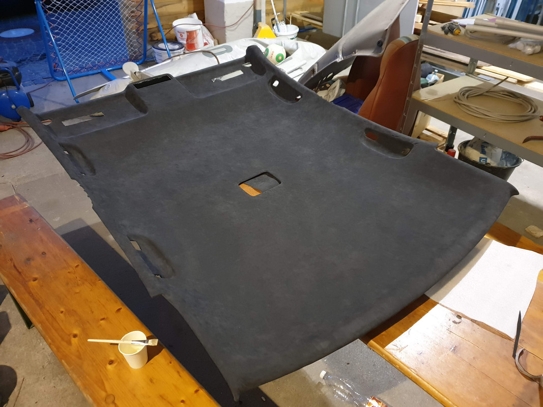

The headliner was the most difficult part of the project as expected. I did some research prior and watched a few videos but it requires skill and practice.
I started just behind the rear grab handle pockets going towards the back and then continued to the front.
https://i.postimg.cc/2SC81cB6/20190511-144809.jpg
https://i.postimg.cc/HW9dM00P/20190513-234643.jpg

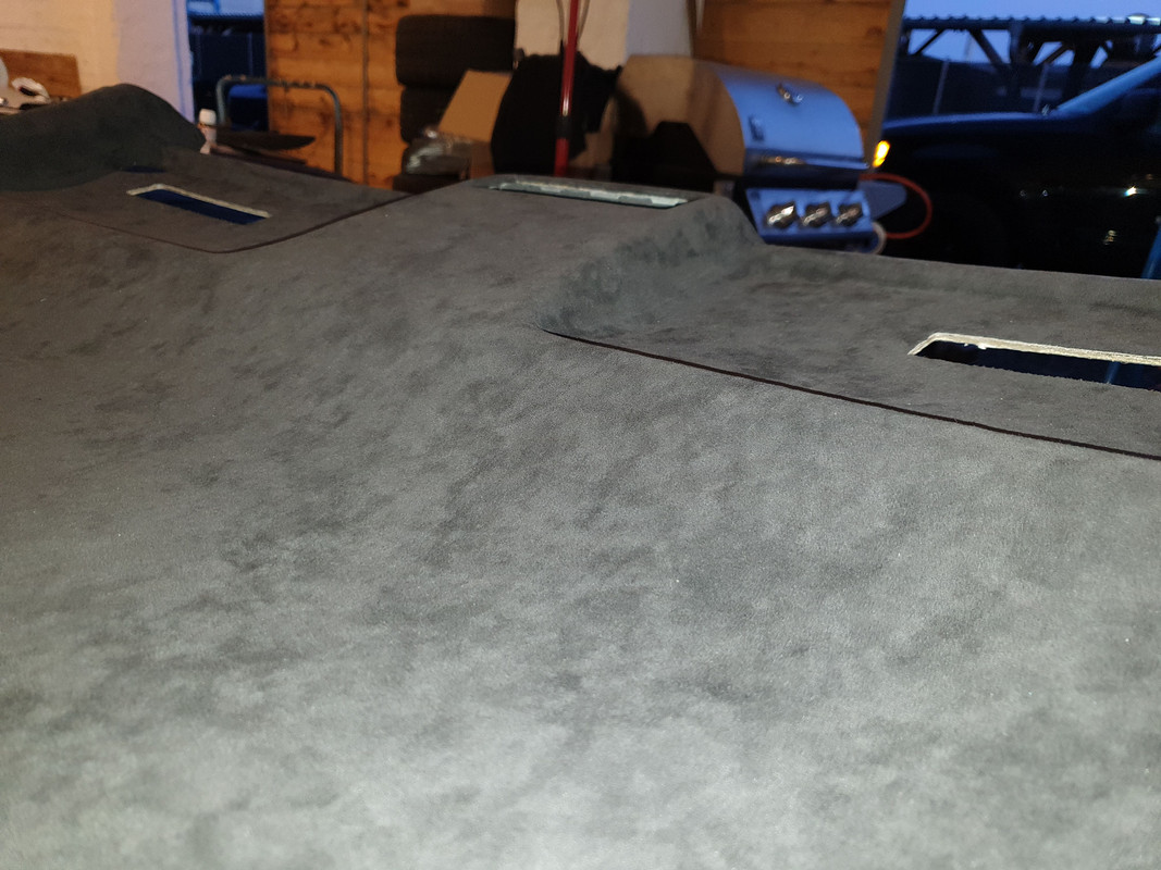

There are many curves and deep pockets which are so difficult to do and not get any wrinkles. Overall I did really well but I did end up with few wrinkles around grab handles and the very top in front of the dome light which is luckily not noticeable since it's obstructed by the top of the windshield. Around the sun visors and all other surfaces turned out perfect.
https://i.postimg.cc/59Tm4Qy7/20190514-212325.jpg
https://i.postimg.cc/tg3cPtZ4/20190514-211807.jpg
https://i.postimg.cc/sDM0KRQ8/20190514-211817.jpg
https://i.postimg.cc/TYBN4HnP/20190514-212137.jpg
https://i.postimg.cc/TPJkhdFy/20190514-212152.jpg
https://i.postimg.cc/nzd0YdHp/20190514-212213.jpg
https://i.postimg.cc/W3p5ZRc5/20190514-212219.jpg
https://i.postimg.cc/SR3dHJ2P/20190514-212229.jpg
https://i.postimg.cc/K8XQN3yk/20190514-212256.jpg
Considering I'm not an upholsterer by any means and this was my first time doing this, it turned out really good. It was a great learning experience and if I were to do this again, I know how I would tackle grab handle pockets to get them perfect and wrinkle-free and generally speed up the process.

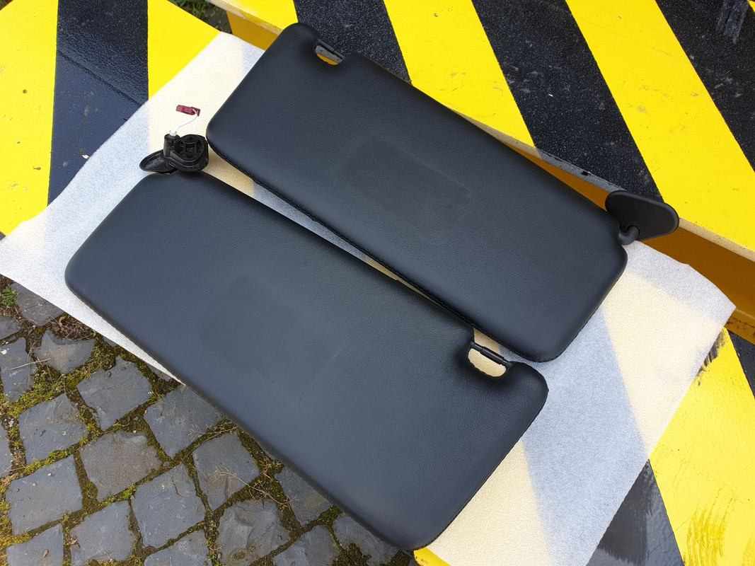

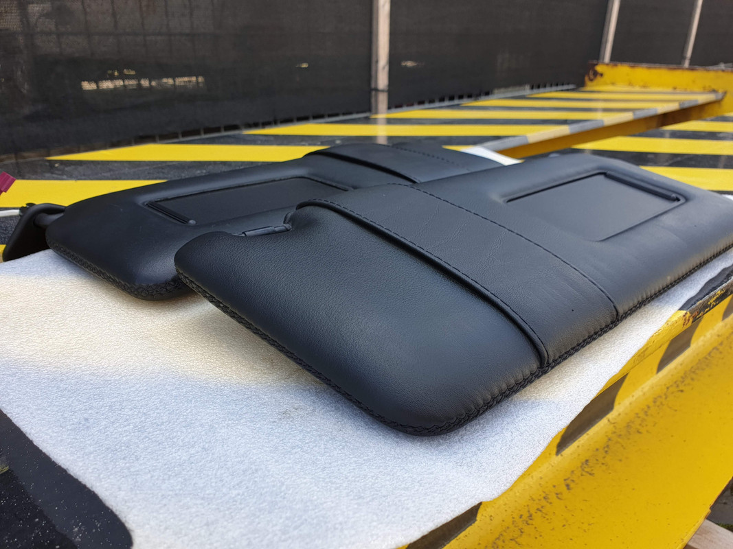

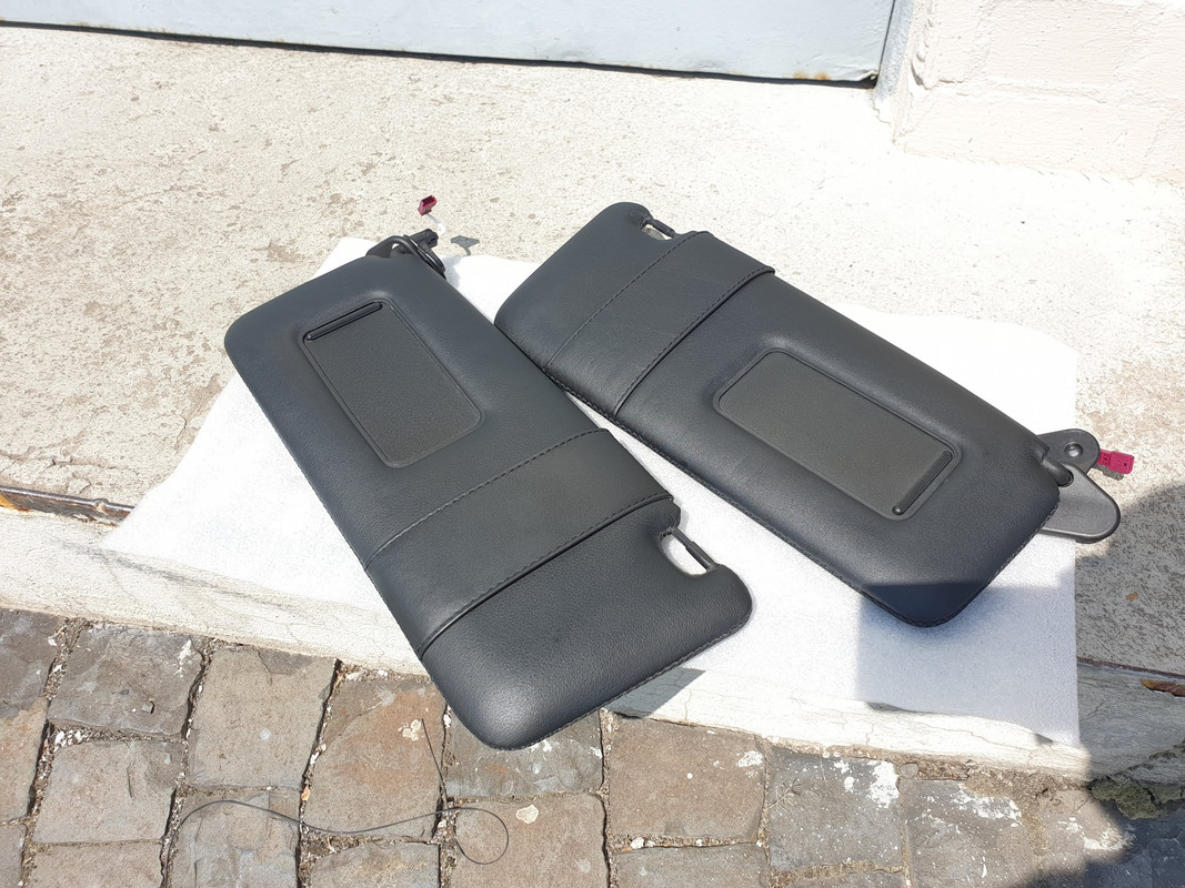

The final piece of the puzzle was leather sun visors, courtesies of Clemster! Big thanks to, Adam. They are in lovely shape and I just went ahead and removed the stupid airbag stickers though you can tell they were there which is a bit annoying. Eventually, I want to source Alcantara sun visors but those are difficult to come by.

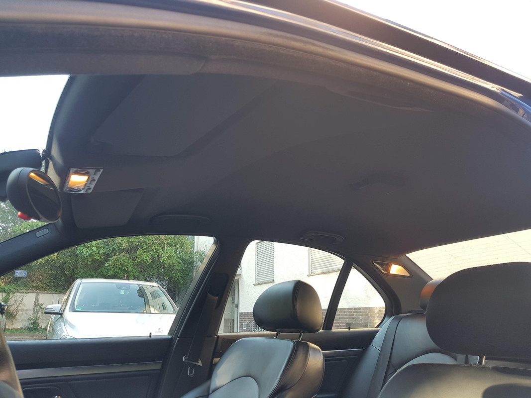

Everything put back together.
https://i.postimg.cc/gk5j00SN/20190519-150004.jpg
https://i.postimg.cc/tgGghMH6/20190519-150033.jpg
https://i.postimg.cc/bJ3NfYS0/20190519-150104.jpg
https://i.postimg.cc/0Q824Kj2/20190519-150112.jpg
https://i.postimg.cc/XqqNjM9R/20190519-150139.jpg
https://i.postimg.cc/zGgBH145/20190519-150132.jpg
Time-consuming task but worth it since the interior is that much nicer to sit in.

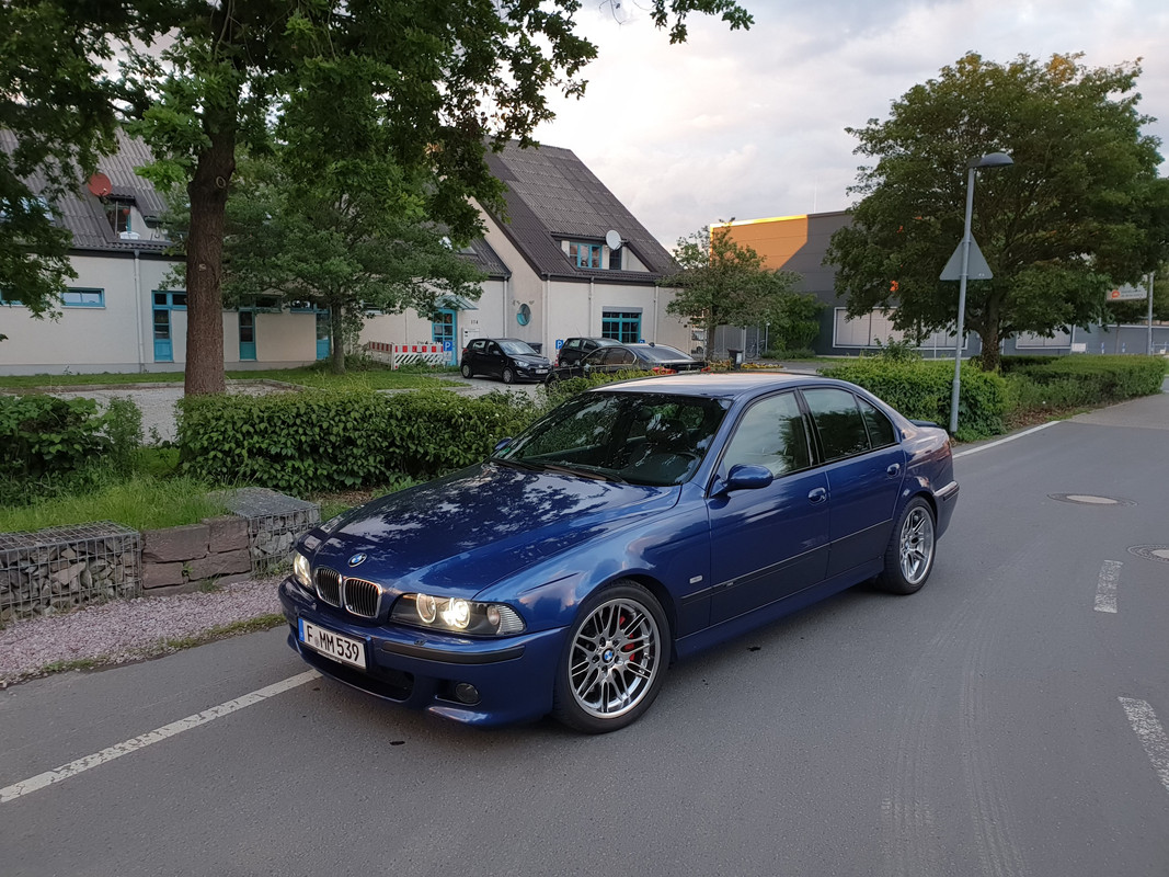

This month marks the 1-year ownership of the M5. 1st of May last year is when I flew to Italy and taken over the stewardship of this fine machine.
I did go through a lot of troubles with Italians to get this car but now I can say that it was worth it. As much as they were crazy in their own ways, they did take good care of the car.
I've covered around 7.000 miles so far and it's been enormous fun blasting down the Autobahn with it. Much maintenance went into it and I plan to keep in perfect shape and improving it as I go.
Some pics after a long overdue wash. I can confirm again that the finish of rims is bang on. They look so good.
