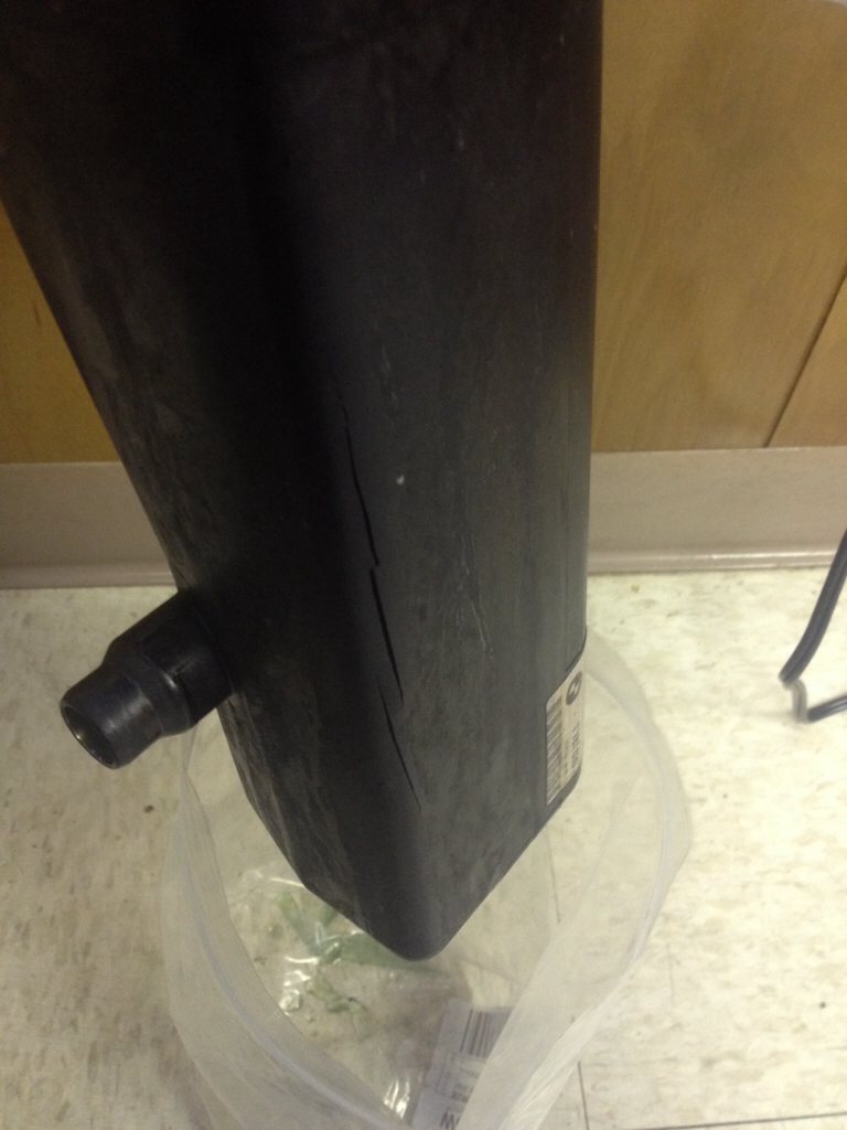

Damn! That looks like a good reason to invest in the GAS low pressure ET cap.
http://germanautosolutions.com/bmw_s...12_bar_cap.php
EDIT: I just noticed they are backordered. :(

I'm still undecided on the GAS cap. I know it is much more likely to prevent a catastrophic failure of the expansion tank, but ever since the install I've been losing small amounts of coolant. My coolant runs from max level to min level in a few months (3-4), so I find myself adding a little every now and then. Before I never even had to add a drop. I can't find a leak anywhere. I believe it must be venting out during high pressure so i may put on the OEM one and monitor it some more.
The OEM caps are designed to leak a bit under high pressure, so this cap probably just lowers the threshold? Seems like a top up every 4 months would be normal.
My understanding is that you should never really have to top off coolant, and certainly not every 4 months. It's a closed system. There shouldn't be any appreciative fluid loss unless there's a leak.
I was never sold on the GAS cap. BMW engineers picked the higher-pressure cap for a reason.
Hmmm.....Thanks for the first hand info guys. I've been going back and forth about getting one myself. I can't help but wonder if there might be some reason no one knows about for BMW to have used such a high pressure OE cap.
I always have used a bit of coolant myself. Not a lot, maybe 3 or 4 ounces a few times a year and I don't see any evidence of a leak either. I'd be interested to see if you find a difference if/when you try going back to the stock cap.
I'll probably just order one when they're back in stock and see if I notice any difference in my coolant temps.
I'm with Keith and was never comfortable with a lower pressure cap. I just bought a new factory one when I did my cooling system
