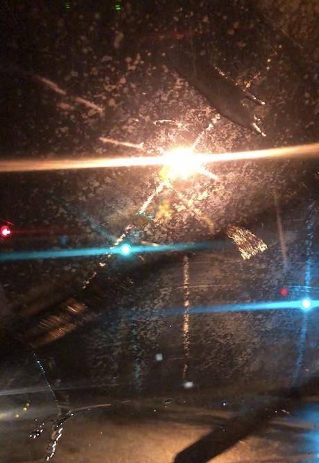

And I 'm buying new wipers but my windshield is just holding water heavily, even after I clean it. I have water spots that show as the wipers go over the windshield, and I suspect they are little differences in friction on the windshield that water can grab onto. Do other windshields have this from lots of rain or is there a way to treat this? Man I feel stupid right now.
edit: I'm so sorry I don't know how to make the image smaller
Attachment 36011
Yeah mine is not like that but it’s probably super annoying. Looks like water spots or some kind of contamination. I’d try to polish the windshield. There are dedicated glass polishes and pads but honestly I’ve gotten results with a cheap Wal-Mart polisher and meguiars ultimate compound. Just tape off the windshield trim and slowly work the polish in until it’s clear and oily looking. I’ve been able to get rid of minor water spots on glass like that. After that definitely put rainX or some kind of glass sealant on, to help your wipers out.
