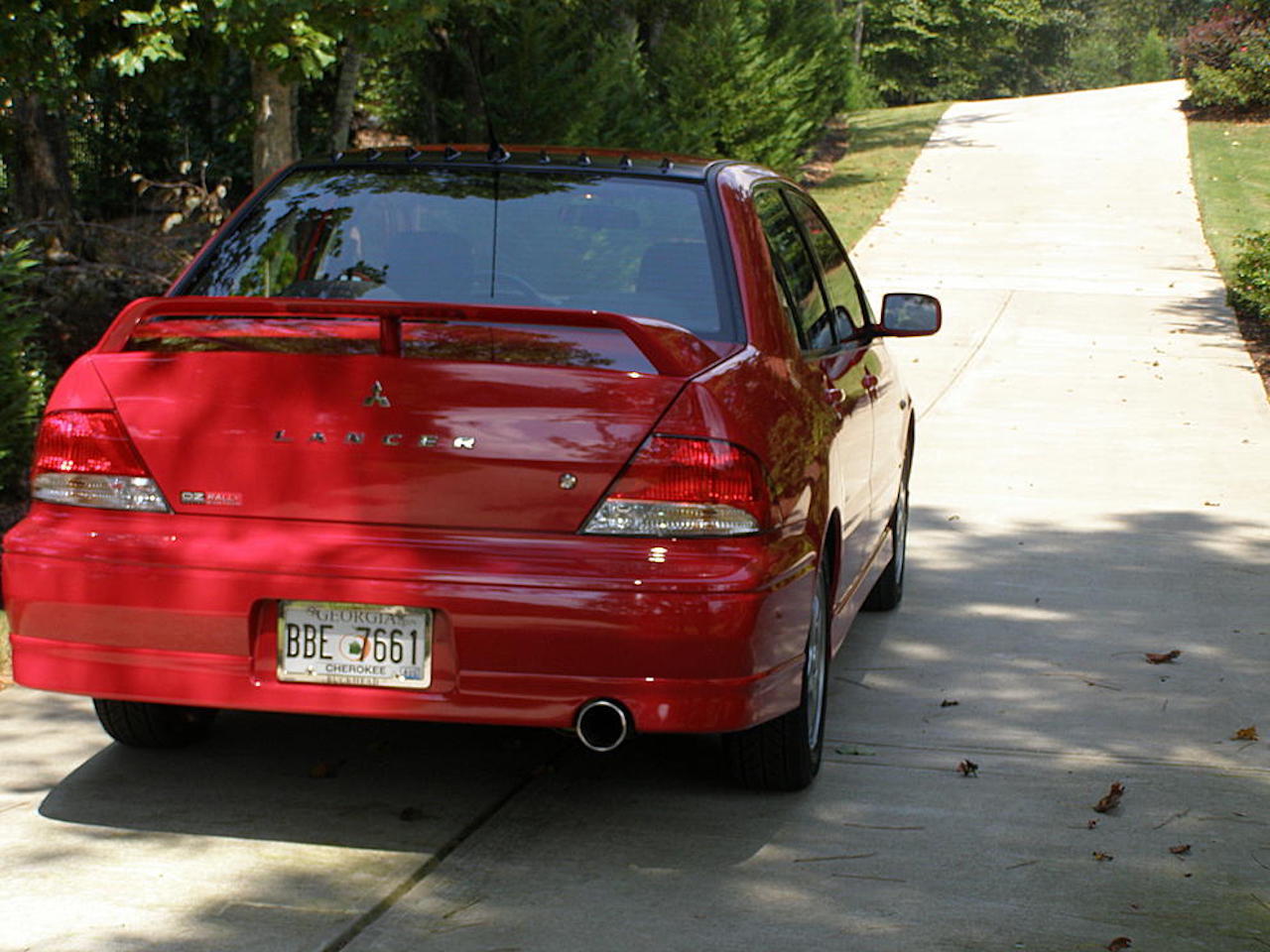

A little backstory about myself, my first car was a 2004 Pheonix Red Mitsubishi Lancer OZ Rally Racing Edition. Its funny now but I LOVED that car back in HS, had the coolest car after the kid with the brand new STI. I did very little maintenance on it but I'll be damned if it wasn't the cleanest lancer you've ever seen! Never died on me though, my trusty Red Rocket.
Attachment 34038Attachment 34039

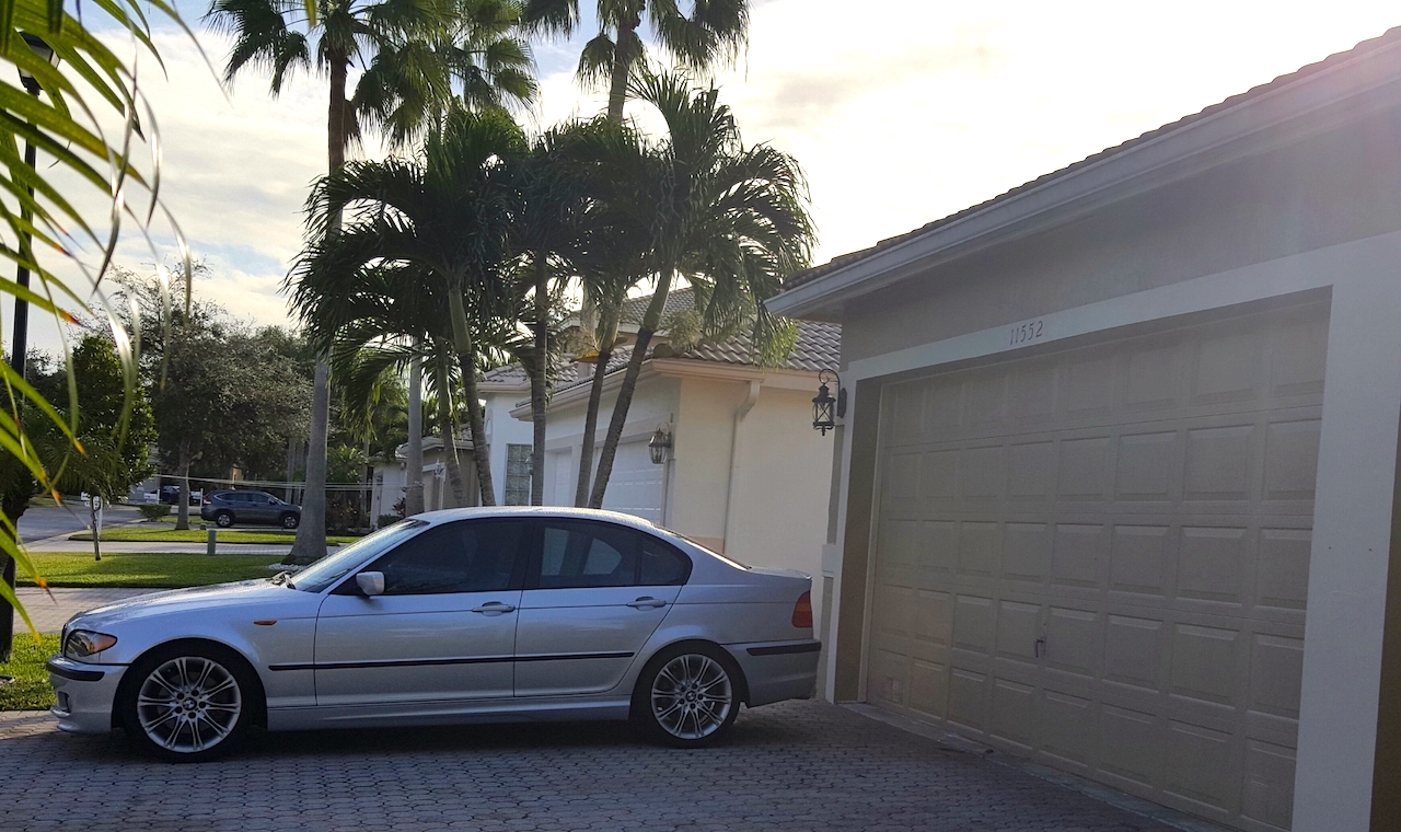

I have no pics on purchase day sadly but we picked it up at BMW South Atlanta where the PO had gotten a fresh oil change and replaced all the filters while he was work. I spent that entire first weekend decontaminating with clay and iron remover, then polished with my super cheap turtle wax polisher + meguiars ultimate compound that I had laying around, before topping with Collinite 845. Interior was treated with the Leather Masters kit from Detailers domain and Einzett cockpit premium.
After a couple of 12 hour days:
Attachment 34028Attachment 34029

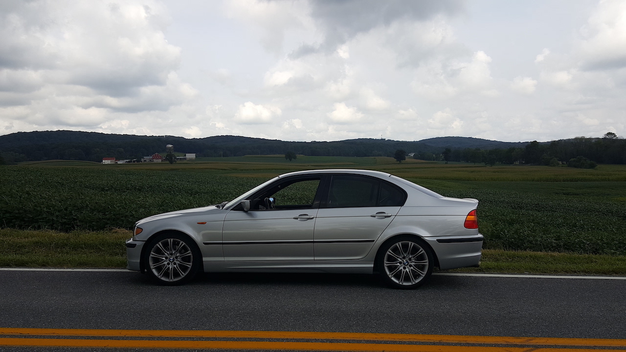

Attachment 34030
Moved to Laurel, MD for a year to continue clinical rotations and met the guys at Rennwelt, thanks to the mafia again! Done quite a bit of work with them.
Here are the beautiful views out in Frederick, MD
Attachment 34032

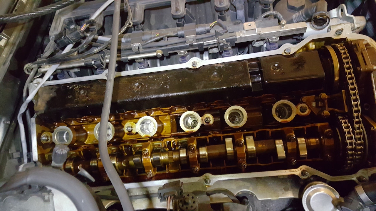

A look inside during a VCG replacement and finally got my M3 strut bar put in! Really wish I had thought to do the Vanos rebuild while it was open.
Attachment 34031Attachment 34037

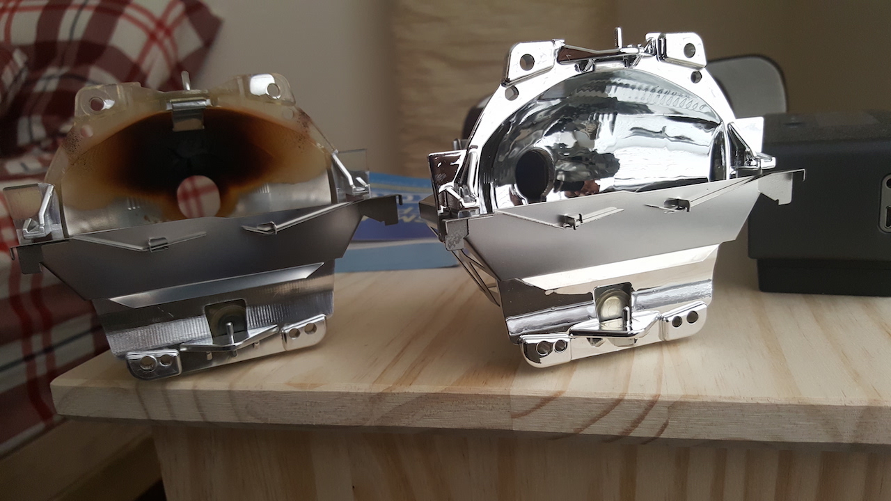

Replaced my burnt bowls with the refurbished bowls from Clemsone46. Clear to see which was original and which was the replacement.
Attachment 34033

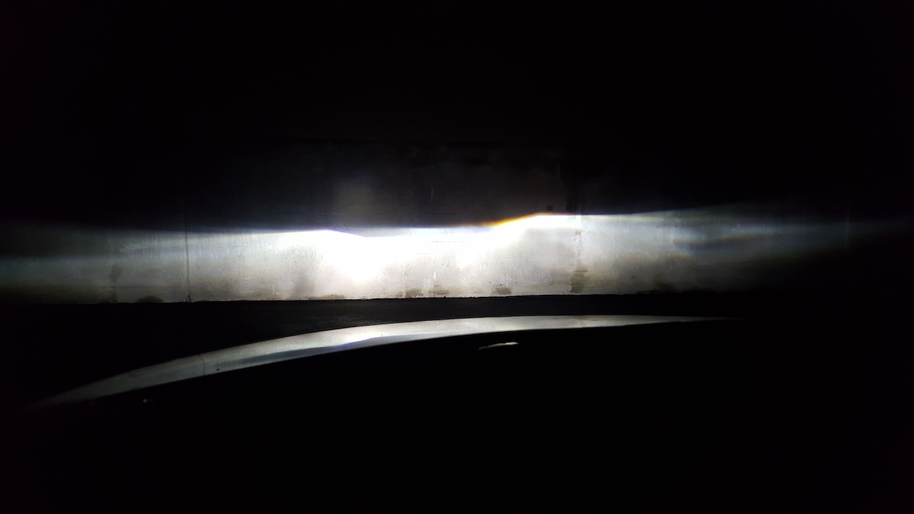

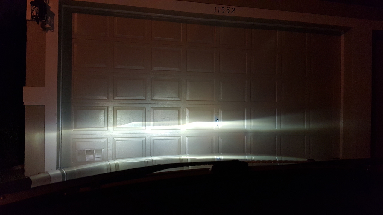

Light output: HUUUUUGE difference. Went ahead and put some Osram CBIs and enjoyed ridiculous light output
Attachment 34034Attachment 34035
