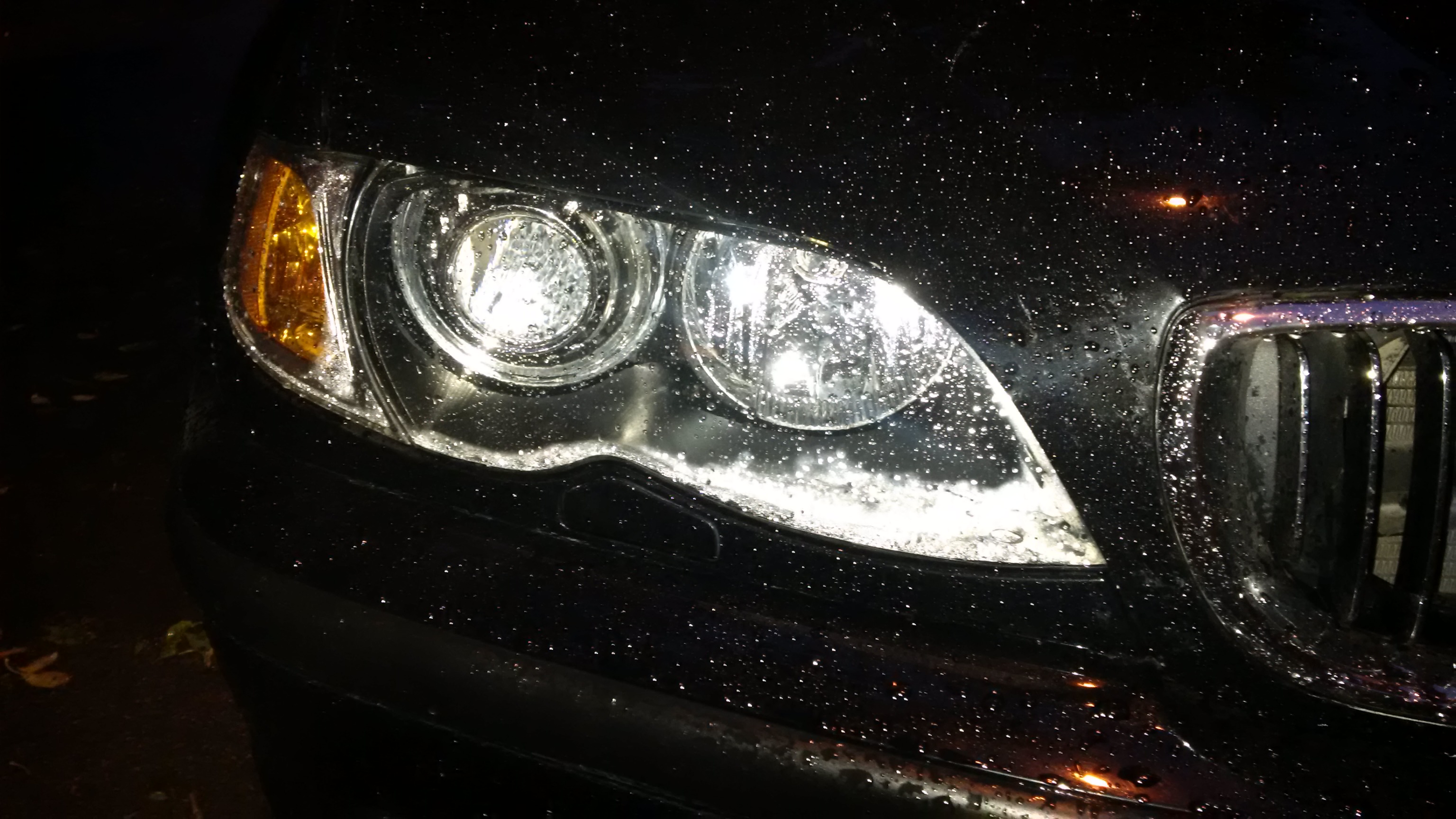

Replaced ZKW HIDs with The Retrofit Source so-called e46 kit
Their so-called kit isn't much of a kit, but at the end of the day, I'm happy that I can see again.
Their instructions aren't worth the pdf they're printed on, but thanks to some folks here and elsewhere posting photos and or videos I ended up making it all work.
Couple of things from my install come to mind as worth passing on, things that I've not seen in other discussions of this install (although that may simply be because I sometimes have a knack for not seeing the obvious.)
1) Once you've ground the plastic away to mount the brackets flush, they can fit 4 different ways but there is only 1 correct fit... the one that matches the bowl/lens assembly being mounted with the high-beam shutter on the bottom opposite the flat edge of the housing (because the lens flips L to R and top to bottom.)
2) When you re-use the screws from the original assembly to mount the new bracket, there may be clearance issues when mounting the bowl/lens assembly... I addressed this by shortening the screws.
3) You will not use all of the parts that TRS sends. They toss several completely useless items into the kit so that if the lack of instructions doesn't confuse you, the extra rings and electric coupler will. You will only use the 1 thick dark plastic ring if you are doing the zkw replacement as I did.
4) the provided electrical lead to the high beam shutter will need to be clipped/soldiered/sealed before being plugged into the new bowl/lens. Getting it to seat once it is ready to be attached is not easy, as the spot it goes into is narrow and deep. Getting it back out seems nearly impossible, so I'd suggest checking your work several times before plugging the high beam shutter lead into the new bowl/lens.
5) If you turned the height adjustment knob all the way so that the lights point down to remove the silver parts from the black housing when disassembling the lights as some instructions rightly suggest, I recommend that prior to reinstalling the completed lights into the housing you first turn the middle height adjustment knob all the way back (as if the lights are aimed fully upward) before trying to seat the lights in the housing for a much easier reassembly.
It is amazing what some of us have been missing with the burnt bowls. The difference in lighting is really quite drastic.
It is also amazing that BMW has not made right on this clear safety issue.
