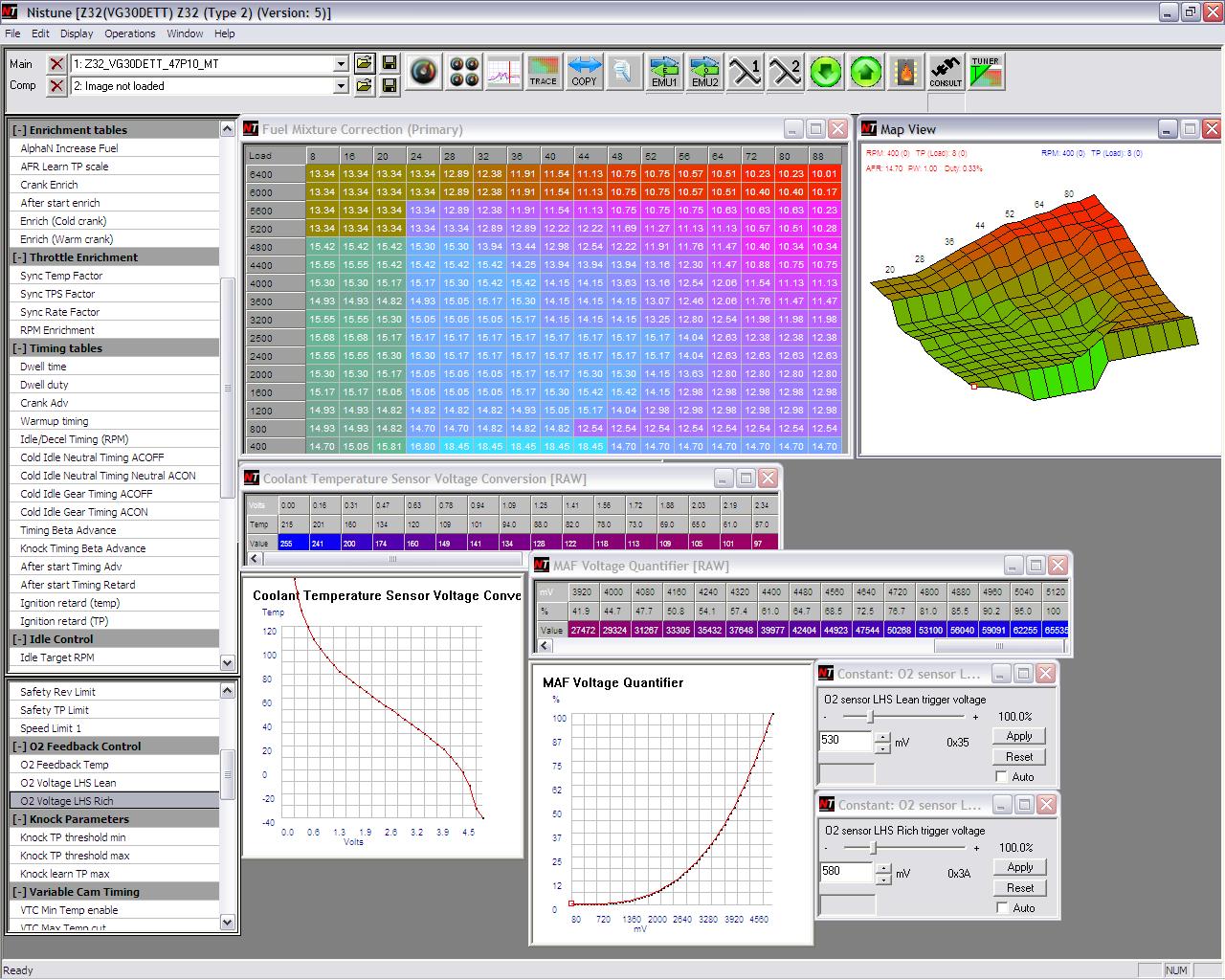

The software will be coming out with the latest release and with that version you can adjust axis data, play with O2 stuff and SAP.
Some have seen my post in my website but the software is BimTun, pricy but so far the only user friendly software for the home tuner/any tuner. Their site is here: http://www.bmweditor.com/Home/Product

Make changes with BimTun and it automatically does checksum, Powergate 3 also does checksum correction.
BimTun Bimmer Editor is $199 for the software, now what they offer are different modules for different DME's and software versions. This is the lengthy legwork some guys do using WINols to discover maps etc and then make a XDF file for TunerPro. Well BimTun does the work for you and it costs $199 per module (DME i.e. MS41, MS42, MS43 etc..).
