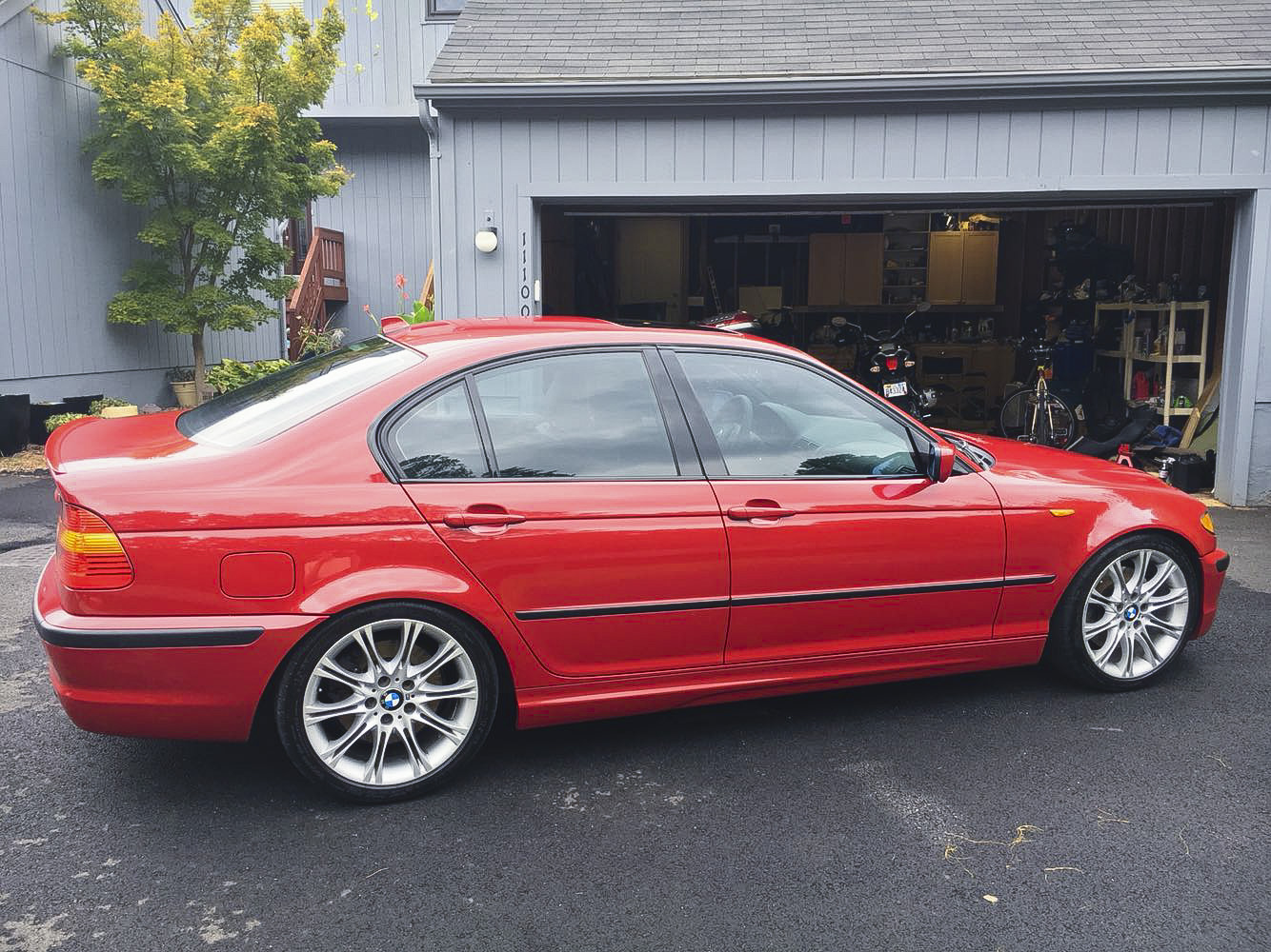

How she sits:
http://img.photobucket.com/albums/v1...psbcb042a2.jpg
Apparently i don't have current pictures of my car on the ground without stuff in the way :facepalm
