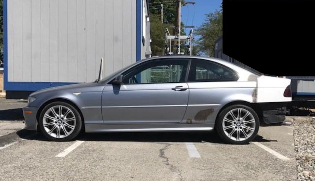

Specs of the car are:
2006 ZHP with 51,000 miles at the time of purchase.
Issues that need addressing:
01) Airbag Light
02) DSC / yellow "Brake" light (ABS Sensors?)
03) WSP Inspection [PASSED 5/15/2017]
04) Major Fuel Leak:crying:crying:crying
05) Rear Half Shafts/Boots/Bearings replacement
06) Rear Seating Arrangement (or lack there of)
07) Wheels and Tires [Received and Installed 5/26/2017]
08) Alignment
09) Rear-end damage
10) Rear Bumper
11) Paint
I will update this as I install the parts and work on the car. Pictures below for inspiration.

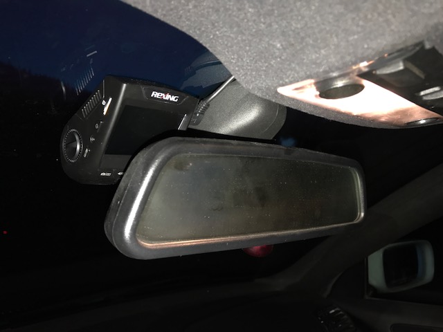

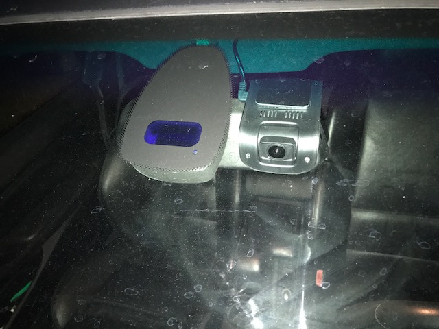

Dashcam Hard-wire and Paint.
In a true Russian fashion, I went ahead and hardwired a dashcam.
https://www.amazon.com/gp/product/B0...?ie=UTF8&psc=1
Attachment 30506
Please pardon the dirty windshield.
Attachment 30507
Clean install though.

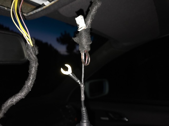

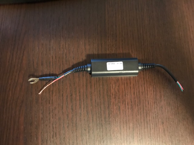

First Step - Shorten the wiring kit.
Attachment 30505
Took the Stock wiring kit that came with my dashcam: https://www.amazon.com/gp/product/B0...?ie=UTF8&psc=1
This "hardwire-kit" came with what feels like 15 feet of wire. So I shortened it for a factory feel.
Thankfully there were only two wires
RED - Hot
Green - Ground

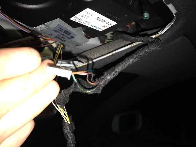

What I did next was I located my "Home-Link" wiring harness on the passenger side of the dome light assembly.
I took the green and blue wire and stripped it.
Attachment 30508
Attached my red wire from the hardwire kit to the green and blue wire from "Home-Link" loom.
Attachment 30509
Shrink wrapped the exposed wires and grounded the green bolt clip on to the screw with the bracket.

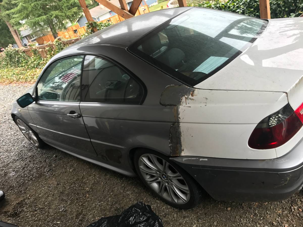

Complimentary picture of my paint skills.
Attachment 30511
Attachment 30512
