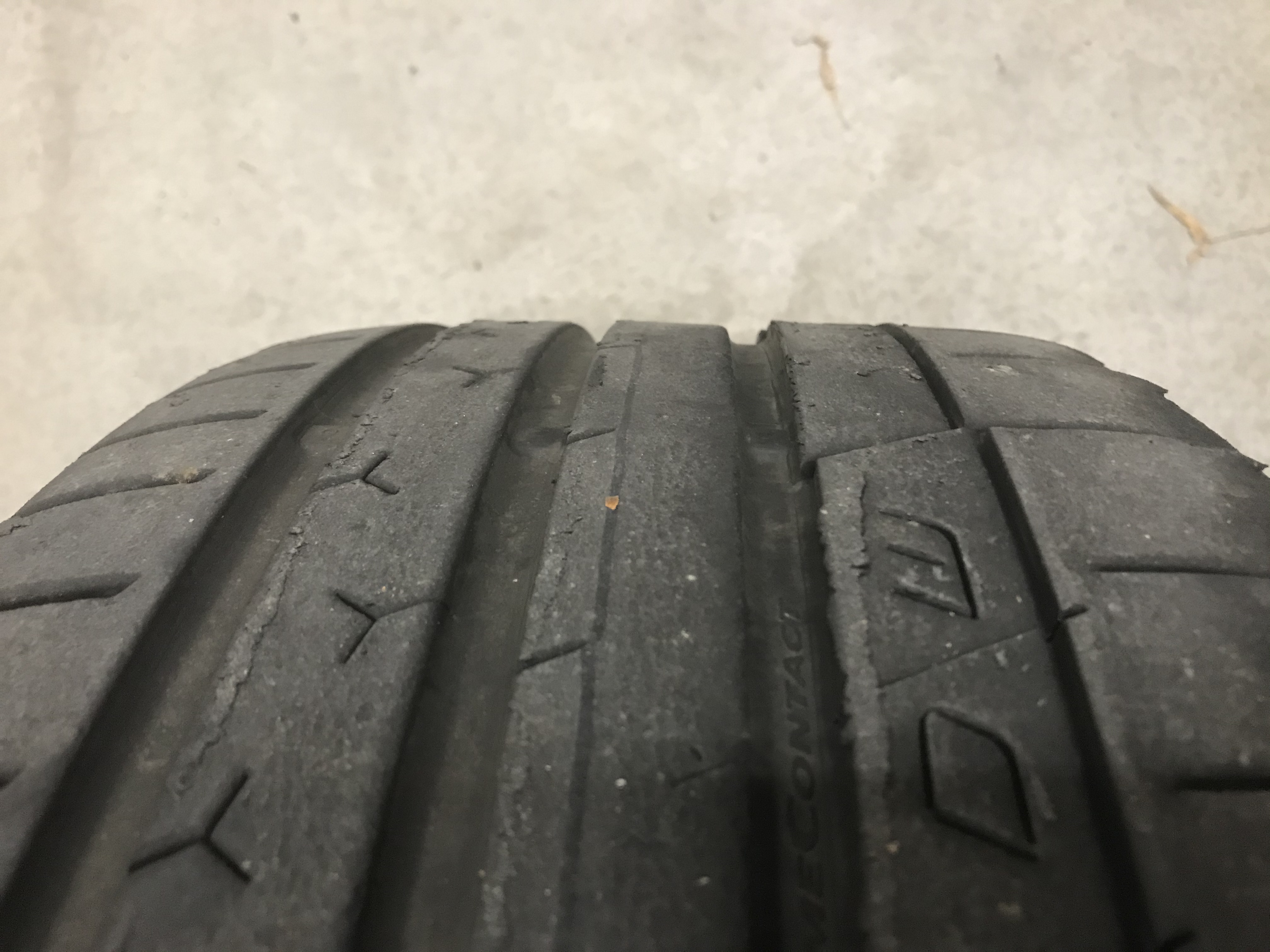

Did a track day at Thunderhill. Noticed a tire wear pattern I’ve not seen before.
Conti Extreme Contact on fronts. Gripped wonderfully. Loved it.
I noticed the middle rib is worn at an angle. This is only on the front passenger side. The 4 hardest corners at the track are left handers (throwing weight to the right), so it makes sense.
Is this a PSI issue, or tire design, over-driving the tire, or something else?
I pushed the car to my limits this time. I knocked 6 seconds off a lap (1:38), which I’ve never done before. I explored pushing the front to understeer on a few corners.
Any thoughts?

Do you feel any blocking/feathering on the shoulder at all? I couldn't tell from the picture. But it might be improper toe or caster.
