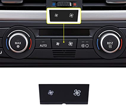

The second issue is the AC. The AC doesn't blow very hard, only when i turn the fan speed up to the last 3 settings does the air current reach me. The side vents barely blow air at all, even on the high settings. Even weirder, if i close the air vents and turn the fan speed high, air will blow out from the dashboard, in between the gaps of the radio/hvac and storage compartments. The front windshield defrost also doesn't work. If i press the front defrost button, the vents on the back of the dash don't work, instead, it just turns the fan speed on max for the front facing vents. The AC does blow cold air, but it doesn't blow heat well. It doesn't blow hot unless i turn the climate control above 80°F at normal engine temperature, and then the heat "runs out" after 15 minutes unless i turn the temperature up higher.
