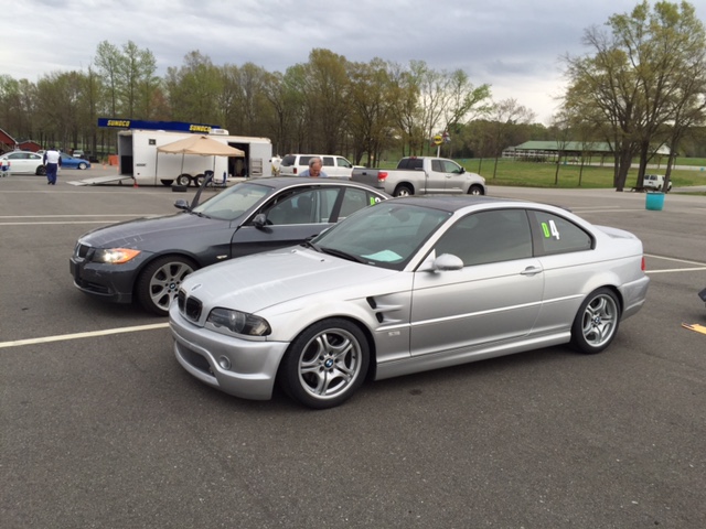

My Setup: PSS9s - I believe I'm at their lowest setting if not, very close...I guess doesn't make an appearance difference, but I'm running Purple Powerflex FCABS, Powerflex poly subframe and diff bushings, Meyle HD front control arms, Z4 RTABS with limiters...RD Sport sway bars.
Driving style - on the street, I will enjoy a turn if the conditions are right...I've tracked it twice
I'm reasonably happy with it, I prefer the street ride of the stock ZHP suspension...would like to upgrade for better track performance.

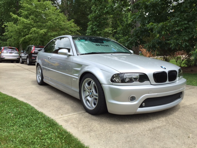

I just finalized my suspension refresh and upgrade today with the installation of a new front sway bar. Overall, I'm extremely pleased with how the car feels and handles now compared to what it used to. However, and in hind sight, I regret trying to save a few bucks by installing AST's non-adjustable 2000 series coilovers. For $1,300 it's a fine set up for cruising and some semi-spirited driving, but if I had it to do over again, I'd gladly cough up the extra dough on a more high end setup that offers both compression and rebound adjustments, as well and one that offers coilovers for all four corners, not just the front like most aftermarket setups for the E46. Had I done more research before pulling the trigger on the AST's, I would have gone with either JRZ or TC Kline. Maybe later, but for now I did save enough by going with the AST's to afford a new set of wheels and tires!
My civilian driving style is pretty tame. I hate speeding tickets and I only really let go on isolated stretches of road where no one else is around. I save the aggressive stuff for track days.
Other than the OEM stuff I replaced, my current setup includes the following upgrades:
- AST front coilovers and AST rear springs and shocks
- OEM front strut reinforcement plates
- Vorschlag caster camber plates (on order)
- Ground Control front sway bar and adjustable end links
- Ground Control rear shock mounts
- Rogue Engineering press in aluminum sleeved FCAB's (black)
- Rogue Engineering rear TAB's (black)
- SPL Adjustable rear lower control arms (on order)
