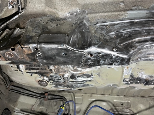

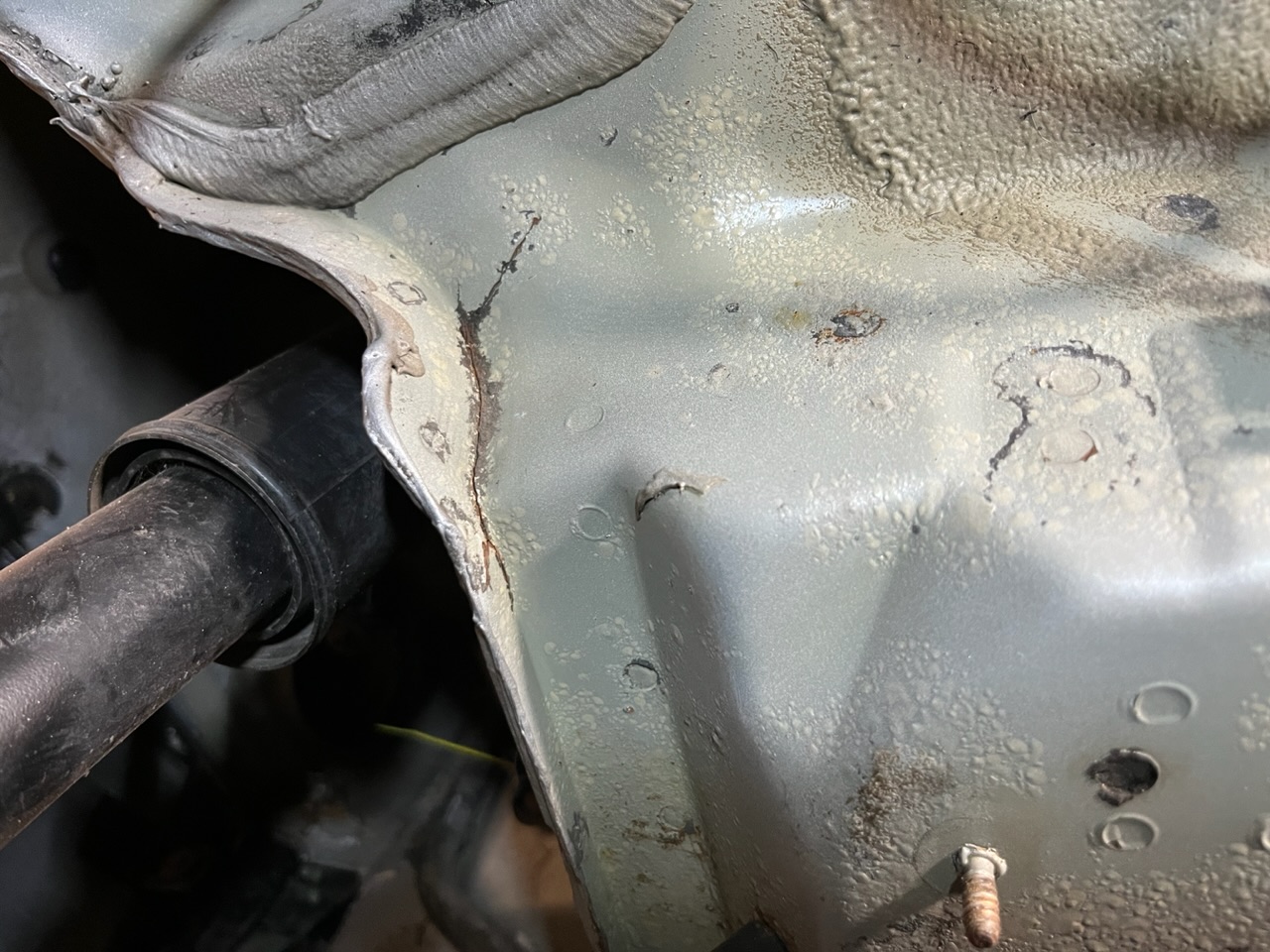

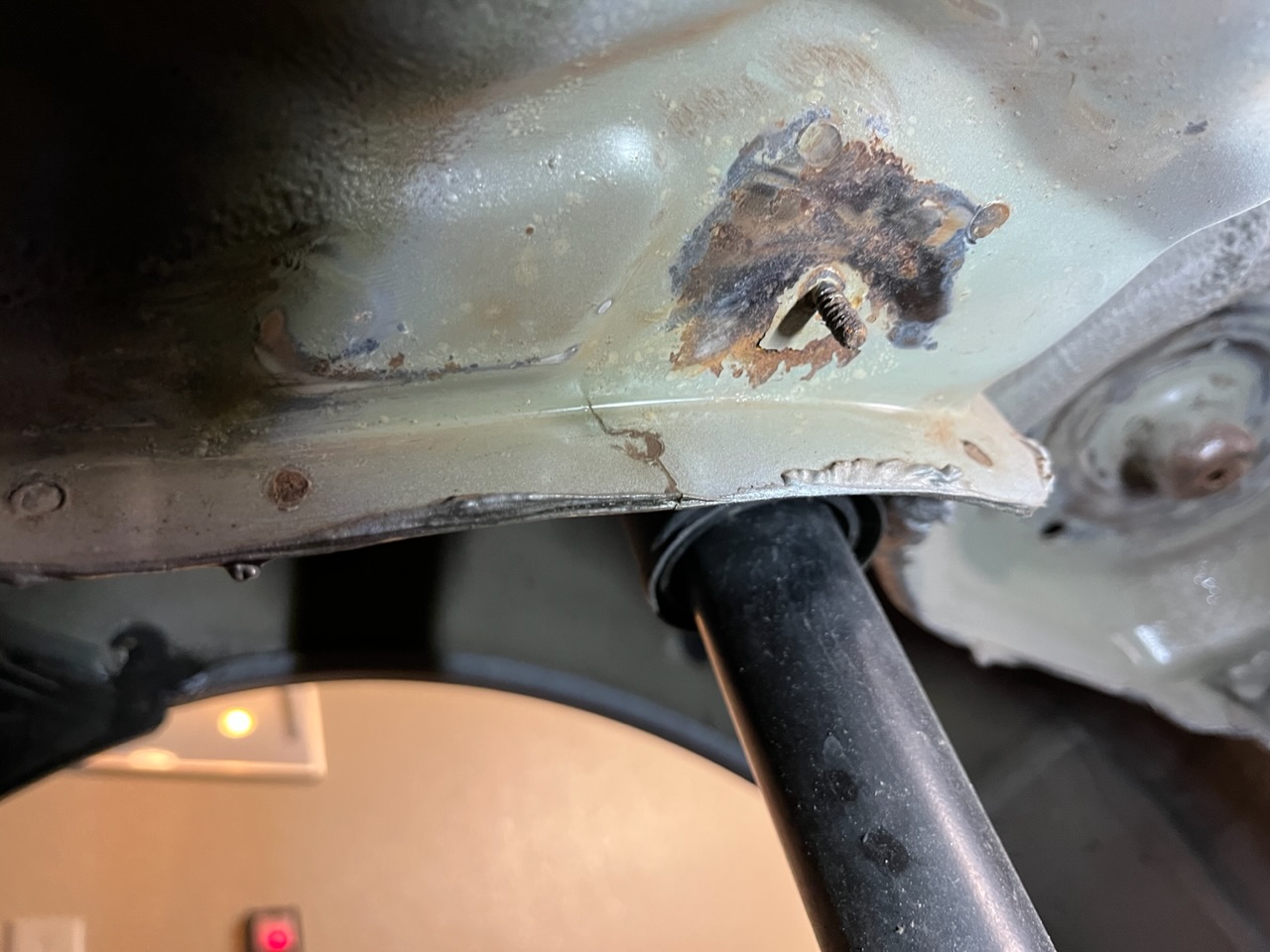

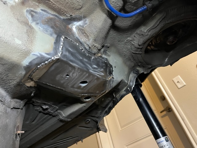

Never buy an E46… found cracks on the drivers rear which was typical. I also found a crack on each side of the RCAP where it mates to the wheel well. The longest was on the passenger side. Good thing Redish has so many videos in this I know exactly how to tackle it. I think I see the light at the end of the tunnel!
Attachment 39819
Attachment 39820
Attachment 39821

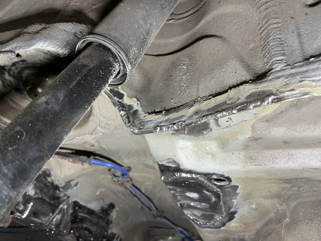

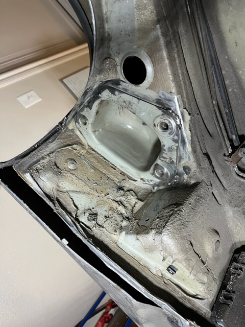

This was way tougher than my E36. The plates went on fine. The wheel arch and spot welds I had to repair gave me so much trouble since I couldn’t clean the area out enough. Got a few new tools out of the job such as carbide bits and a spot weld cutter.

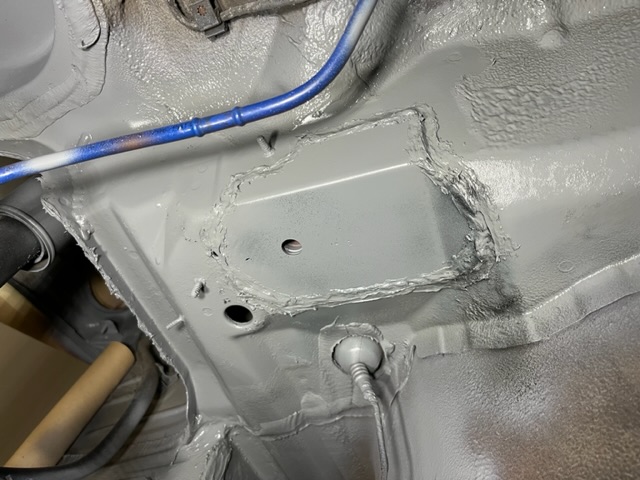

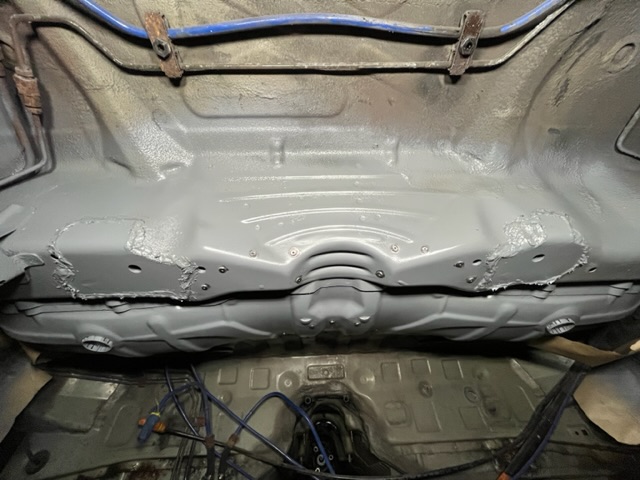

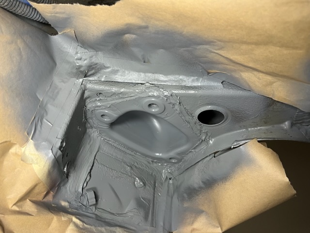

And a few seam sealer and painted shots. Need to weld the bracket for the e-brake cables and subframe bracket back on for the body work to be complete. I still need to paint the subframe… boy am I sick of paint prep.

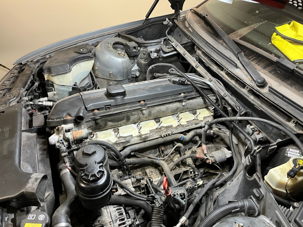

Rear sway bar reinforcements and finally engine work. The coolant pipes look original indicated by the blue zip ties. Going to be deleting the SAP, purge valve and heater hoses now. Finally getting towards track car status…
Attachment 39862
Attachment 39863
Attachment 39905
Attachment 39906
Man no love for the Stimmy package car… finished up the coolant pipe. Removed the heater core hoses and blocked the pipe off at the head using the BW kit. Also installed the SE46 exhaust and sent it out for an autocross.
