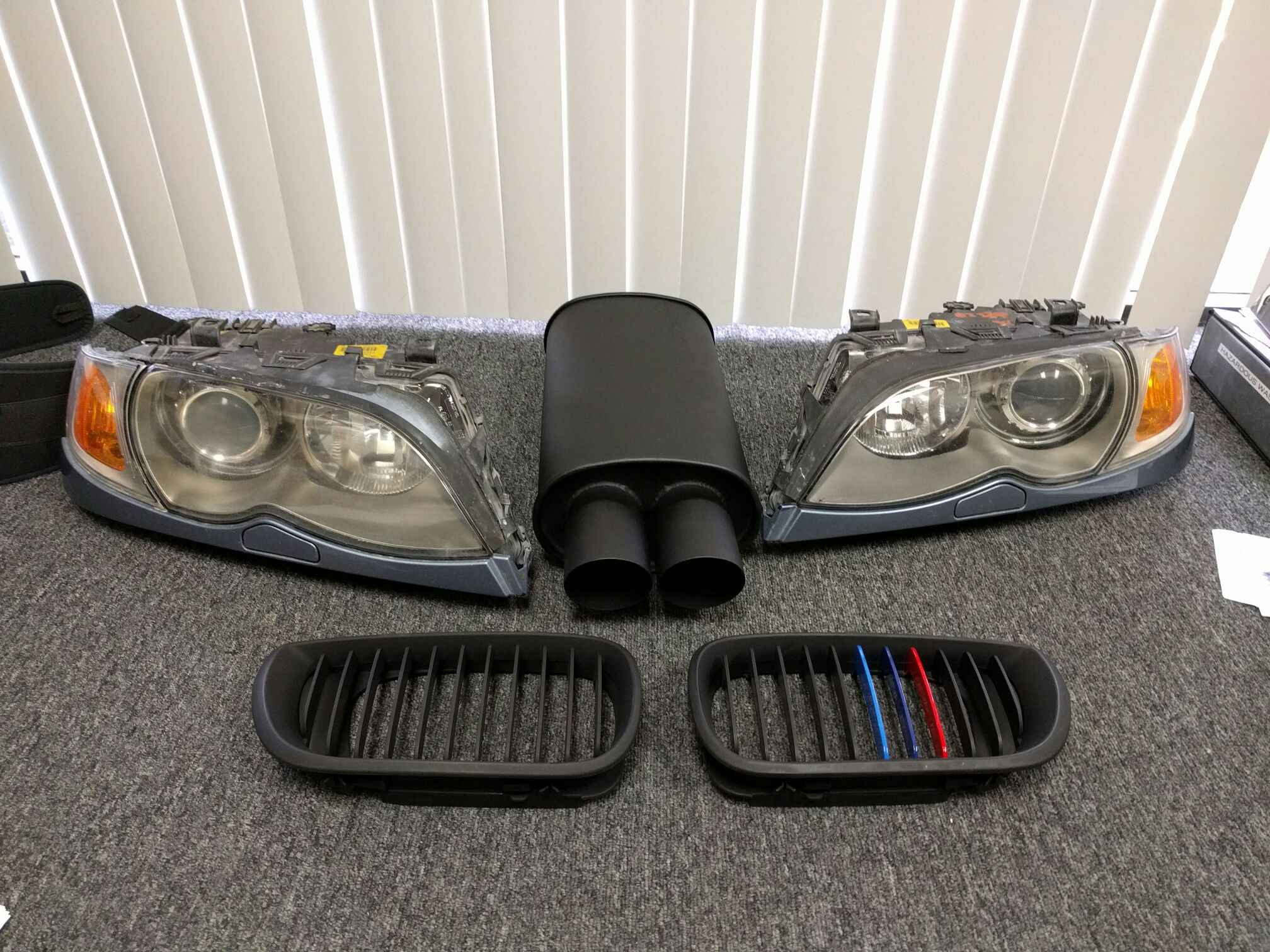

1 Attachment(s)
Picked up the rest of the goodies at work today :thumbsup
Attachment 27048
