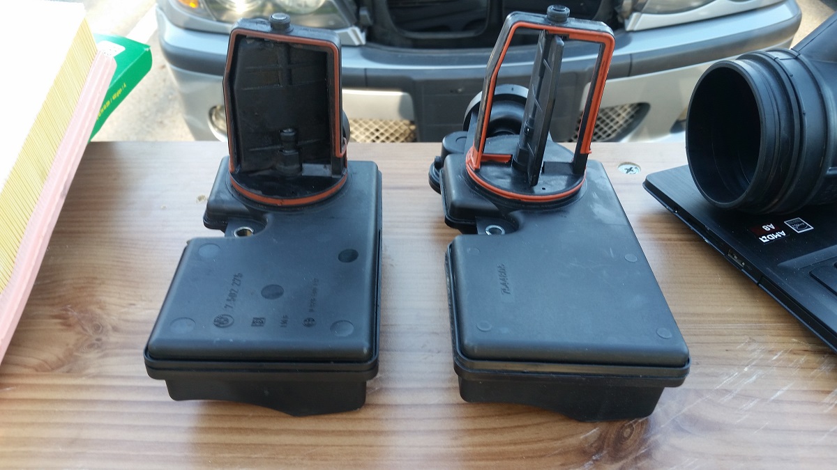

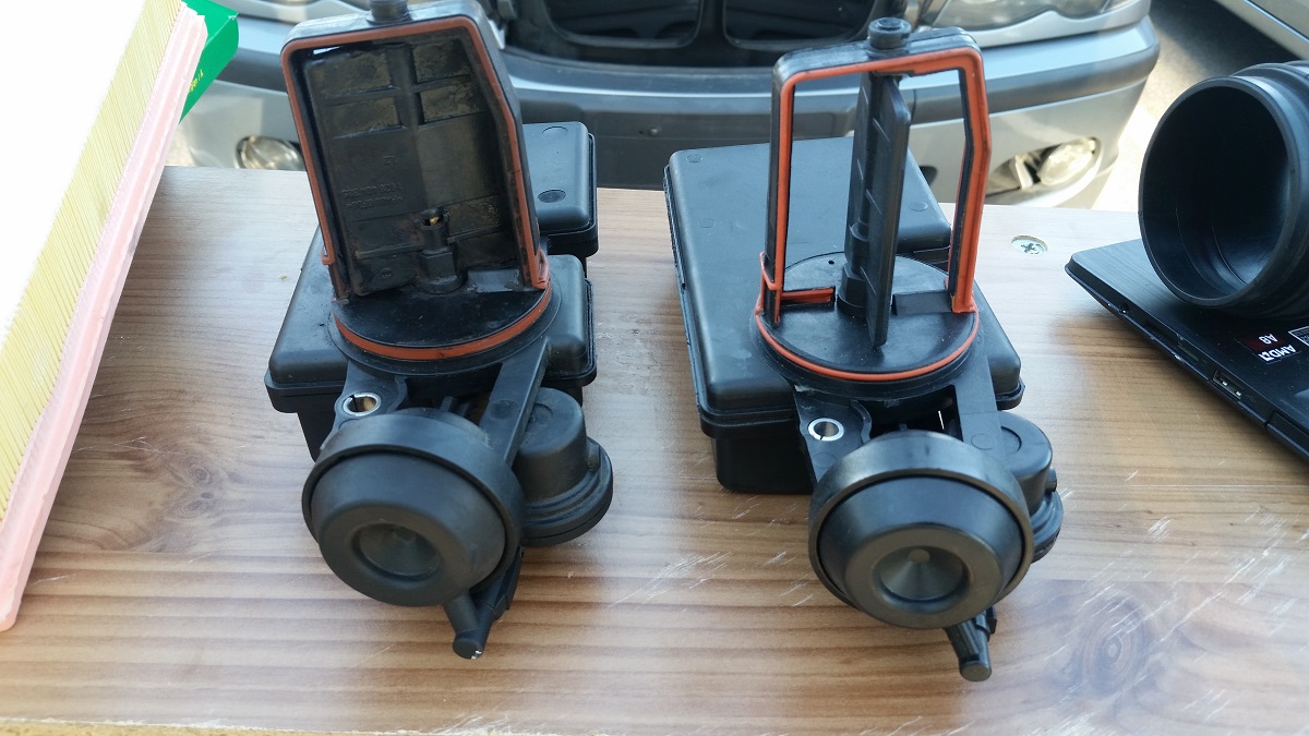

Attachment 27620Attachment 27621
There are some differences between the two. The flap looks different, the gasket looks different, and there is no BMW logo or part #. I called Turner today and the part comes with a 1-year warranty. However, to get a replacement or a refund, I need to send the part to turner, who will then send it to BMW or the manufacturer to have it tested. If the test shows that the part is faulty or failing, Turner will be reimbursed, and then I will be reimbursed.
Meanwhile, I have to pay out of pocket for another DISA valve since I can't drive around with a 3" open hole in the manifold. F me. I didn't ask about shipping fees, and imagine I'd be out that money. Seems like a hassle but i am going to send the unit in as there is something clearly wrong with it. Have been driving with it unplugged and my god, the difference in performance and noise is huge!

@GotZHP, it seems you already have a older (perhaps non-functioning) BMW DISA lying around - the one on the left in the pictures. Why dont you order the GAS DISA kit and rebuild that one? Much cheaper than buying a brand new one (which is bound to fail again sometime in the future) or having to deal with Turner's shitty warranty process.
I did the same thing with my previously failed BMW DISA when the Vaico one (which I got from ECS) failed after a year. Although ECS tuning was nice enough to ship me a replacement one before I had to ship them the defective part. I sold the replacement Vaico DISA to a local BMW owner, with all the warnings that it would eventually fail.
The GAS rebuild is permanent and it literally took me 30 mins to do it. They have very detailed instructions with pictures and it makes the job really easy.

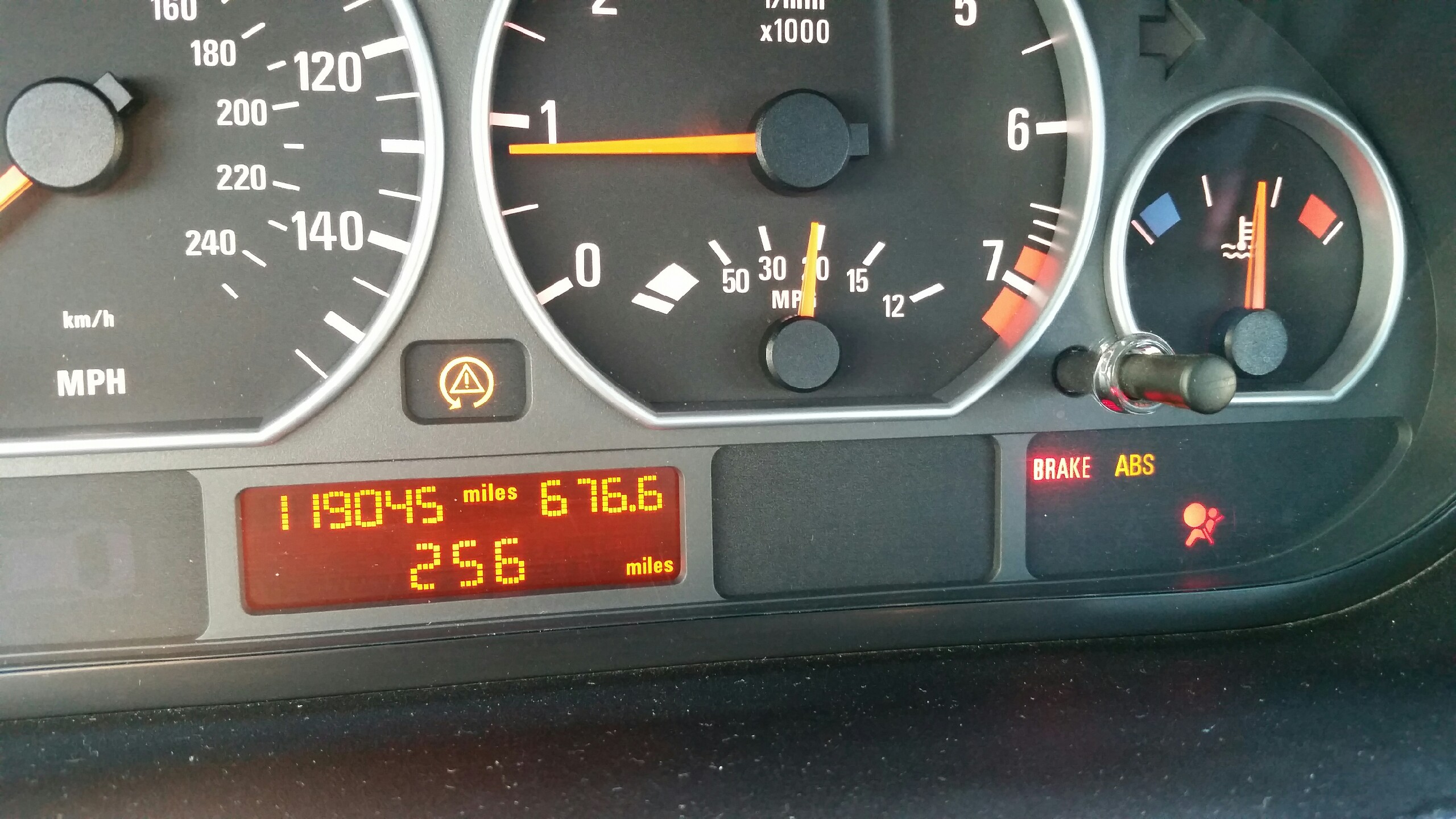

Attachment 27623
At first, radio stopped working. Odd but kept driving as I was two miles from the coffee shop I go to. Then ABS, Brake, Traction control lights come on. Yellow at first, then turn red. Airbag light came on next and the mpg needle got stuck at 20. Parked the car at the coffee shop and shut her down. Went to start it again and click click click click click. FUU
New alternator and voltage regulator so that isnt the issue. I unhooked the battery, grabbed a coffee, and chilled while caffeinating. Luckily for me, I broke down across the street from Irvine BMW and right next to another parts store, and next to the coffee shop (thank god).
Hooked up a jump started and the car is running again. Seems like the battery is the issue. New one will be ~$200. Waiting to see if I can get an OEM one, but if not, the parts store next to me has one.
