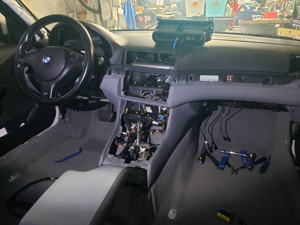

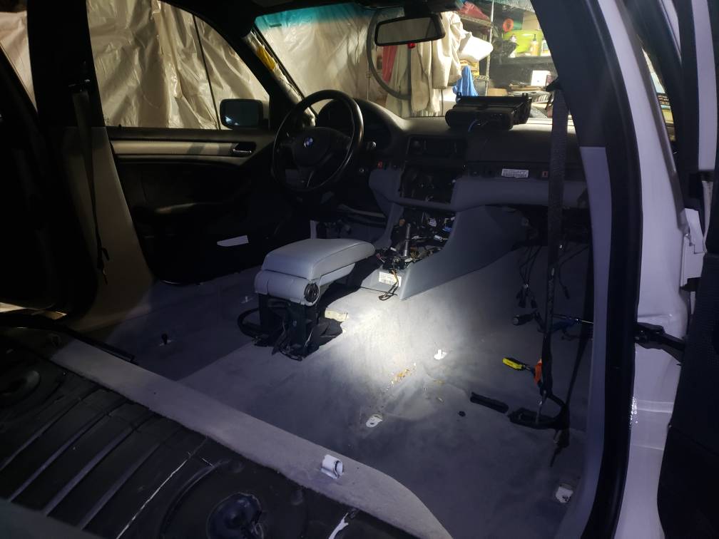

Today I finally started to pull my grey interior out.
Work that was done so far:
Removed seats
Removed central console and all plastic items
Removed glovebox
Removed armrest
Removed rear section of the carpet
Removed airbag on the passenger side
Surprisingly, I am seriously stuck with the steering wheel. Spring on the left side of wheel that needs to pushed in order to release airbag is stuck. I removed steering wheel multiple times in the past and very familiar with the process. I will continue to work on it tomorrow. Steering wheel significantly slowed me down as I was planning to remove everything today and start black dash, carpet and seats install tomorrow.
Well, battle will be resumed tomorrow. I have to remove steering wheel and all plastic around the column, pull out dash board and pull ot front section of the carpet. The goal for tomorrow is to install black dash and carpets and as much trim is possible. Let's hope I am not going to fight with the steering wheel for a long time.

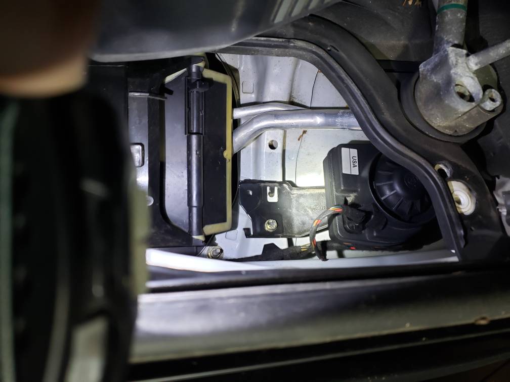

I forgot to mention that I also retrofitted OEM alarm today. Attachment 36071Attachment 36073Attachment 36074
