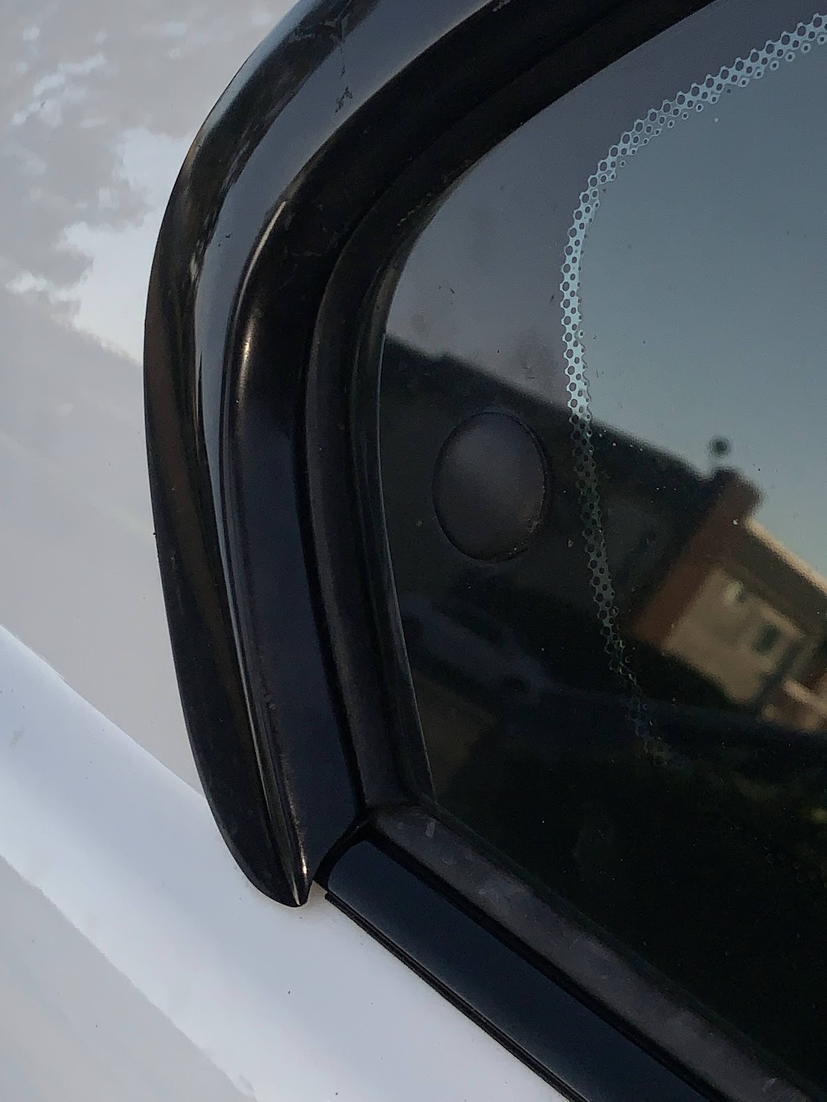

Oooooou thanks for the link to the weatherstripping. Mine is just starting to crack and I haven't been on the forums for a while so it's good to see that as an option!
It's the least I can do for you posting that ebay link. lol.
I haven't received mine yet, but the people on m3forums who has received theirs say the quality is good.
