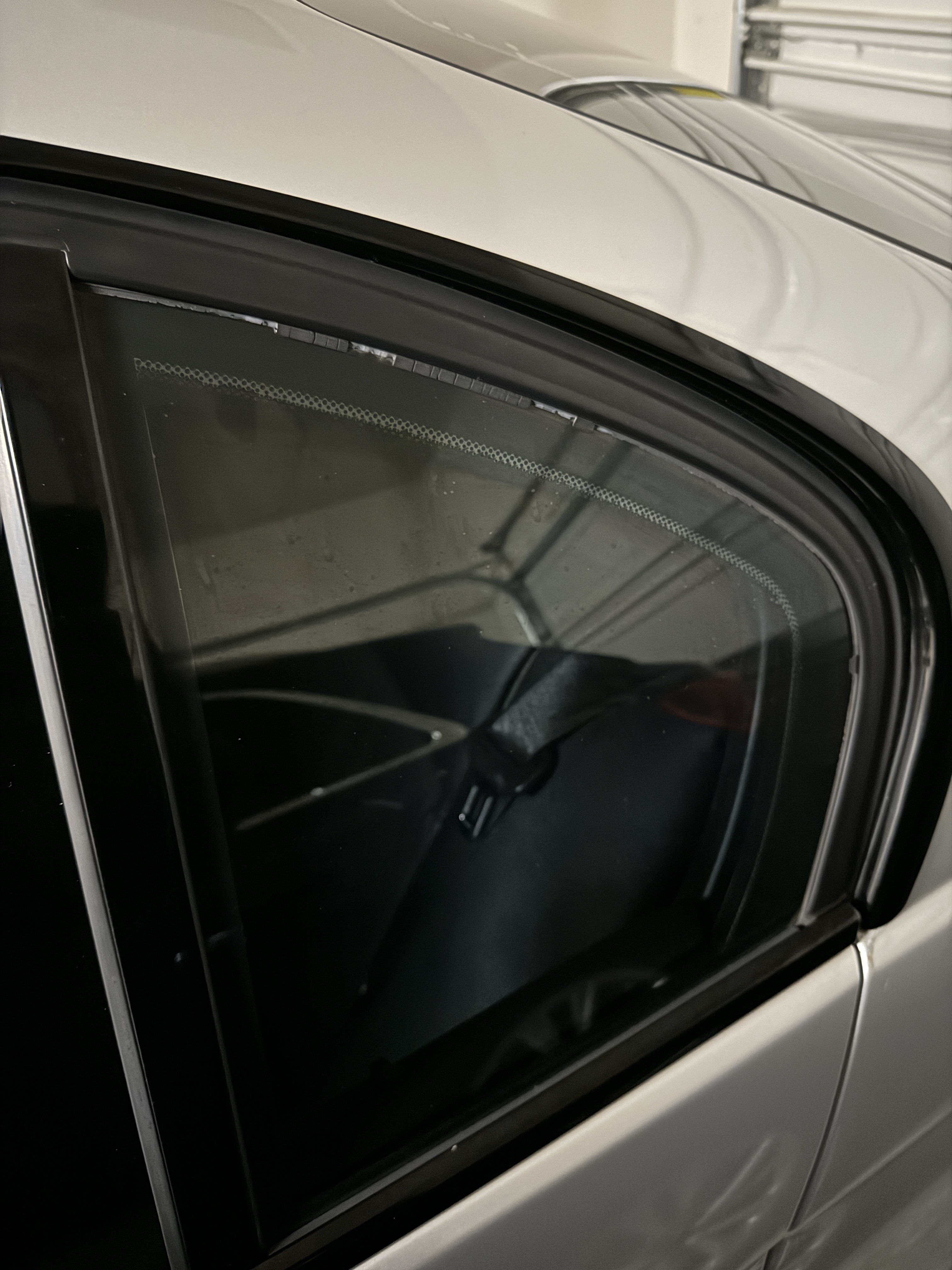

  9. #8199
    Oct 2016
    Atlanta/Macon, Georgia
    551
    Anyone have any insight, a DIY or just general advice on replacing the rear fixed glass seal on a sedan. It’s completely dry rotted and falling apart.
    I see it done on coupes but no info on sedans.
    Attached photo below. You can see the cracked rubber surrounding the window is like 98% missing. Name:  IMG_2589.jpg
