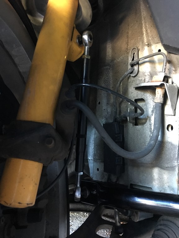

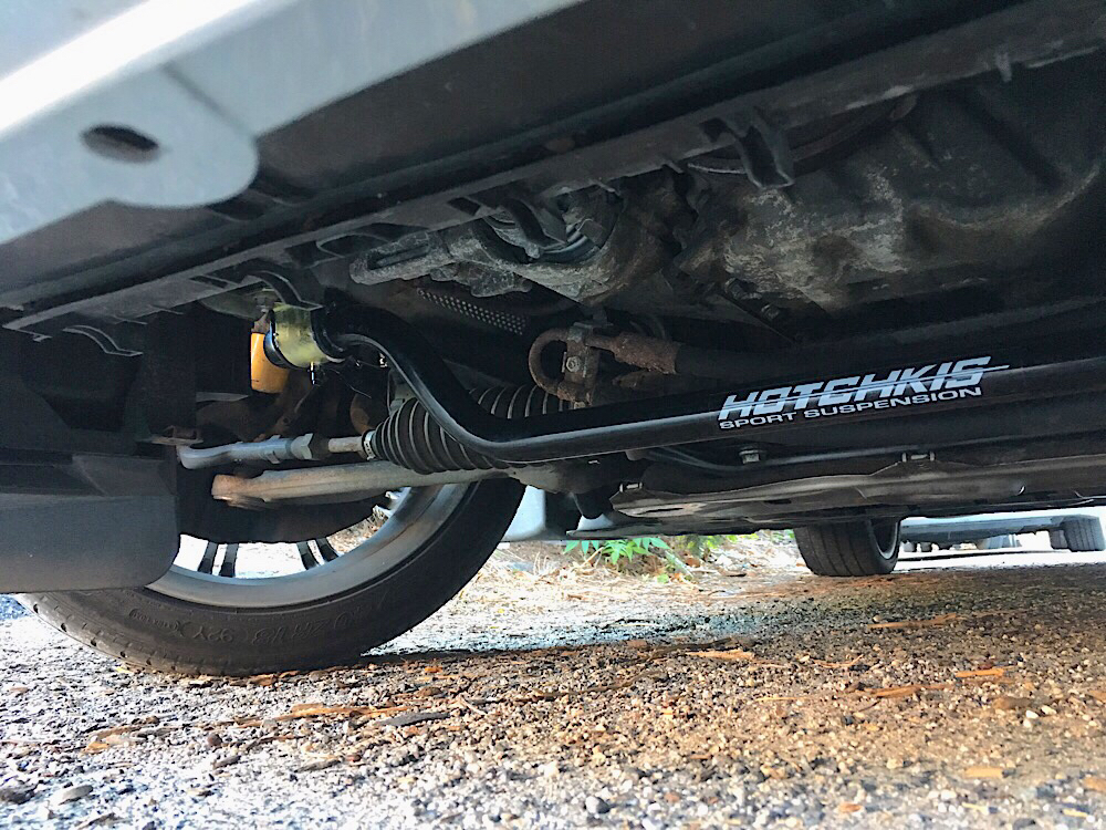

    Got the Hotchkis front bar and Bimmerworld adjustable endlinks installed...
    A friend of mine who knows E46's inside and out said he heard people with these bars have had the frame mounts fail when set on the stiffest setting and cornering aggressively... Anyone here experience this or hear the same kind of report? I've set it to the middle stiffness hole for the time being as I test out the balance with the rear bar (which is on the softer setting.)
  6. #5016
    May 2011
    Charleston SC
    6,149
    I know the rear rear sway bar mount are weak. I think Turner or bimmerwork sell a reinforcement for that but they need to be welded in
    H&R sport springs,
  7. #5017
    Dec 2016
    Boston, MA
    643
    The rear mounts actually come with a pretty hefty (maybe 1/4" or 3/8" thick) reinforcing plate which gets added to the back of the chassis bracket. This picks up the bottom hole, which doesn't exist on the oem bracket, and helps stiffen it. The front bar comes with a spacer to move the bar/ brackets down to clear the notch in the side of the frame, but doesn't reinforce the mount at all. In fact, it moves the bar 1/4" further away from the frame, and 1/4" further down on the bolts.
    I think my friend's anectdotal evidence suggests that the mount or screws pull out of the frame. Doesn't the M3 have the same type of mounts?

  9. #5019
    Dec 2016
    Boston, MA
    643
    Did a little digging, found a few instances of failures... The front bar mount weakness has apparently been an issue with some E46 M3's and base models with larger bars on full-stiff. Now I'm worried... Going to change to the softest setting until I can get someone to do a little welding.
