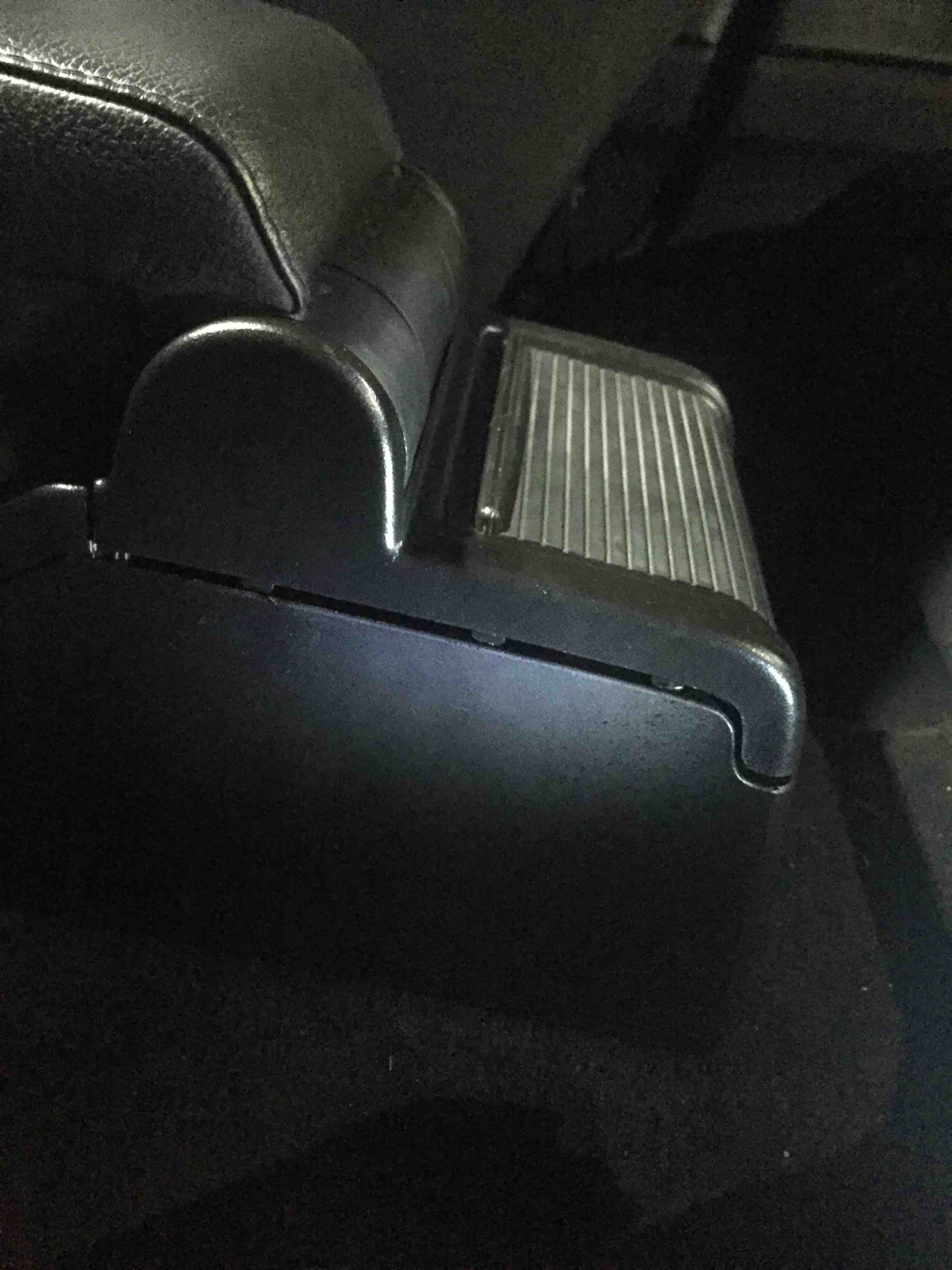

question for anyone who has taken apart the center console and put it back together for whatever reason (e.g. to refresh that peeling rubber mess):
Why is this happening? I put it back together and it seemed very straightforward. took it apart again to see if maybe something was getting the in the way. I cannot for the life of me figure out why this part won't fit back flush again.

I wish I could help, but the only time I took my armrest console apart was to remove it.

You just snap it in. The arm rest needs to be up a bit (like 45 degs or so) I believe as you push it down. You want to do it with the rear tray removed first though.

So my dumb ass put the screws in before putting the unattached piece in. Didn't go down all the way because the screws were in the way. Probelm solved.
