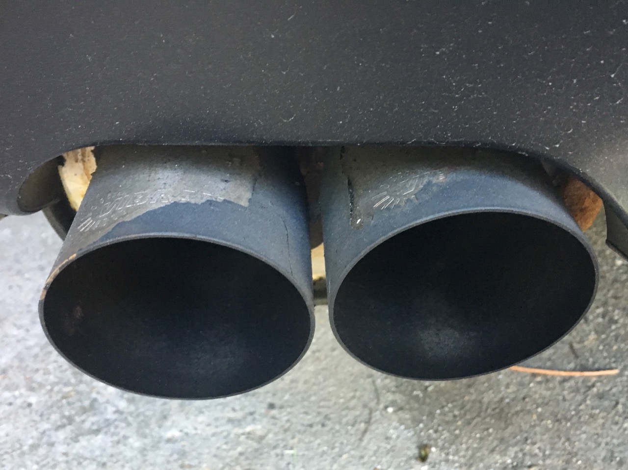

    Quote Originally Posted by YoitsTmac View Post
    Saw a little exhaust talk earlier and hope I can quickly revive that. I have a magniflow muffler but it’s just too quiet and more importantly, I lost my rasp. Adding insult to injury, my exhaust tips have cracks and what seems like burns. So I. Removing the muffler and putting some new tips in.
    I was wondering if anyone had a good exhaust tip recommendation or at least good vendors for my to browse. Thanks guys
    Reviving this, partly to ask a different question. I have a Vibrant 1148 muffler: the SS tip was finished black and the black coating quickly started failing. Vibrant was NO help. I'd like to either strip off the remaining black coating or cover the twin 3" tips with something else. Ideas?
