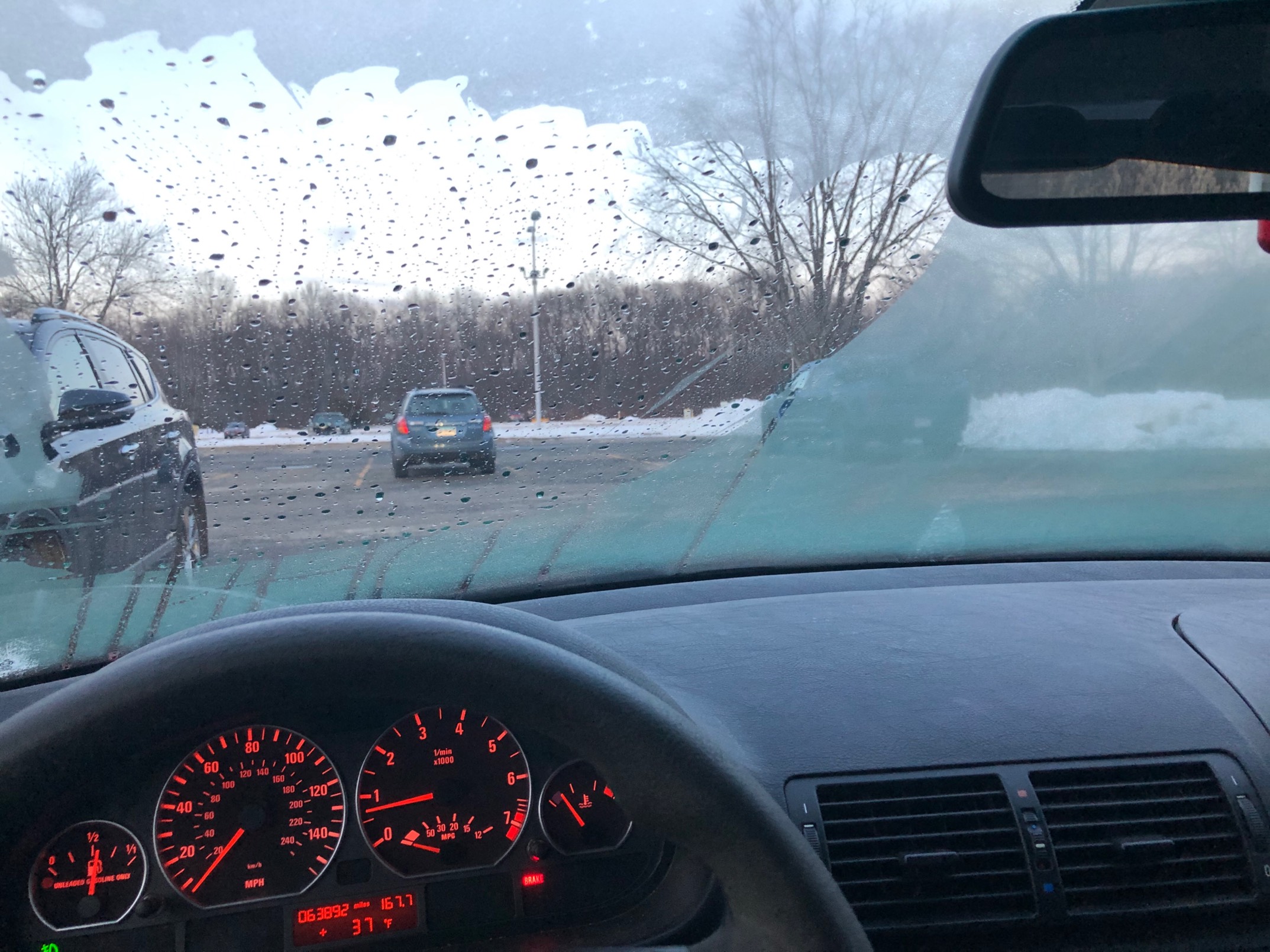

    Do i have a condensation problem in my zhp? Came out of the office on what was a beautiful, clear day to find my car really fogged up. Not wanting to wait for the defogger to do its thing, i decided to use my hand to wipe my side of the windshield and as i did that drops of water would splash onto the dashboard. Seems excessive water inside and it was a dry day as well.

    Quote Originally Posted by NYRhockey View Post
    Built up moisture in the floorboards from your boots?
  8. #7208
    Nope. Car had been garaged for over a week and it was a clear day with no rain.
    Leaking heater core is my bet then
