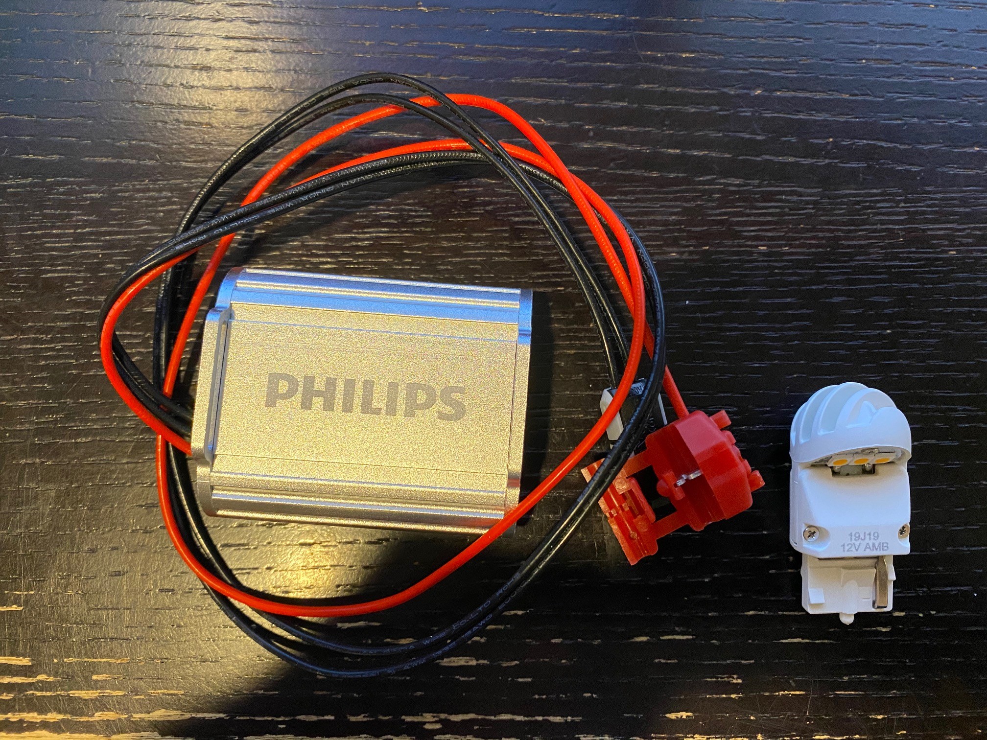

    So these Philips LED bulbs just came in... They have a large pack connected to them. Were yours like this? If so, where did you stick this thing?
  10. #7530
    Nov 2014
    Portland, OR
    10,252
    They did not include that...ballast? Regulator(s mount up)? I have no idea what that thing is.
