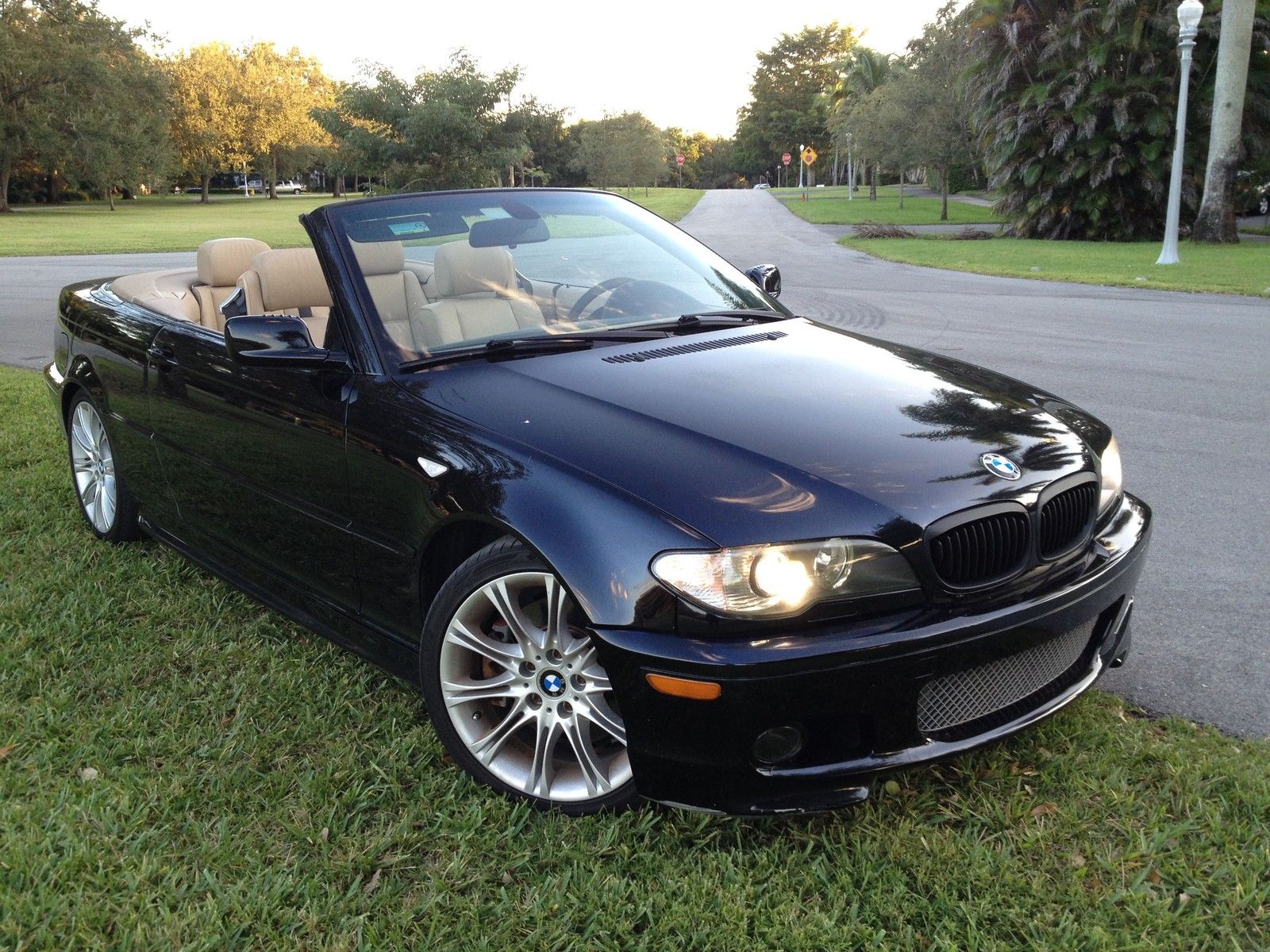

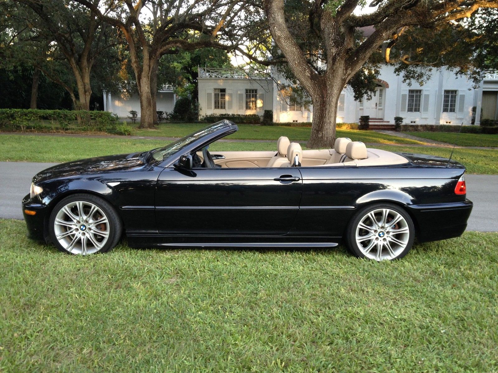

    Any and all help greatly appreciated. BTW - here's a couple pics of the car

    Beautiful car! (and house) Welcome. I'm sure someone here can help with your issues.

    Nice Slupe.

    Not my house - picture from PO :-)
