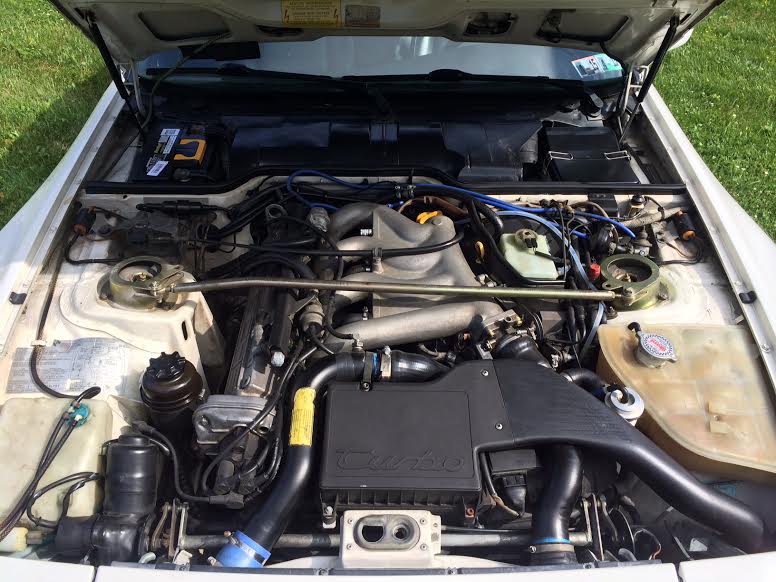

    More to come. Hopefully the parts I ordered from Pelican fix my current Oil consumption issue (About 1qt/2000mi).
