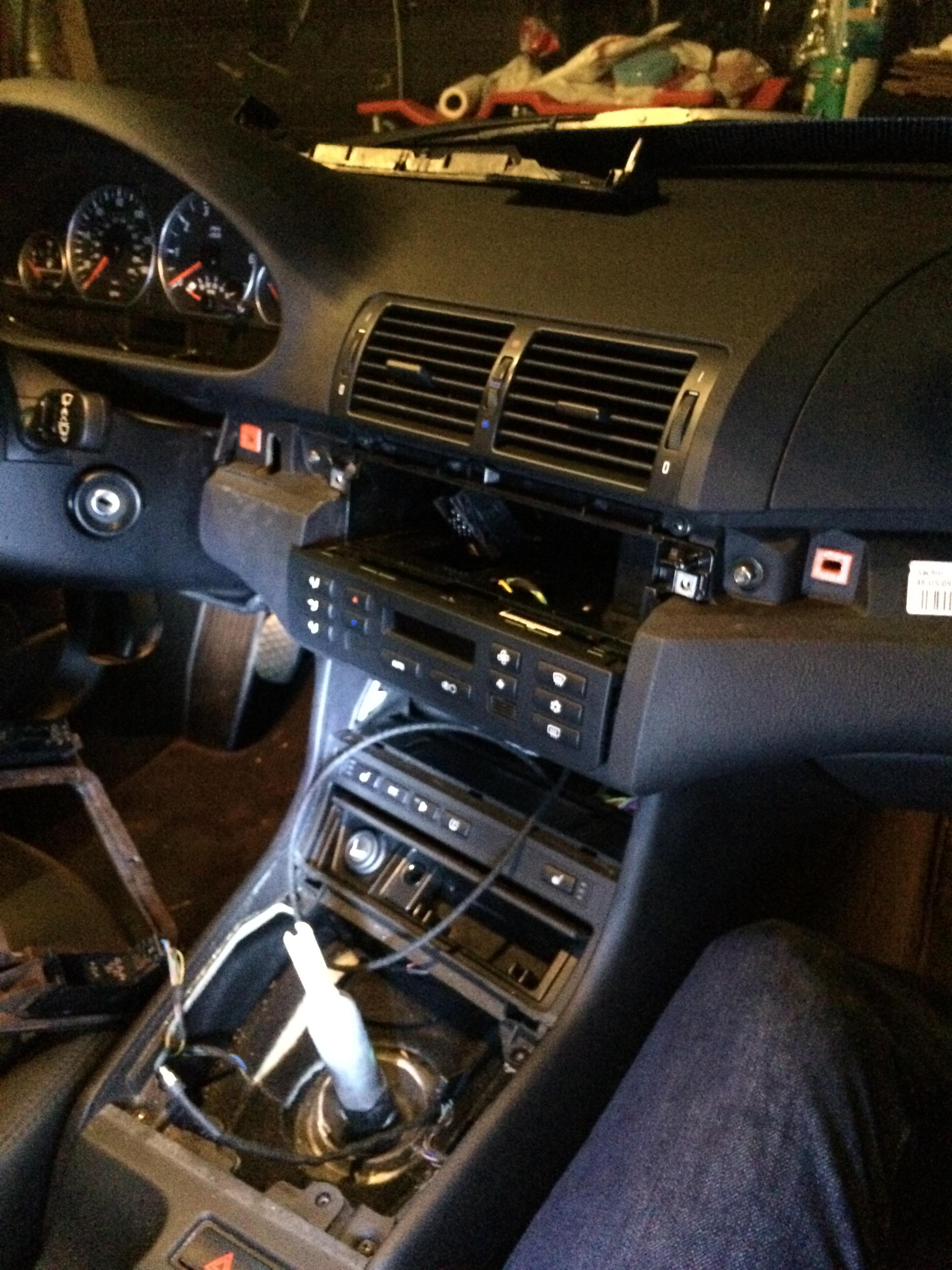

    In my previous car, the '03 330Ci, I installed the aux input (part no: 82110149389) in the extra container in the center console. I liked it since you could hide it away, but after several road trips with people in the back, I found it annoying that they couldn't play their music since the aux cable wasn't long enough to reach them. This time around I opted to install it by the rear cup holder. I think it is pretty inconspicuous since the arm rest hides it, it can now reach the rear passengers, and it's cheap to replace the cup holders if I want to relocate the aux port. I did scratch up the cup holder's material a little bit tightening town the nut, but decent otherwise.

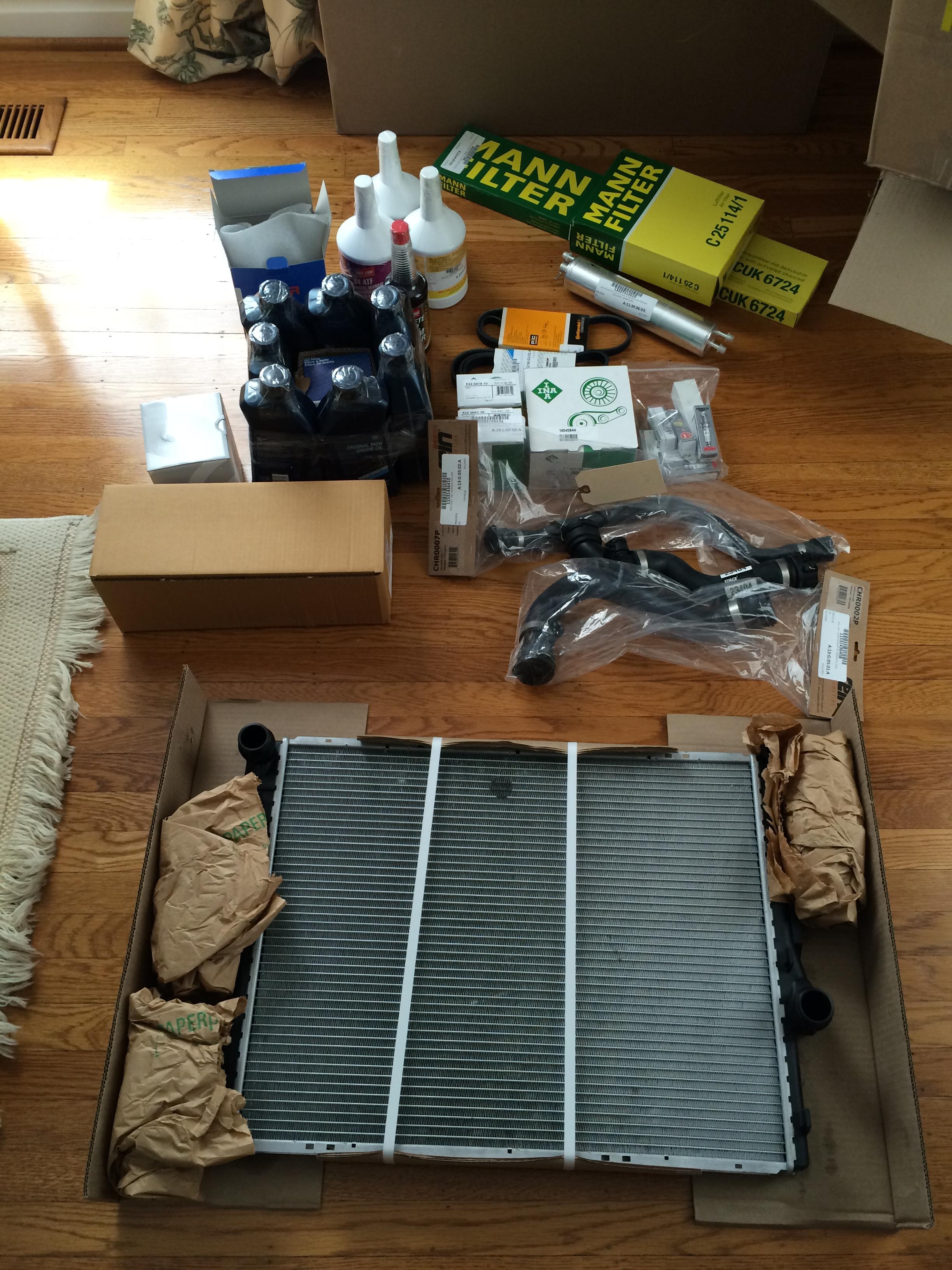

    Had to delete some posts to get them reordered. I received all of my goodies from Turner Motorsport, both their cooling system overhaul kit and their maintenance service kit (click on them for the link). Plan to knock it all out this weekend:

    I came down with a cold this weekend but got everything done except for bleeding the new coolant, replacing differential fluid (I broke my makeshift 14mm hex bolt/wrench, so I have to go buy one), and replacing the power steering fluid. Anyone have experience with PS fluid? I've never done it on an E46 before and most DIYs either have you 1. use a turkey baster to pull out the old fluid from the reservoir, pour in some new fluid, turn the steering wheel, and rinse and repeat until the fluid is relatively clear or 2. Release one of the hoses to the PS pump and let that drain then fill up the system with new fluid while turning the steering wheel back and forth to work out bubbles. I assume the second method is the preferred method to truly flush the system, but I'm hesitant.

    Who is that radiator made by?

    Portland, OR
    10,310
    Behr. It was actually slightly different than the one it replaced. The drain plug is a different fit than the original one, but everything else is the same.
    Any fitment issues? Thought on quality? Came with a new drain plug?

    I will say I had some issues getting everything back together, but I think that just comes with the territory. There were two differences I noticed on the radiator:
    1. In the original radiator there is a blue plastic philips screw drain plug that you remove that fits inside a plastic hex-looking housing. In the new radiator, there is no blue plastic philips screw, instead the whole hex-looking housing screws off instead.
    2. Where the mounting bracket for the expansion tank attaches to the radiator, there is a small hole near the drain plug that it nestles into just above the plug. In the original radiator this hole was hollow and the radiator drained in a narrow tube within this hole (kind of hard to describe). But in the new one, the hole is "sealed." Doesn't really affect fitment, just something different I noticed.
    Overall the quality seems the same. Both have the poor design of having plastic inlets. The one annoying thing is that you have transfer over the bottom plastic bracket from the old radiator to the new one (a new bracket wasn't included with the new radiator). To get it out without destroying the plastic bracket I had to bend and disfigure the old radiator a bit.
