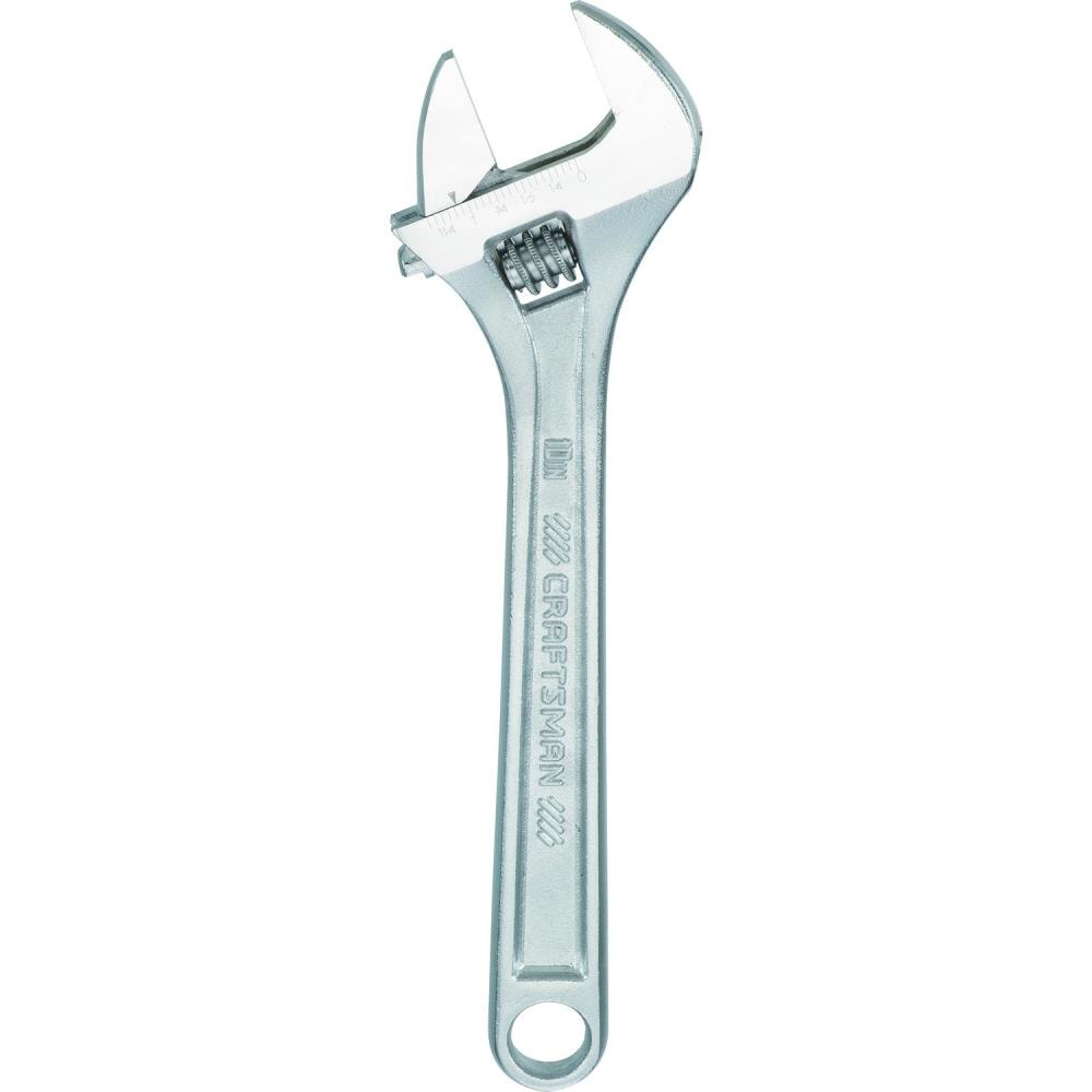

    Unfortunately, when trying to install some new end links (31356780847, LEMFÖRDER), I couldn't find (or only imagined I had) my thin set of wrenches so I couldn't tighten them down. I removed them and I'll leave it either for my mechanic or I'll buy a set of thin wrenches.
    I've been able to tighten it with a regular adjustable wrench. It will seem like you are damaging the rubber but it will be fine.
    Also for the transmission fluid let them put in Genuine BMW. I used it for 50k miles and when I drained it, it looked identical to the new fluid and had no visible wear or shavings. Shifted smoothly too, which can not be said of the Red Line stuff I have now.
    I was definitely doing damage to the rubber and I'd rather not pierce the rubber prematurely.
    Also, what's the part number for the normal transmission oil? I found 83222339219 and 83222339221 but don't know which. I'll happily try it.
    +1 about end links and using genuine bmw tranny fluid
    Interesting, just a normal ol' adjustable wrench?
    And which BMW part no. did you use for the transmission fluid?
