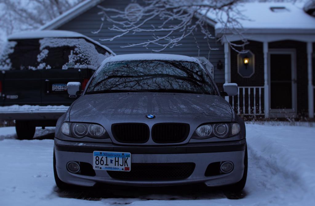

    Pics!

    18x9 ET 42 Apex EC-7's / BC Racing BR Type Coilovers / GruppeM Intake
    ECS SS Brake Lines / Coby Wheel Wrap w/ Tri-Stitch / 35% Tint / BavSound Stage 1 / Stett Intake Boots / OE Euro Clears
