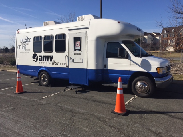

    Got the car registered and titled today - it was surprisingly convenient. Didn't have to go to slow full service DMV. Last year Virginia closed down the DMV select offices which were small offices that made this kind of work easy. But in 2017 they changed their approach to DMV to go. I drove to nearby Chantilly and got on the small bus and within 10 minutes I was done. They travel around from area to area within the state on a rotating basis - they can do the many of the same services that are done at the full-service offices, but no lines.
