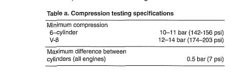

    Year: 2004 6 spd M/T
    Mileage: 250 000 Km
    Engine has been rebuilt from 0 and only clocks 25 000 Km
    Weight: 1500 Kg
    Dry Compression Tests: 11.5 Bar in all cylinders (above the minimum stated in manual, check the image below)
    The car is completely stock apart from the exhaust being de-catted and i have installed K&N filter in the stock airbox.

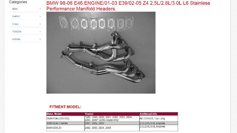

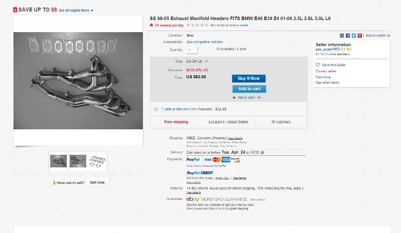

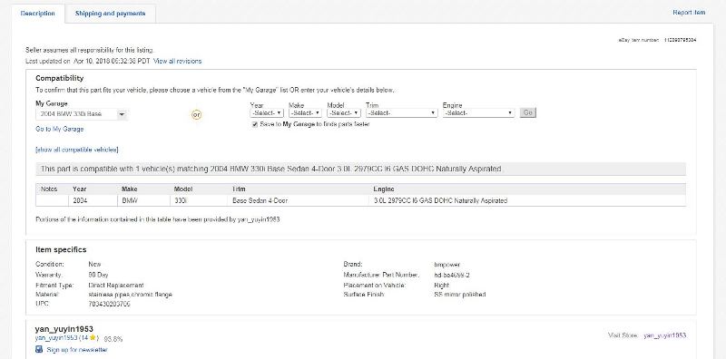

    After too many topics and reviews on what mods to first install i chose to start with headers as it gives the most power when comparing HP vs Money spent. I purchased ebay headers for a bargain price of 83$ They are made in china, so called supersprint replicas.
    (Link: https://www.ebay.com/itm/SS-98-05-Ex...-/112898795384)

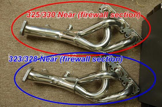

    Note that headers differ according models. 330/325 differ from 328/323. 330/325 is llonger with flanges rotated in different directions (check the picture)

    11.5 bar is actually a little on the low side compared to what others are getting... that's about what my car did on a compression test and I'm about 30-40 HP below what others with similar mods got on the Dyno. Doesn't mean there is anything wrong with your car though as long as all of the cylinder are around the same compression

    Yeap it is low comparing to others but when comparing to factory numbers it's quite high. Every car here that runs as a stock should do reads 10.5-11.5 bars. I just don't get it how they read that high numbers.
