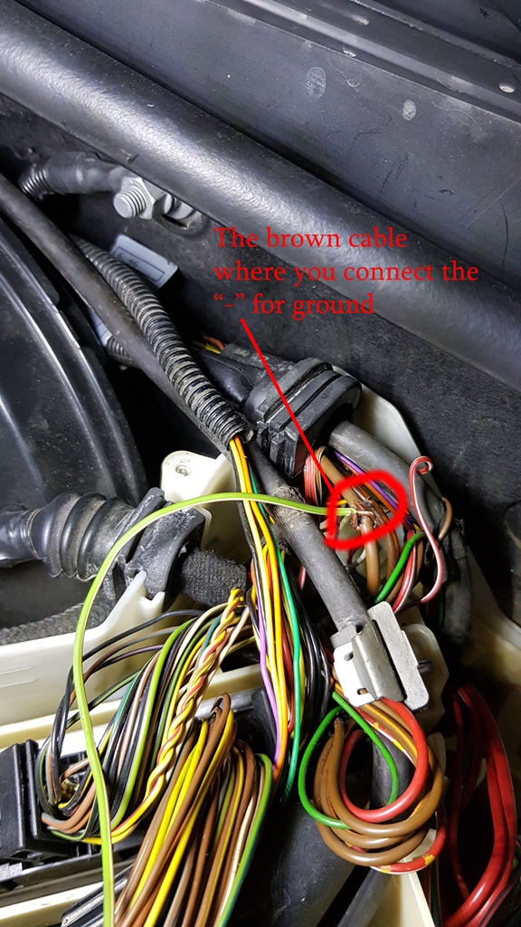

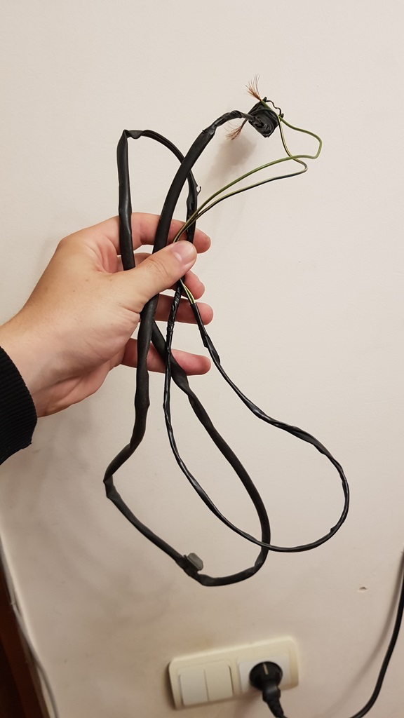

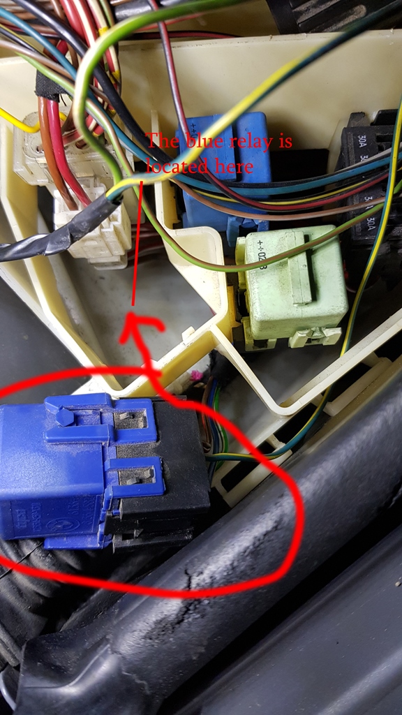

    ---Update---
    I have connected the manual gearbox to the ECU with a manual cable. I used the MS45 cable and inserted one cable into the ECU harness where the brown cable is located on the blue relay. I inserted into the brown cable behind the harness. As for the ground as you can see from the picture i have wired on the big black ground cable. After i did everything i found out that the blue relay has a ground on it. I don't exactly remember the wire numbers on the relay i think it was #6 and #2 (negative). The rear lights work, also the passenger mirror works when reversing.
    Notice: If you want the passenger mirror change position automatically when reversing you will need to flash the manual tune otherwise it won't work even though you have connected the gearbox cable to the DME
