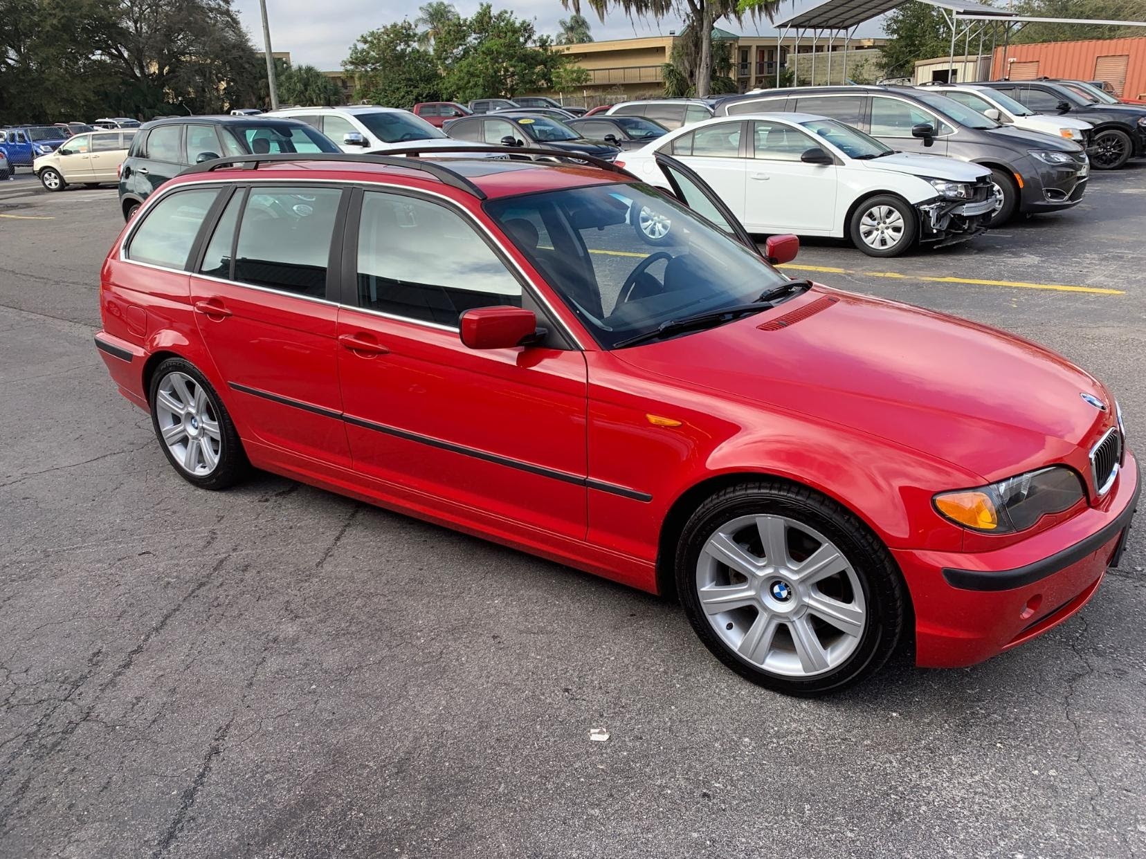

    Here it is at the dealer before it was loaded up:
    Name:  dealer pic 1.jpg
    Name:  dealer pic 2.jpg
    Name:  dealer pic 3.jpg
    Had the car shipped in an enclosed trailer, where it was loaded up the next Friday. I actually used Chris from Supreme Auto Imports (great guy to deal with) and the car arrived way quicker than expected. I was actually in Dallas that weekend, and I only beat the car back home by about two and a half hours. I meant to grab pics of it coming off the trailer, but there were 45-60 mph winds and it was about 30 degrees, so I wanted to get home ASAP. The car was unloaded about a mile from my house, and it actually came off with the left rear tire flat. I had to run home, borrow my neighbor's battery powered Ryobi handheld compressor (damn you Ridgid for not having anything similar), and then run back. Luckily, the tire held air and the drive was fairly uneventful. Here it is happily tucked away in my garage next to my '95 Impala SS:
    The body of the car is a 8.5-9/10, it's actually better than pics they sent me, I don't think it's ever had any sort of bodywork done on it. Got all four keys with it, and the owner's manual! The NAV unit has been swapped out for a Dynavin N7 with a crappy rear camera install (only seems to work when you slam the tailgate shut a few times.) The backlit buttons don't turn on, so I need to pull it out and splice the wiring according to a doc I found online. Don't know what I'm going to do about the rear camera. The pillars are peeling, as is normal, and the rear trunk carpet panel that clips into the tailgate has broken clips so it falls off when you close it. Other than that, the interior is pretty mint.

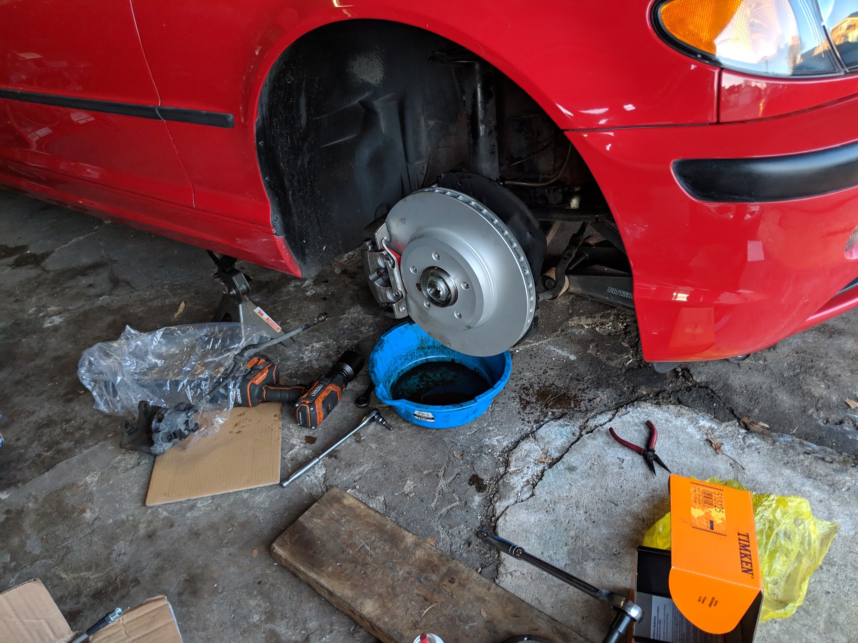

    As for what I did to the Touring for the past 2 days is:

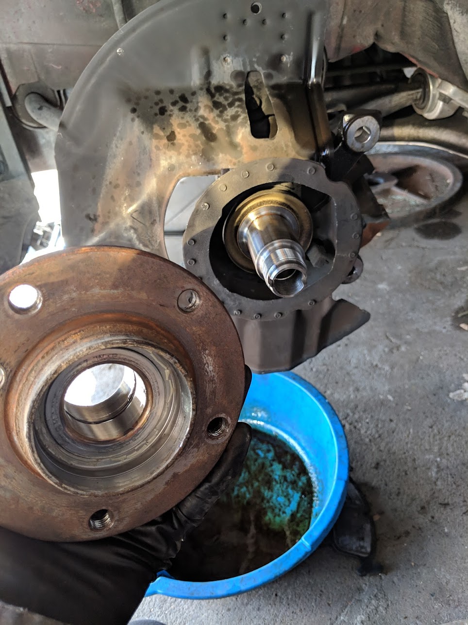

    1. Front wheel bearings. I slid the old ones off by hand, so they were definitely due.
    2. Next was the 330i brake upgrade. Meyle Coated rotors with EBC Red pads, and rebuilt calipers.
    3. Stainless steel brake lines since I was in there anyway.
    4. Steering Coupler.
    5. New external headlight gaskets/seals.
    6. Replaced the missing antenna on the back.
    7. Replaced the missing BMW logo on one of the center caps.
    (Very exciting stuff, I know.)

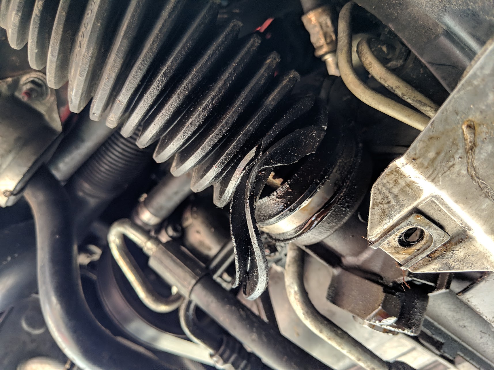

    The steering is way better, and finally has road feel without an inch of play. However, while I was under there, I noticed the tie rod boots were torn pretty badly on both sides. Also took a pry bar to the control arms, and noticed an ever-so-slight amount of movement, so it looks like I'm overhauling the front end a bit sooner than I was hoping to. I was going to do engine mounts soon anyway, so I'll knock it all out at once.

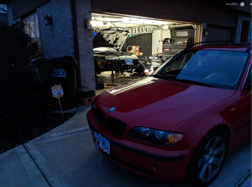

    The first weekend of April, my buddy informed he planned on completely overhauling his Supra's suspension (it's a MKIV) over the course of Friday afternoon and Saturday. We thought it would be totally feasible to replace all the control arms in the front and rear of the car with adjustable and rebuild-able units, along with installing some coilovers. (Spoilers: we didn't make it.)
    I drove home after work, grabbed a bunch of my tools (the trunk area of the wagon was full), and headed on over to start wrenching. This a New Jersey car with 165k miles, so we had our work cut out for us. The body's actually in amazing shape in terms of straightness and rust, but it has a crap paint job, which I am guessing was performed by the PO's high school aged kids. We fought with the front end for just about the whole afternoon and decently late into the night on Friday, and even had to whip out the propane torch. I don't care what anyone says, E46s are way easier to work on than Supras. Some of the design choices made by the design team at Toyota were just mind boggling. We were supposed to do sway bars also, but after taking a look at what the front would we require, we gave up and pushed that off until a later date.

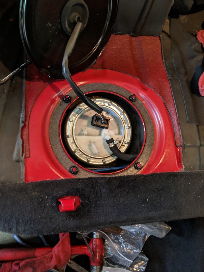

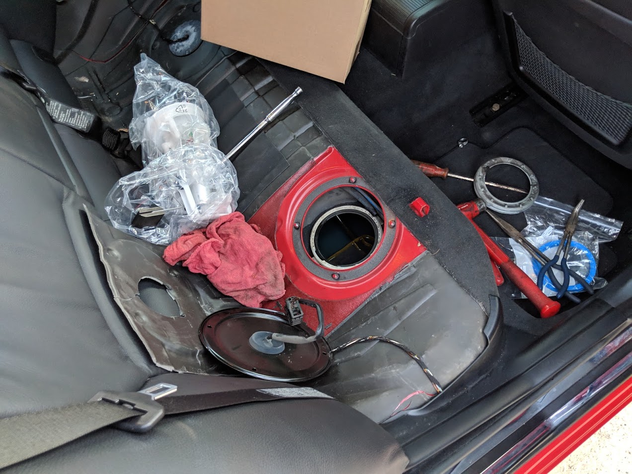

    Next piece of business was the fuel pump, also not hard. First piece of business was driving the car until the gas tank was nearly empty. I got it down to about a gallon left in the tank, I believe.
    After driving home from work on fumes, it was time to pull the pump. Overall, pretty easy job, just pop the rear seat off, peel back the insulation, unscrew the four bolts holding on the cover plate, and voila. I used the tried and true mallet and screwdriver method to take the lock ring off. I bought a new lock ring, new seal, and a new VDO/Siemens pump.
    Name:  fuel pump progress.jpg
    The old pump was definitely the original, but seems to be in good shape. It has gone into my ever-growing pile of spare parts.
    Name:  old fuel tank.jpg
    I installed the pump, seal, and lock ring, and fired the car up to check for leaks. Before putting the seat back, I drove it to the gas station to fill up. Man, it's loud without the cover, sound deadening, and seat installed.
