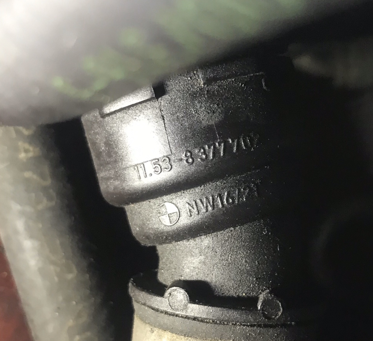

    Also, item 3a above, on my car shows part #11538377702, but when I search it on all of the parts sites, nothing shows up. Any ideas?

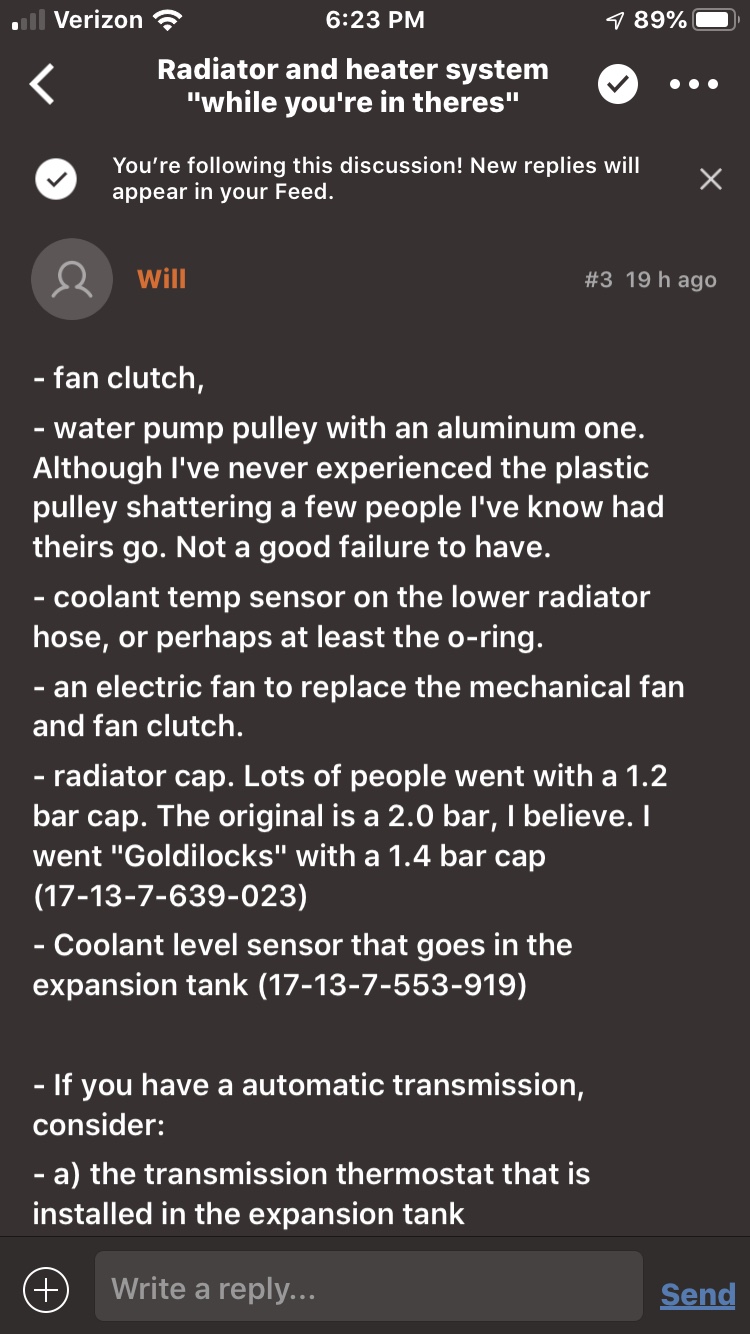

    Depending on the age of the components and your budget, you might want to consider changing:
    - fan clutch,
    - water pump pulley with an aluminum one. Although I've never experienced the plastic pulley shattering a few people I've know had theirs go. Not a good failure to have.
    - coolant temp sensor on the lower radiator hose, or perhaps at least the o-ring.
    - an electric fan to replace the mechanical fan and fan clutch.
    - radiator cap. Lots of people went with a 1.2 bar cap. The original is a 2.0 bar, I believe. I went "Goldilocks" with a 1.4 bar cap (17-13-7-639-023)
    - Coolant level sensor that goes in the expansion tank (17-13-7-553-919)
    - If you have a automatic transmission, consider:
    - a) the transmission thermostat that is installed in the expansion tank (17-11-1-437-362).
    - b) transmission cooler-to-mounting plate o-rings. (14.5 x 2.5, you need two).

    - Also, item 3a above, on my car shows part #11538377702, but when I search it on all of the parts sites, nothing shows up. Any ideas?
    Maybe 64-21-8-376-153

    If I look at your post on tapatalk, none of The stuff is there that I see on the web browser version.

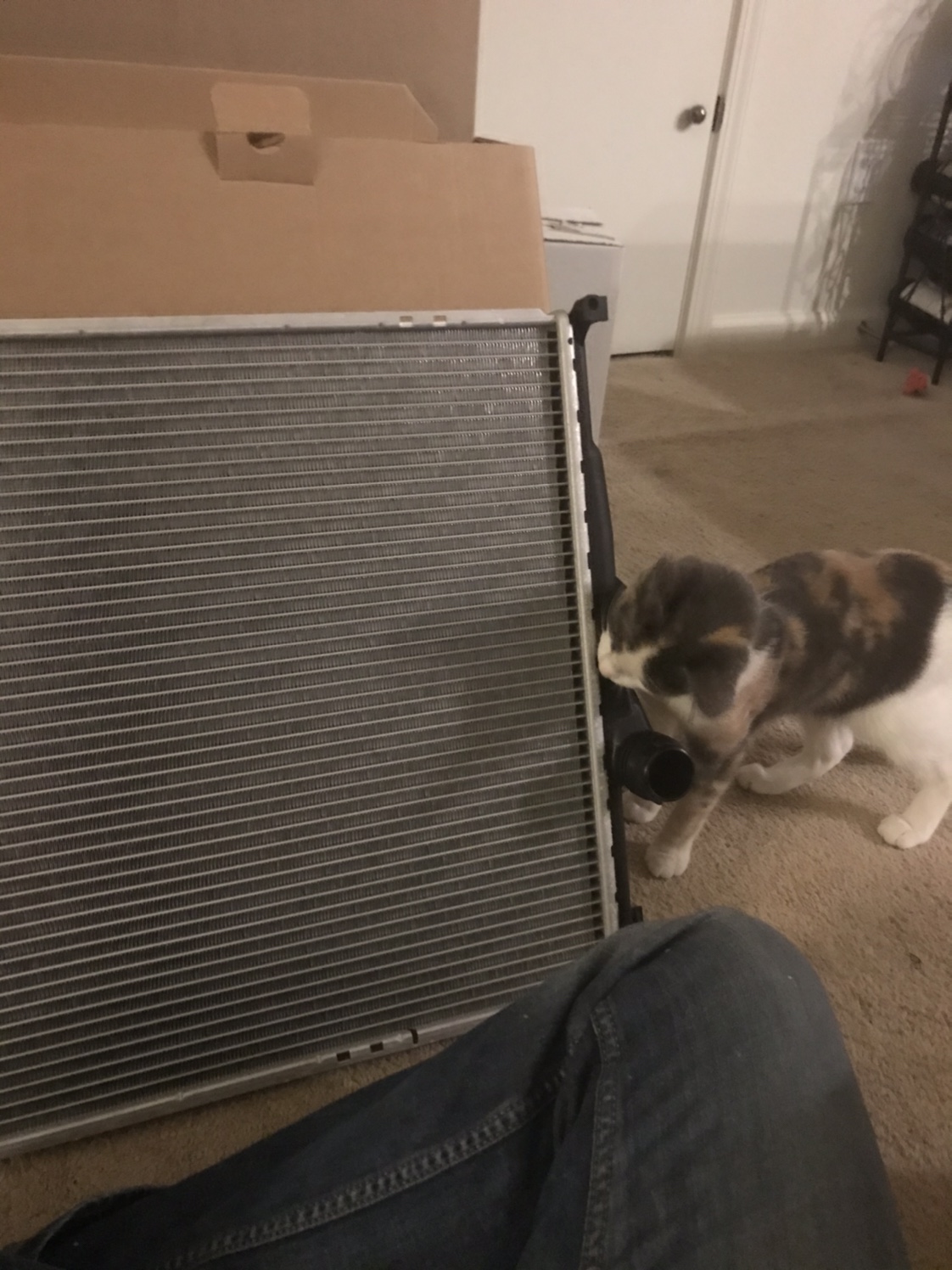

    Radiator time. Hoping to get to it Sunday.
    Kittens make terrible assistants when unpacking things.
    I skipped on the heater hoses this time. I’ll get them when I do the hard lines under the intake manifold.
