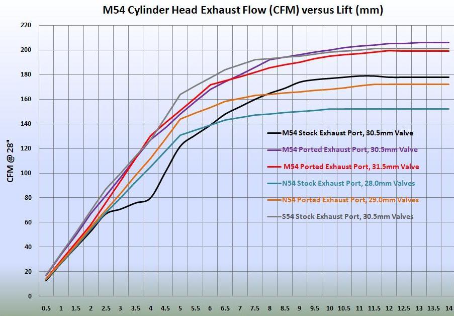

    With that being said, the exhaust port is the weakest link in the chain. It appears that some work here produces tremendous gains in flow across the board from low lift (2.5mm) to high lift (9.5mm). Almost 40 CFM difference in some spots! What that means for power in an N/A application, with stock ZHP cams is what I want to find out. I also need to figure out how to get those gains. Sure I could hog out the exhaust port, but that doesn't learn me anything about what I did and also increases the likelihood of me getting a new cylinder head.

    Ok, let's stick to exhaust a bit more. I posted a graph in the above post which shows an improvement in flow everywhere. Please don't read this like a dyno graph. Low lift flow is not equivalent to low end torque. The improvement should actually improve power across the entire RPM range, provided velocity didn't take a hit which I don't think it did since the stock ports flow so poorly. It can also be seen that larger exhaust valves hurt high lift flow, bigger is not always better!
    There is another graph that compares the S54 exhaust flow to the ported, stock sized valve M54 flow. The S54 edges it out in mid lift (4mm to 7.5mm), but otherwise the ported M54 meets or beats it. The S54, S50B30, and the S50B32 have the exact same outside diameter valve seat surface and exhaust valve size as the M54B30. I've hyperlinked the engine codes for convenient reference to newtis. The largest difference is in the intake size and seat width. The M54 has a 0.65mm and 0.45mm thicker seat on the Intake and Exhaust, respectively. There may be gains to made by reducing the seat width! Note that all of these engines have the exact same seat cut angles. BMW did a great job with the S54, so I won't waste time or energy to see if there is a better choice seat cut. We'll run with OEM specs here.
    Decision 1: Keep OEM Valve seat angles.
    Decision 2: Keep OEM exhaust valve size.
    "The flow of the exhaust valve is more critical from 0.100in (2.54mm) and up." Wait...go back and look at the graph, and then reread that sentence. Look at what happens exactly at 2.5mm of lift on the stock port M54.
    "Seat form...can measurably affect flow over the entire lift range for an exhaust port."
    "At low lift, the flow is entirely dependent on the size of the gap between the valve seat, the seat in the head, and the efficiency with which they flow."
    I'm wondering how much of a difference narrowing the seat width to S54 specs would do by itself? Maybe it'll give 70-80% of the results? Not sure but the final decision of where and how much to grind away at the exhaust port needs to be made. That could be a bunch of trial and error, but looking at the CFM chart, it looks like the throat and port could be opened up just a little with some blending.
