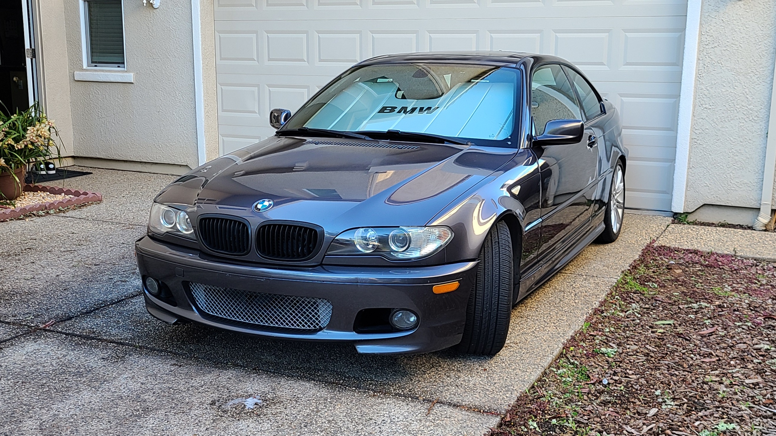

    My mechanic friend took a look at the wiring and was able to cut and solder everything back into the OEM radio harness, but i found even more bad news. The previous owner spliced his own wiring to the speakers, so even though the wiring to the radio was fixed, there are completely separate wires running to the speakers. We took a look in the trunk, and the amplifier, bracket for it, and the radio tuner computer were gone, and the wires and harness leading to them were messed up also. I forgot to mention in my first post that the subwoofers and their housing have been taken out by the previous owner.
    Basically, my friend fixed the wiring to the radio, but couldn't do more because of limited time, so i have to go back in the future to fix the wiring from the radio to the speakers. I also have to get an OEM H/K amplifier/bracket and radio tuner computer for the radio to work. And get the OEM subwoofers/enclosure/amp.
    My friend also temporarily fixed the AC issue! it feels sooo nice to have good working AC. My friend used the strongest bonding tape he had in the shop, and walled up the part that the previous owner cut out to fit the radio. That simple fix restored all functionality of the AC system. It seems like the whole system runs by the air pressure inside the core, and now that it's been restored, everything works. Before, the climate control didn't change the direction of air from window/face/feet/front defrost. Now that the tape is holding the air in, i can hear the motors in the AC core working, opening channels and changing the direction of air when i press the modes on the climate control. Even the front defrost works now! All thanks to tape! But i know this fix is only temporary. The summer heat could wear out the glue on the tape, or if it lasts until winter, blowing heat through the AC in the winter could wear out the glue, and i'll have to redo the patch. My mechanic friend told me he could cut some plastic panels and seal the core with urethane and it might do the trick, or install another AC core into my car. But that would be very expensive for the labor to take out the whole dashboard for this fix. He said that wouldn't cost any less than $1k. still, im happy having AC and i'll cross that bridge when i get there.
    While at my friend's shop i also replaced my car's brakes. I bought StopTech sport brake pads front and rear, and StopTech stainless steel brake lines. Over a month ago i ordered StopTech slotted rotors for my car, but they were delayed in shipping three times. After waiting a month for the rotors to be shipped, i canceled the order and asked my friend to order rotors for me. He doesn't have StopTech available to him, but he got me Zimmerman drilled rotors instead. I wish i could have gotten a full StopTech setup, but my rotors had formed a lip on the outside edge and i didn't want to drive with them any longer. I had the rotors, pads, and lines installed a week ago and they feel so nice.
    Looking at the damage behind the radio really made me appreciate all that goes into building a car. I saw that anything is fixable if you know how it works. I fixed most of the issues on my car already, and just because the last few are more expensive doesn't mean they're impossible for me. I'm feeling as good about my car now as i did the day i first saw it. I'm definitely going to keep it and fix everything up, and improve it in a few ways.

    The second issue is the AC. The AC doesn't blow very hard, only when i turn the fan speed up to the last 3 settings does the air current reach me. The side vents barely blow air at all, even on the high settings. Even weirder, if i close the air vents and turn the fan speed high, air will blow out from the dashboard, in between the gaps of the radio/hvac and storage compartments. The front windshield defrost also doesn't work. If i press the front defrost button, the vents on the back of the dash don't work, instead, it just turns the fan speed on max for the front facing vents. The AC does blow cold air, but it doesn't blow heat well. It doesn't blow hot unless i turn the climate control above 80°F at normal engine temperature, and then the heat "runs out" after 15 minutes unless i turn the temperature up higher.
    Sounds like maybe that could be a faulty Final Stage Unit (FSU). When mine went out the lower fan speeds wouldn't work, and at times it would change speed on it's own. You could also have an issue with the baffle that moves to push the air the the different vents when selected.
    The heat issue could also be the FSU, or a thermostat, or the Heater Core Temperature Sensor. I was not getting any hot water to the heater core, so I unplugged my heater core valve and bam...I had heat and plenty of it. Turns out the temp sensor was bad, and causing the valve to stay shut. If both of those are good, and the heat just cuts out when you speed up, then you may have a thermostat that isn't closing all the way.

    Here's the earliest photos i have of my car:
    https://www.flickr.com/photos/188540.../shares/M8eX7z
    Here are the photos of the damage from the accident:
    https://www.flickr.com/photos/188540.../shares/2916kz
    Here are current photos of my car just before i went to replaced the brakes:
    https://www.flickr.com/photos/188540.../shares/SUD0gd
    The are surrounding the door handle is like that because the "friend" who "fixed" the dents in the door and fender took out the handle and didn't put it back when he gave me my car back. The key's battery died, and i didn't want to pay $260 for a new key at the dealership, and i was afraid of messing anything up if i attempted to replace the battery, so i had to get in by unlocking manually. When i got my car back, the guy showed me that i can stick my finger in the gap of the door where the handle goes in, and pull a lever in there to open the door. He told me he didn't put the handle back in because the stick key lock's cover is missing, and to find one and paint it before i put the handle back in, and that it just snaps back in when i want to put it back. I found a cover, painted it, and tried to put it back in but i didn't know there was a screw to hold the handle in, i thought i was doing something wrong, so until i could find it out, i put duct tape over the opening so nothing could get in. I left the tape on there for months, getting in my car by putting the stick key in, and holding unlock so the windows roll down enough to stick my arm in and open the door from the inside. now that i figured out that the carrier was busted and fixed it months after, the residue of the tape stayed on and won't come off.
    And finally, here are photos of the damage the previous owner made behind the radio to install their unit:
    https://www.flickr.com/photos/188540.../shares/K797gp
