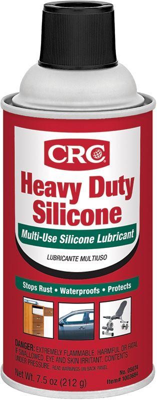

    802
    Quote Originally Posted by Dathaeus View Post
    Any silicone or.... I think if I went to home depot they gave like ten different kinds...
    PB Blaster, Liquid Wrench, 3M - they all work.

    Quote Originally Posted by John in VA View Post
    LOL even have a picture of a car window on the product
    Thanks!

    I assumed you just spray it along the edges of the windows only, and not the whole window overall

    I lower the window & spray it into the rubber (or fabric, depending on the car) weatherstrip channel as deep into the door as possible. Run the window up/down a few times; repeat as necessary.
