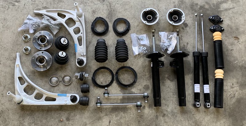

    My suspension was refreshed 5 months ago with Sachs. I'm very happy with the results. You can see the new parts here, shocks and struts have white labels.
    2005 IR / black / 6MT
    159,000 miles

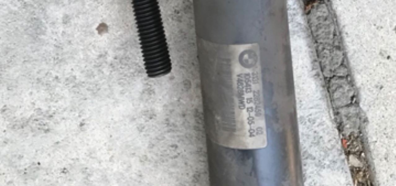

    From my research, the ZHP came from the factory with these shocks & struts:
    31312282459 = Left front
    31312282460 = Right front
    33522282461 = Rear (x2)
    Maybe someone on original suspension can confirm. Mine was refreshed earlier this year.
    Those are the BMW part numbers that take me to the standard sport package shocks. Would be interesting to know the actual manufacturer part number.
    Mafia member d-rod posted this pic when he replaced the OE struts. The P/N is 31312282459 with prod date 12-05-04. Now I'm sure the ZHP shares struts with standard sport package. Original pic is in post #50.
    http://www.zhpmafia.com/forums/showt...Imola-sedan-DD
    159,000 miles
