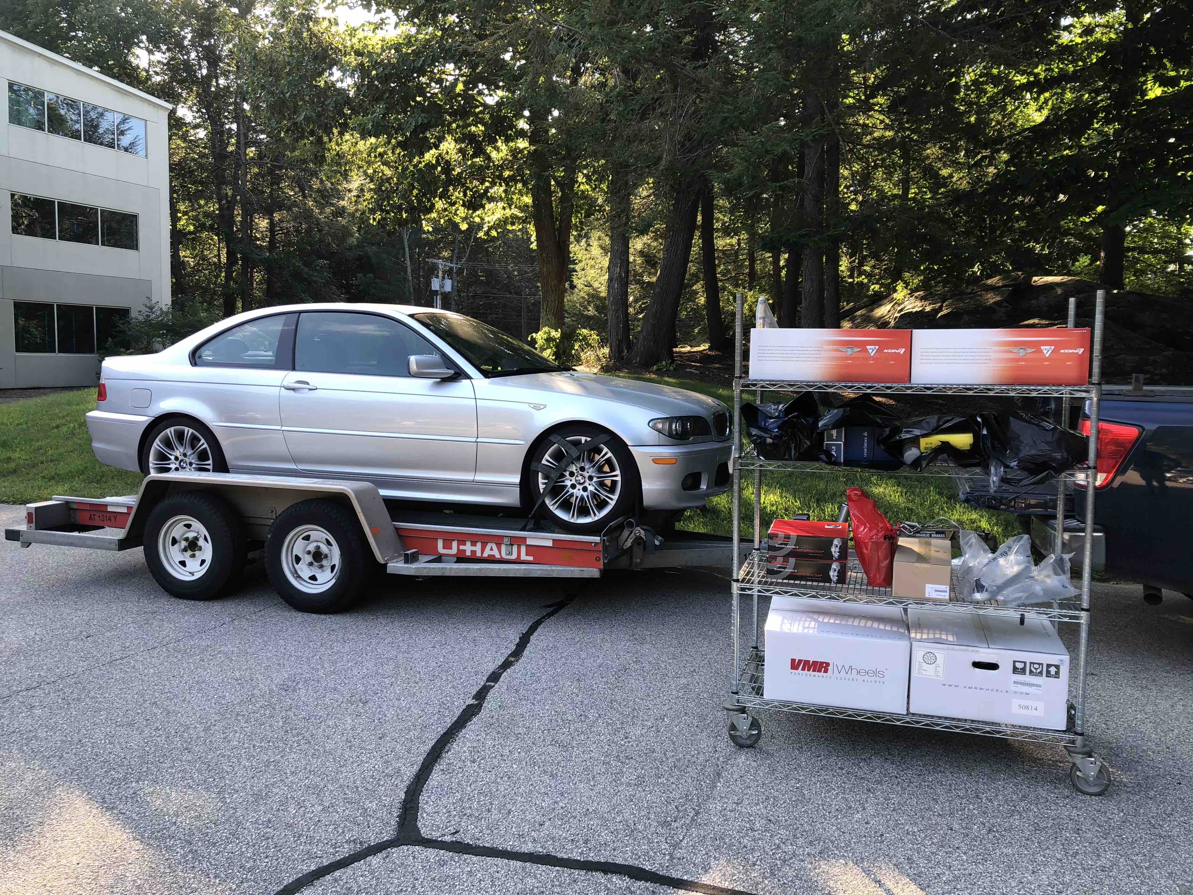

    First thing I did after purchase was replace all fluids, including tranny and diff, and replaced the fuel filter. Plus a long list of standard maintenance stuff. Also, all new brakes, front control arms, poly FCAB, M3 RTABs, and Koni suspension. See the pic where I stopped at BavAuto (RIP) on my way home with the car after purchase.
