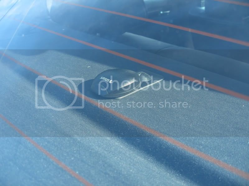

    Looks great Charlie. Assuming you dont have the rear window tinted, this is my preferred antenna location:
  10. #430
    Quote Originally Posted by sna77 View Post
    Thanks Steve! I'm going to mount mine in the same location once I get a new antenna. On my M3, that is exactly where my SIRIUS antenna is mounted
