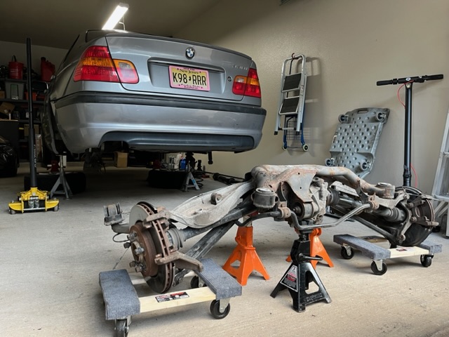

  10. #40
    Apr 2012
    Waco, TX
    71
    Wow, an update! You already know what’s happening. Subframe and RTA pocket reinforcement time.
