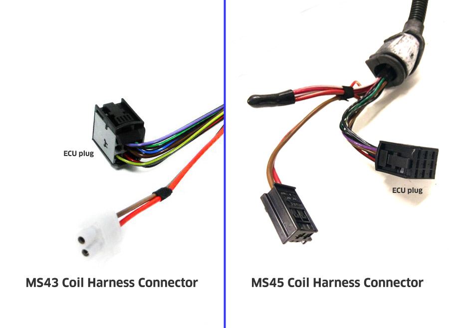

Coil Pack harness (harness 3) - from e-box, across top of engine with the power wire, to the coils. Its best if you get this from a Jan 03 - Sep 03 rwd car, or a 2003-2006 XI, as these were MS43 but used pencil coils. You can use your stock MS45 pencil coil harness but you will have to repin the DME connector and splice on a different terminal connector as shown in this photo

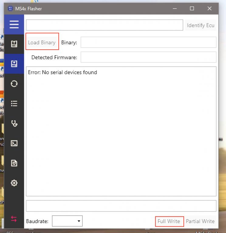

Open up the flasher tool
Go to the website and activate it to get your license file (free, not sure why they make you do this)
Close the flasher tool
Connect to your car. Open up INPA to make sure you are connected (two black dots showing on the home screen)
Close INPA, open up the flasher tool. the DME should be recognized as MS43 immediately.
Click the third icon on the left side (the disc with a down arrow) and "load binary". Select your modified file. The tool should identify it as a MS43 00069 firmware file.
Click "Full write" and wait as it flashes the DME.
Turn the key off as instructed after it completes.
