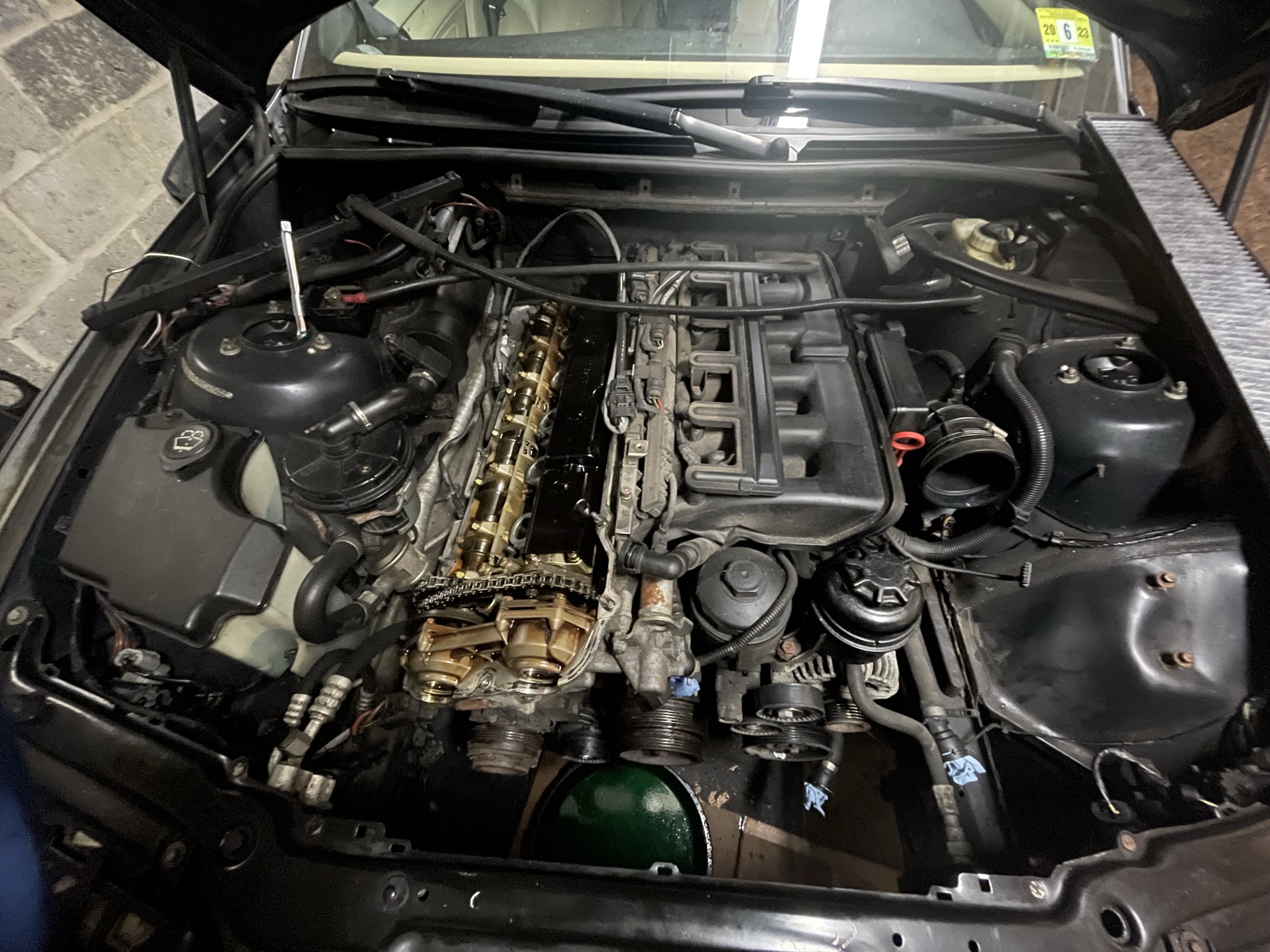

    Finally got started on the car. Been putting off working on it for months, mostly due to being busy and getting cold feet, this is the first time Ive ever worked on a car besides changing fluids/very basic stuff. Got a low coolant light the other day while driving back from a 6 hour round trip drive. It looks like pressure was building up and spraying from the cap. I put on the german auto solutions cap temporarily and that slowed the leak down. It would leak again if I drove hard.
    Decided it was time to start working on it. I work remote for now and when I do go in I take the bus so I can afford to have it off the road for a few days even weeks.
    Going to do everything in the engine bay that I have the parts for, this includes:
    M56 Valve Cover Swap/CCV delete
    Spark plugs
    Expansion Tank
    Radiator + Hoses
    Thermostat
    Water pump
    pulleys + tensioners
    Belts
    Intake Boots
    Throttle Body and ICV gaskets
    GAS DISA rebuild kit
    Power steering reservoir
    Oil filter housing gasket (viton)
    Voltage regulator
    New Aftermarket Intake (Injen)
    It's a lot to be doing at once but I figure I only have to take this stuff apart once if I do it all at the same time.
    So far I have taken apart almost everything.
    This is while I taking stuff apart, cooling system gutted, valve cover off
    Some reddish deposit in the back, engine has 196k miles. Will start using Rotella with the coming oil changes and do some engine flushes, maybe itll help.
    CCV deleted, throttle body/disa/icv/dipstick off, also lots of oil by OFG.
    I didn't take too many pictures so far because I was really focused on taking everything apart, and swearing. Notes so far on my first go around:
    -Lots of swear words and lower back pain, even though I jacked up the front of the car a little bit with wheel cribs.
    -The CCV was a total PITA even though I wasnt planning on keeping the thing. Glad to be getting rid of it.
    -There's coolant and oil everywhere.
    -The oil filter housing gasket is leaking a crap ton of oil, going to go in with some brake cleaner and clean everything up. Also looked like the dipstick ccv hose was leaking oil. I have a huge puddle of oil under my car, hoping its just a combo of ccv/OFG and not the oil pan. Valve cover gasket looked pretty new.
    -I am very grateful for youtube videos
    Will post more updates and pics as the car comes together.
