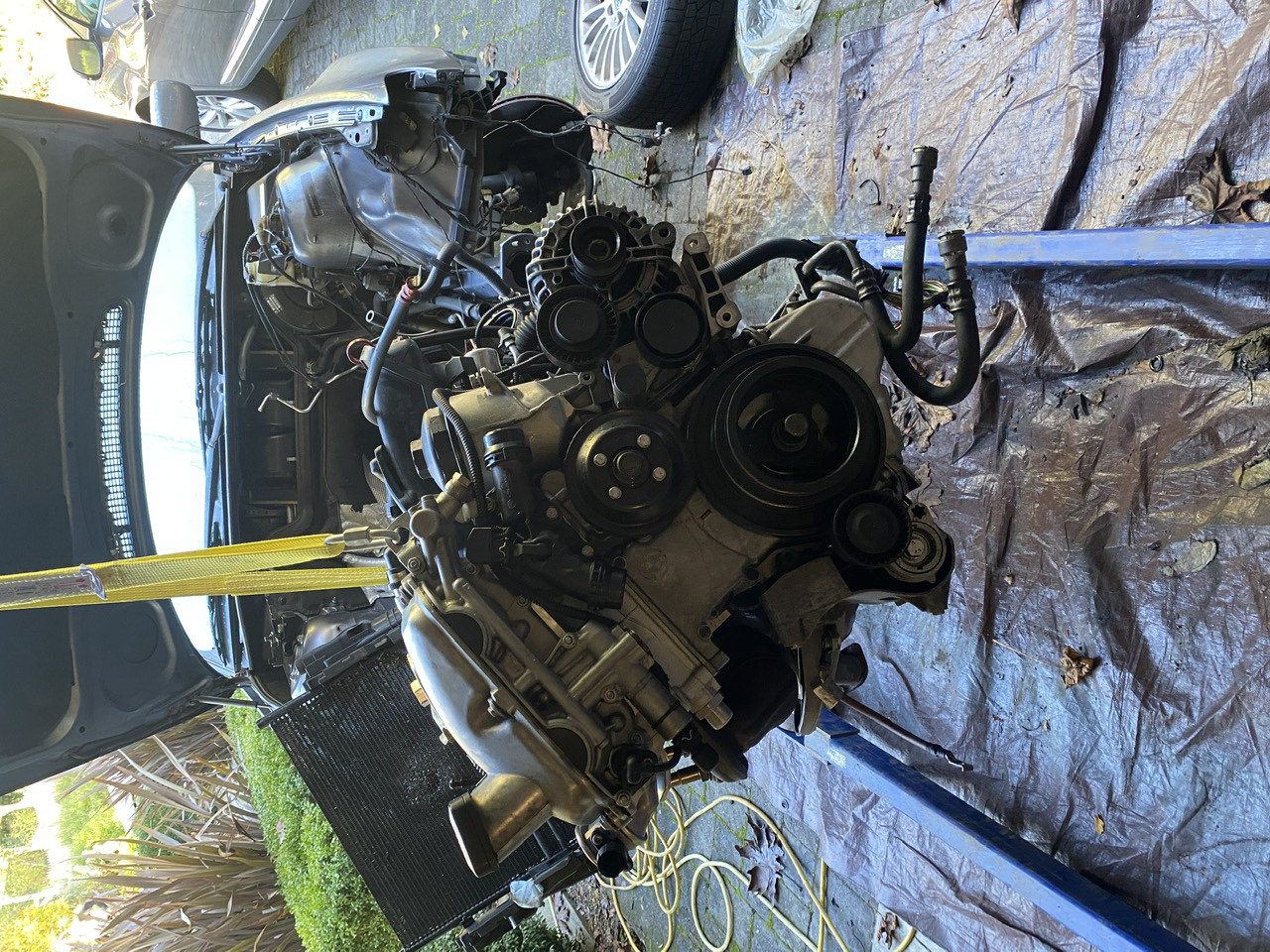

    This week a ZHP engine is going in - I rebuilt it including replacing the oil control rings with m52 and replacing head gasket, bearings, etc and redoing the head.
