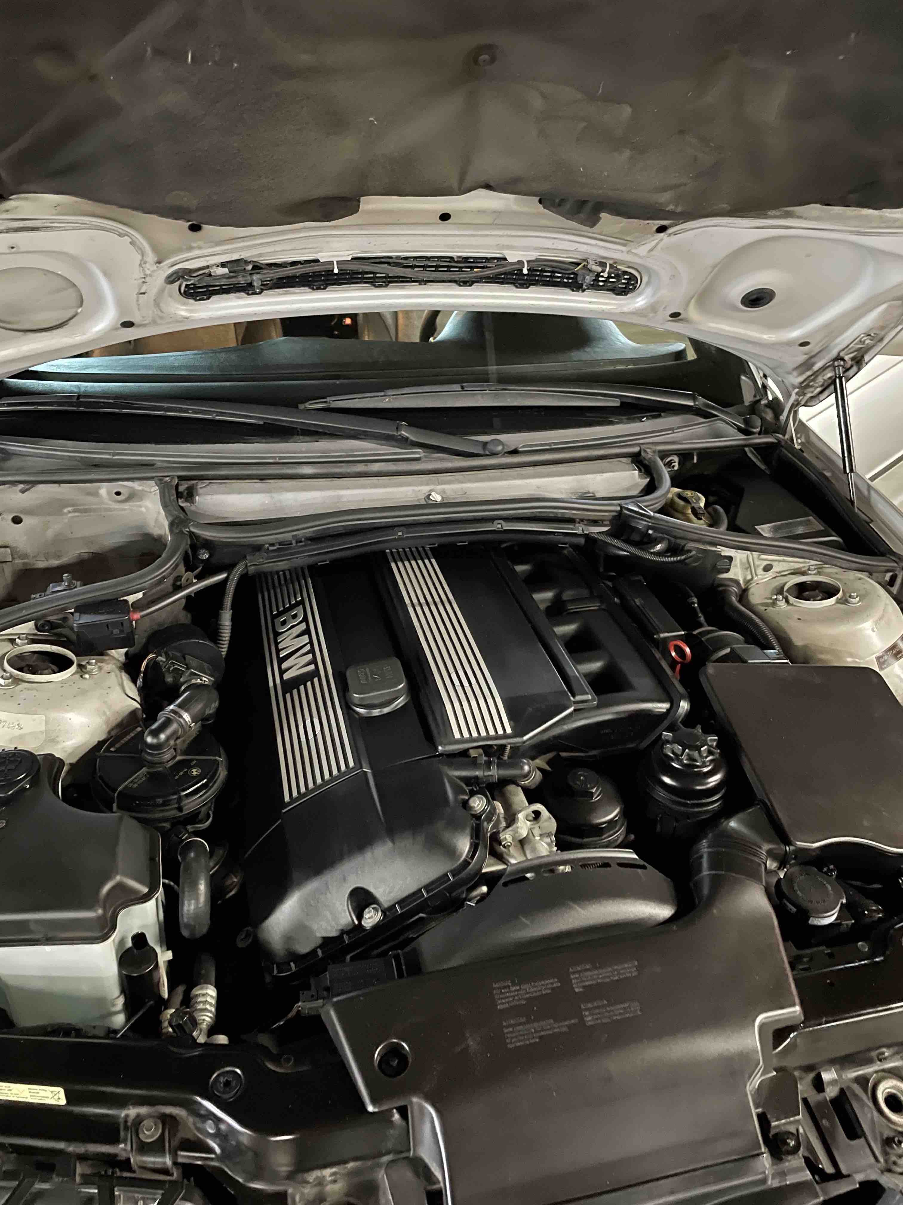

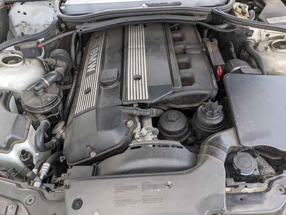

    Update on progress, Part I complete.
    Mechanical repairs done...
    Valve Cover Gasket
    Oil Plan Gasket - Between these two gaskets , they had quite the oil mess to clean up.
    Transmission Gear Selector Shaft Seal
    Spark Plugs
    Engine Mounts
    Steering Rack Boots
    Steering Guibo - Drives like new, had so much play in wheel before thanks so much @fredo
    New Xenon bulbs for brightness
    Hood Shocks... it would just fall.
    ....$4100 later *cries*
    (thank goodness cooling system was done recently!)
    Next mechanically( 1-2 years... struts and shocks are in the plan as they are leaky and worn.)
    Before and After pics :-)
