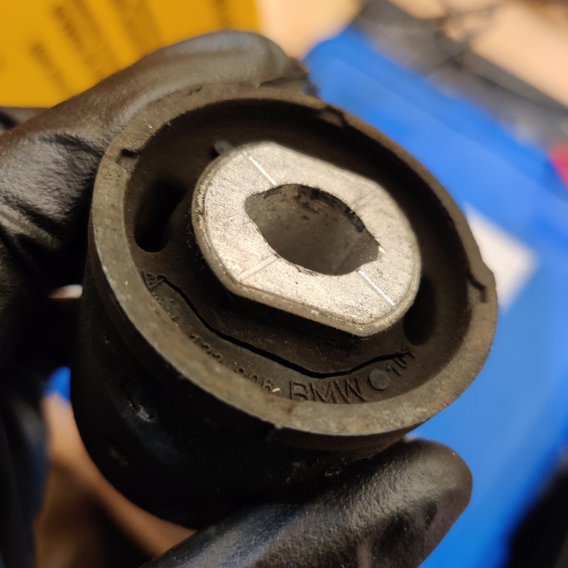

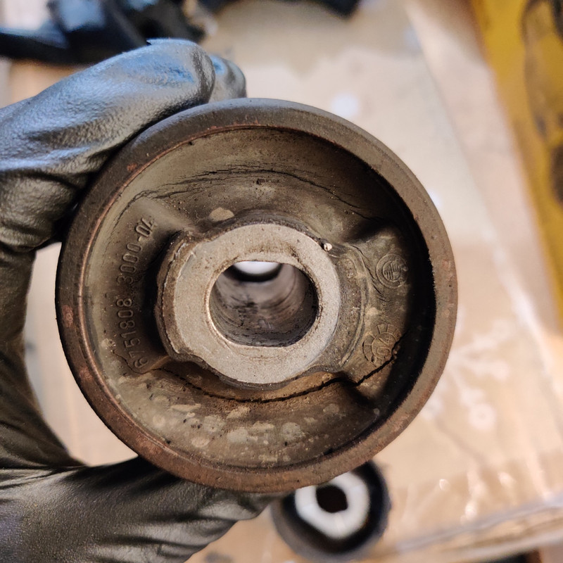

    -Both forward diff bushings have cracks
    -Rear diff mount has cracks
    -Very very slight oil weep at the differential inspection cover (noted by previous owner). No dripping on the floor yet. Just a wet look at the bottom of the differential
    At least I can probably knock all three out at the same time and reseal the diff as well. Not looking forward to dropping or lifting the diff back up

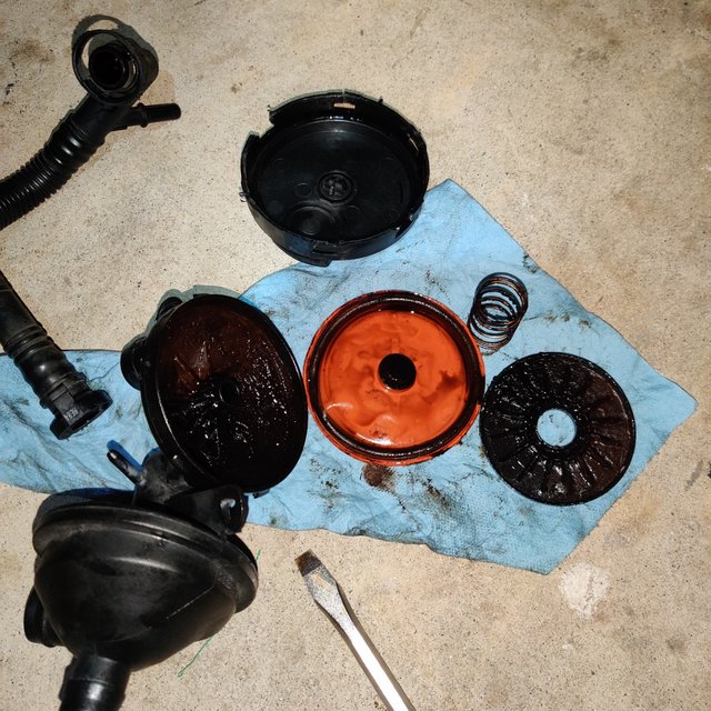

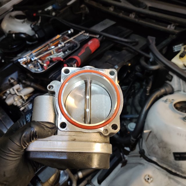

    CCV Replacement. During one of the test drives, i noticed oil weeping out some of the valve cover grommets. I had the same issue on my old wagon and believe the CCV has failed creating too much pressure and forcing oil out of areas that shouldn't? I haven't noticed any additional oil after cleaning but decided on replacing the CCV anyways. It was still the original unit so it had to go... Also bought a spare valve gasket set just in case (Previous owner had the gasket replaced along with a new cover) but hoping to save it for a VANOS reseal. I can feel the stutter at higher RPMs.
    Cleaned the ICV and TB while in there
    I was today years old when I learned that the cap can be used to hold the straw...I've been reusing the tape for years...

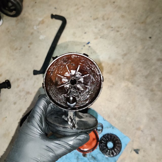

    Disassembled everything ahead of time on sunday while waiting for parts to arrive on monday. Decided to break open the old one to see what goes on in there. Assuming the diaphragm got stuck during one of my cooling system test drives (I did do a few short trips....)
    After replacing the CCV, not sure if it was my butt dyno but the throttle response feels like it's improved...? I don't have to give it as much input for 1st and 2nd. Could just be also not driving her for a few days lol.

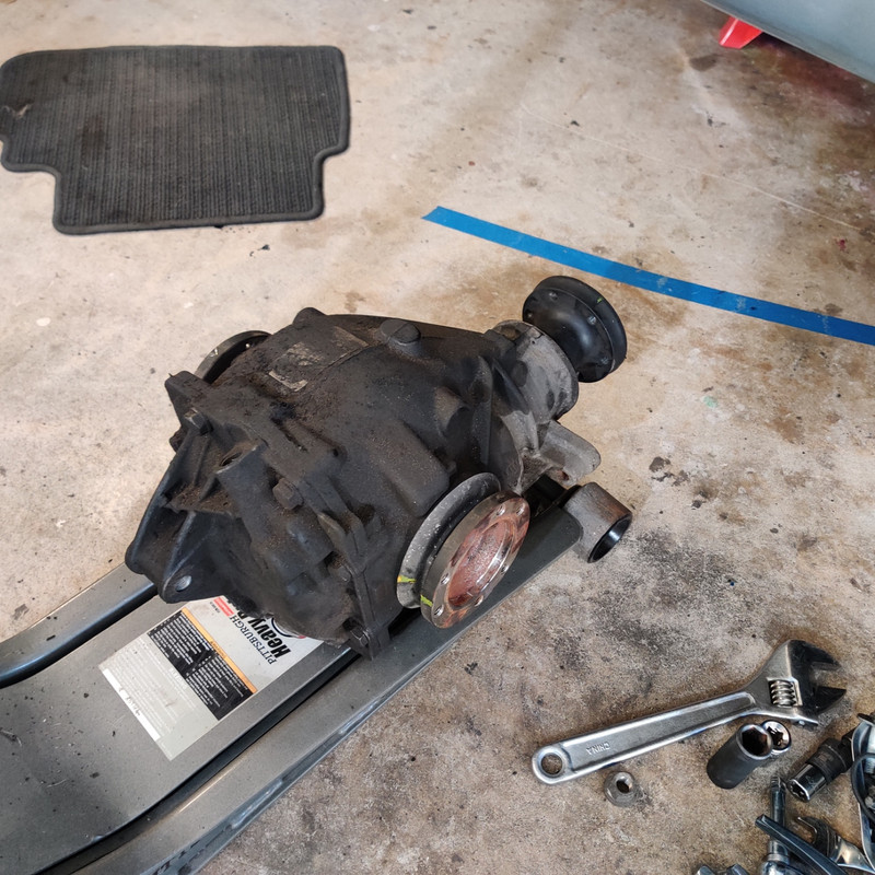

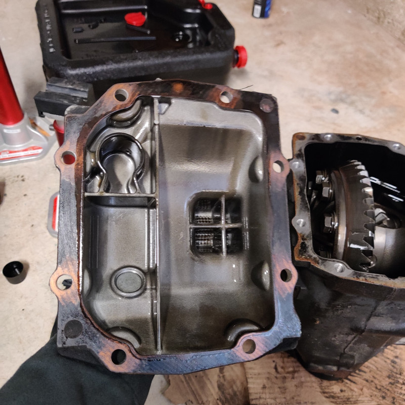

    Another small update! Dropped the pumpkin for Halloween!
    -Replaced the front and rear diff bushings/mount (cracks everywhere!)
    -Resealed the output shafts and the inspection cover since diff was already out and not expensive to reseal. Didn't have the right socket to remove the input shaft so left it alone since there was no leaks
    -Replaced the transmission mounts
    Reading threads online made the job seem a lot harder than it actually was. Everything came out smooth and went back in smooth. Hardest part was just bringing down and lifting the rear diff back up. Car drives a lot more smoother now and the rear end clunk has disappeared! Getting closer to finishing up maintenance to a level comfortable for me and hopefully move on to more fun things.
    The near 20 year old paper gasket was frustrating to remove...thank god they aren't made anymore.
