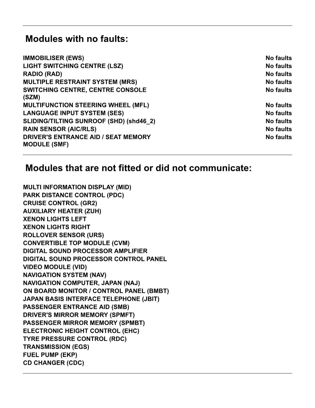

    I had a PPI done on a car yesterday and need some quick help interpreting the results. I know there is a lot of deferred maintenance, that was not unexpected.
    The tech's notes stated the following:
    "THE CAR HAS A VERY ODD PEDAL FEEL AS THE CAR WILL ACCEL AND DECEL WHILE MAINTAIN
    CONSTANT THROTTLE PRESSURE"
    Any ideas?
    The pics below are the codes that came up in a scan. Anything of concern?

    Hi WiINJ, and welcome to the Mafia! First post and already some trouble!
    I am no help at all and my feeble knowledge about the codes doesn't compute with the symptoms described as changes in RMP with a constant throttle input.
    No communication with fuel pump seems very weird.
    Hopefully more knowledgeable folks will chime in.

    Eh, I wouldn't worry about all the faults reported, these cars like to report every little thing that may or may not matter (for example, AUC fault could mean the little filter in the housing on the fan shroud went bad so it won't auto recirc/vent properly - but that doesn't really matter). I'd only be concerned if any of the dash lights were on, CEL codes, or if something was apparently wrong (for example, wonky HVAC blowing as a result of FSR).
    As for the tech's note, I wonder if there's a vacuum leak. Did you get a chance to drive the car yourself, did it reflect what the tech said?
    I'd also like to add, maybe you just didn't mention it but I'm surprised the tech didn't note down any leaks which are plenty common in these cars, along with bad suspension bushings. Might be hard to discern age of cooling system components unless you can see any dates on visible labels
