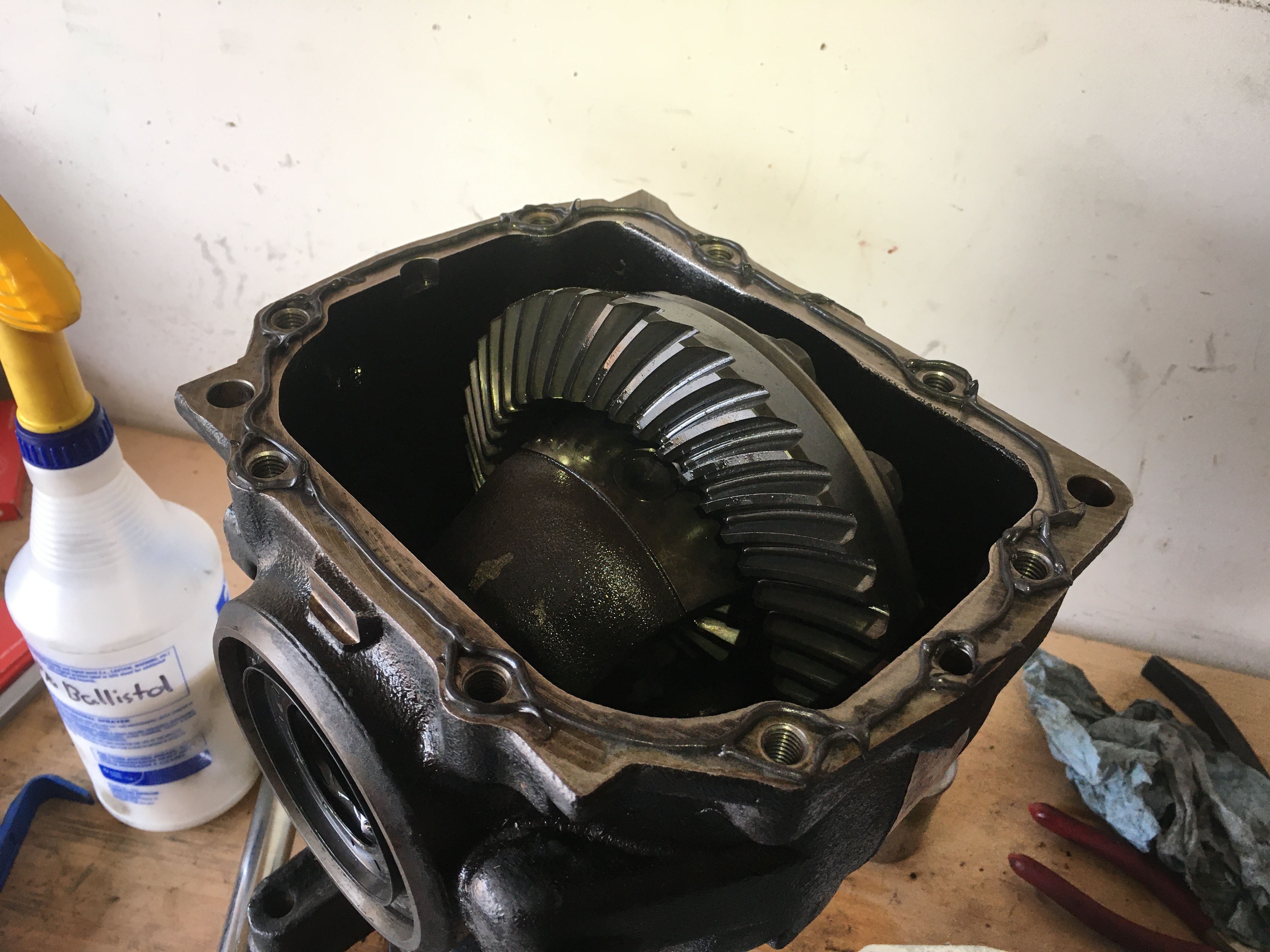

    Got the diff apart, cleaned, gasket maker put on, diff cover bolts torqued to 33 ft. lbs. Now it's sitting, I'm having a lunch break, and then I'll do the output shaft seals (properly this time). Hopefully I can get the diff back in the car today and either refill it tonight or tomorrow morning.

    The old gasket was definitely shot and leaking.
